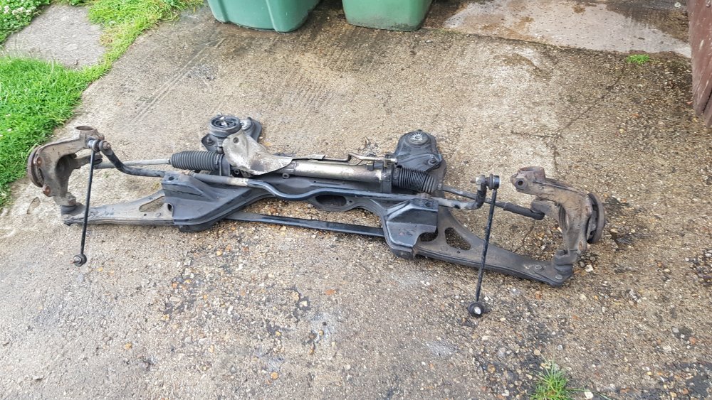

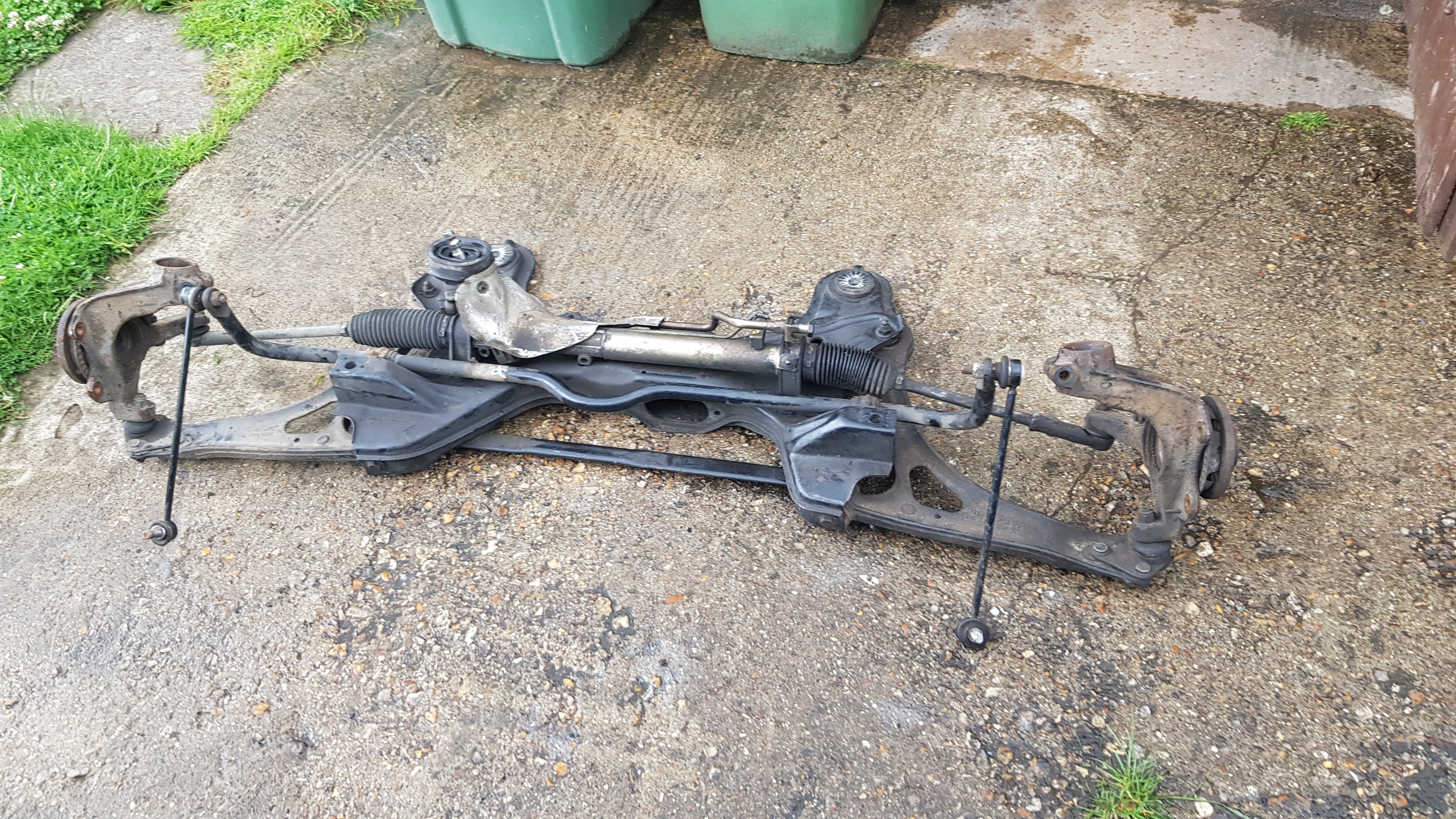

Full Leon Cupra R/Audi TT front end setup is a direct bolt on upgrade and gives a much better feel up front. You get cast wishbones and hubs along with a 2.5 turns quick rack. Decent, ready to go second hand stuff with a subframe can be had for around £150 - £200.
