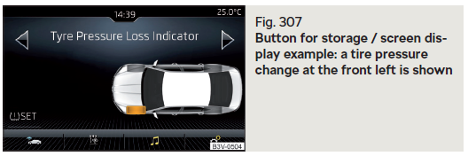

There is no mention of it in the brochure either from what I understand, with only the following being noteworthy (IMO) :
