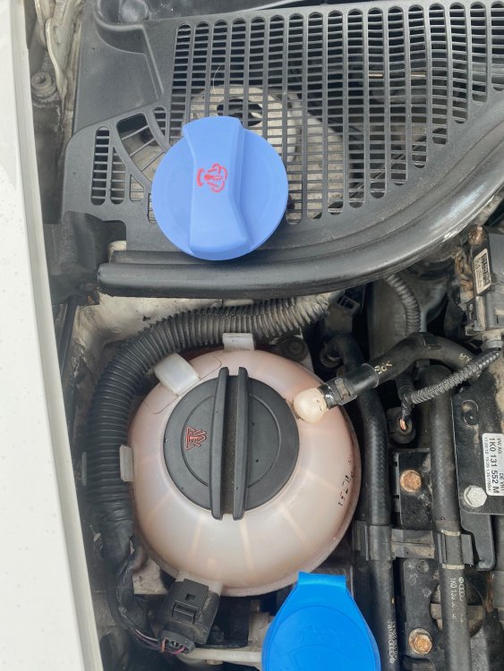

which is the right radiator cap?!
mk2 vrs on a 62 plate @140k
recently had the HG replaced as was blowing cold air when warm, bubbles in the radiator and failed sniffer test. etc. cars running great now, apart from it loses a little bit of water every 1000 miles or so.
thought it might be the radiator cap as no puddles on the floor or anything. so ordered the blue one from europarts and fitted it yesterday after getting in from work. so parked up the car, topped up to max with G12+ and left over night. came out this morn to find the reservior empty and a pool on the floor!
its never leaked like that before and cant see where its coming from? filled it back up, switched back to the black cap and drove for 20 minutes and no leaks now?!
confused! thanks in advance
The black cap looks more like the genuine design.  Is that the original?   The other thing to check, apart from the usual hoses, if it is still leaving puddles is the actual reservoir starts to get cracks in it and can start to leak with age.

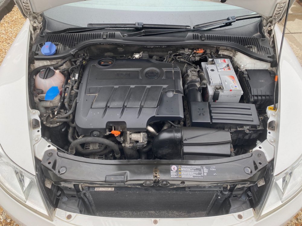

Photo of mine.
Mine looks like the blue slot above on a 60 plate.

it seems to be when i replace the coolant cap with the blue one it leaks more. it shouldnt do and unless i saw the pufddle under the car when i do i wouldnt believe it myself.
i assume theres a small leak from a pipe and when the new blue cap seals the system better than the balck cap and creates more pressure it leaks more.

the car is a 62 plate vrs - plate YP62 NTU. it had a new head gasket, belt and pump done in march 2020
id be more inclined to think the new cap isnt sealing properly, allowing air into the header which in turn is lettimg the coolant out of whereever the leak is. the older cap is a proper seal, and is holding a vacuum on the system to stop the leak.
