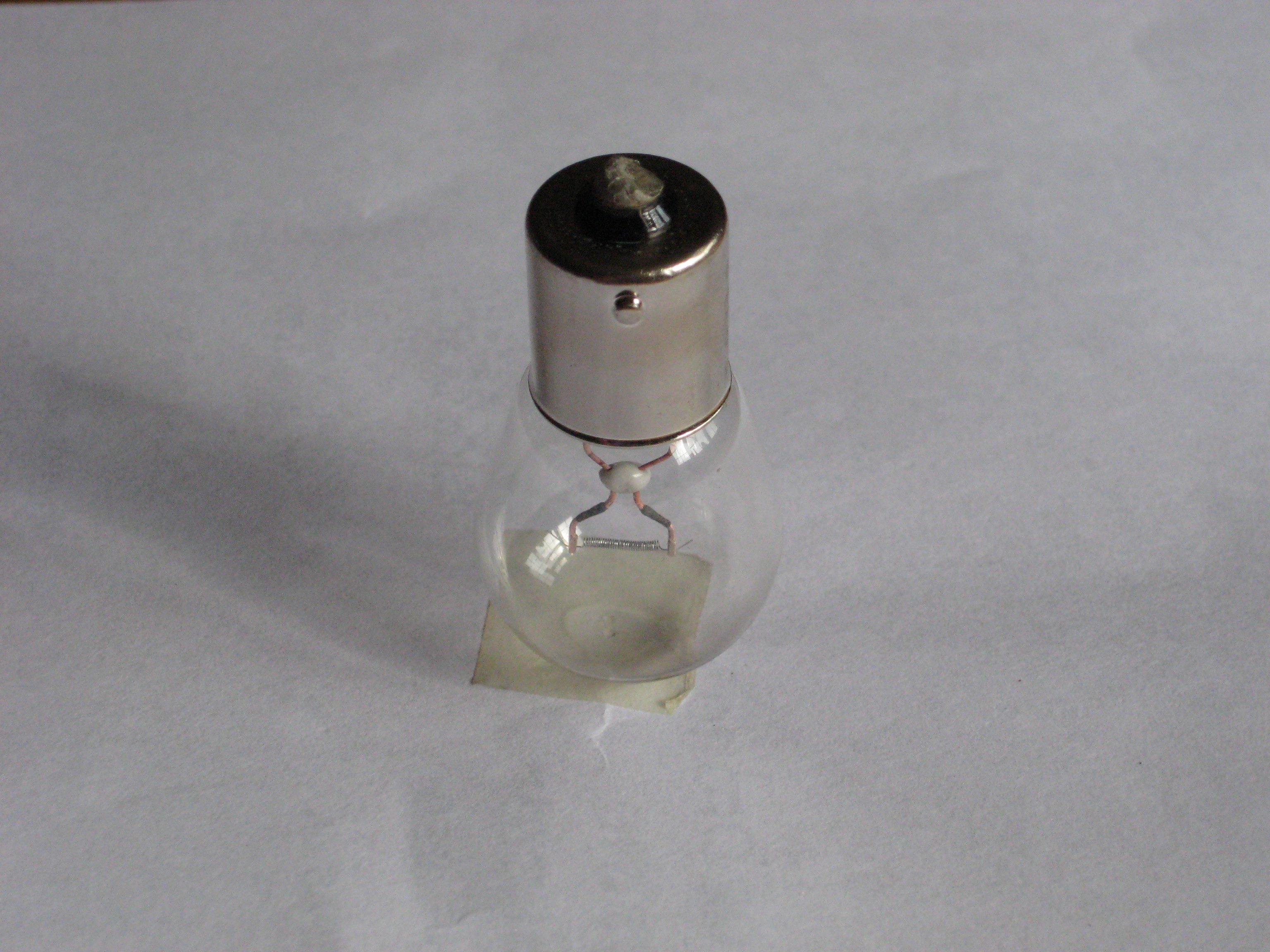

I have had a lot of experience with intermittent DRL. With the vibration, the centre contact of the bulb (which is made of solder) is fretted away until the spring contact no longer touches. The fix is to use a soldering iron to build up the centre contact of the bulb to as new.
The picture below shows how the centre contact was worn away until it no longer touched the other sprung contact.
If you replace the bulb, then make sure it is a PY21W as these have a thicker filament to avoid vibration failure of the filament.

Thanks pikpilot, I think this is the issue, the lamp pin.
The spring contact needs cleaning either as it is not clean too.
