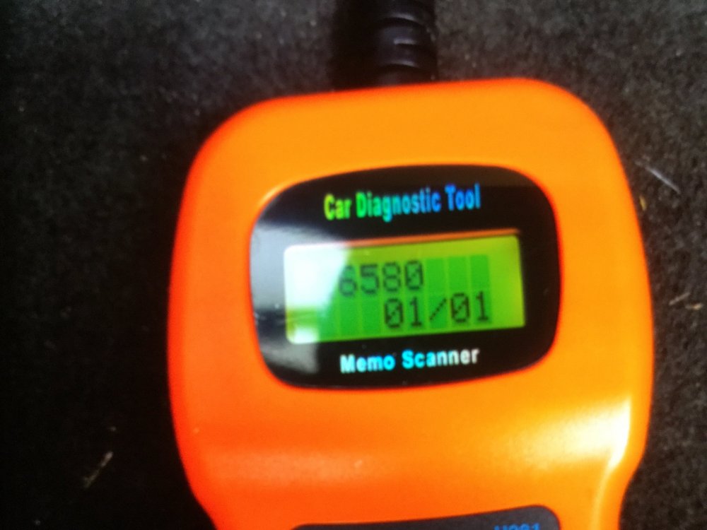

Anyone know what 16580 code is for my octavia please.

Oil temperature sensor fault, judging by a quick bit of googlage.
Check wiring adjacent to the connector on the sump.
