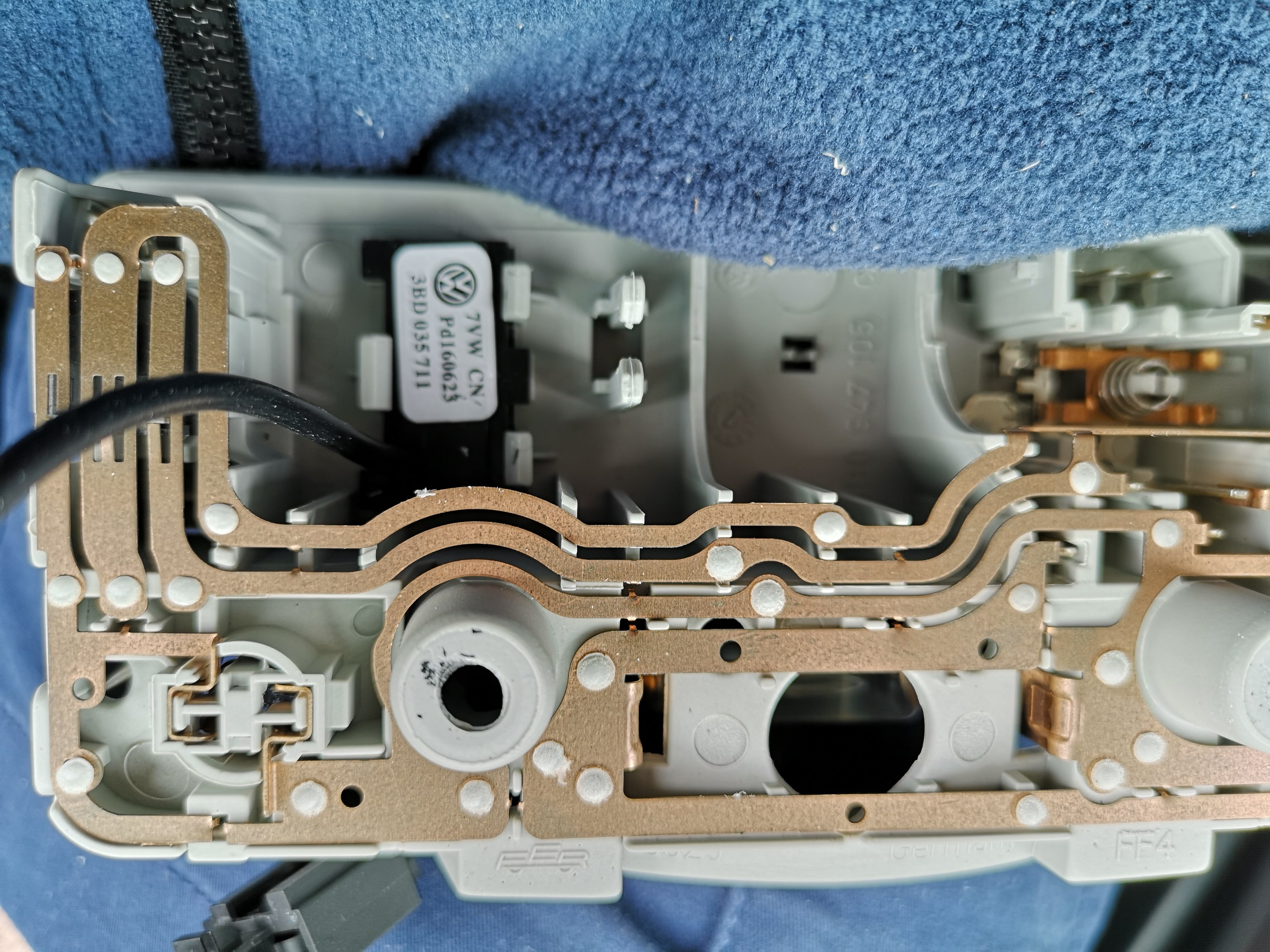

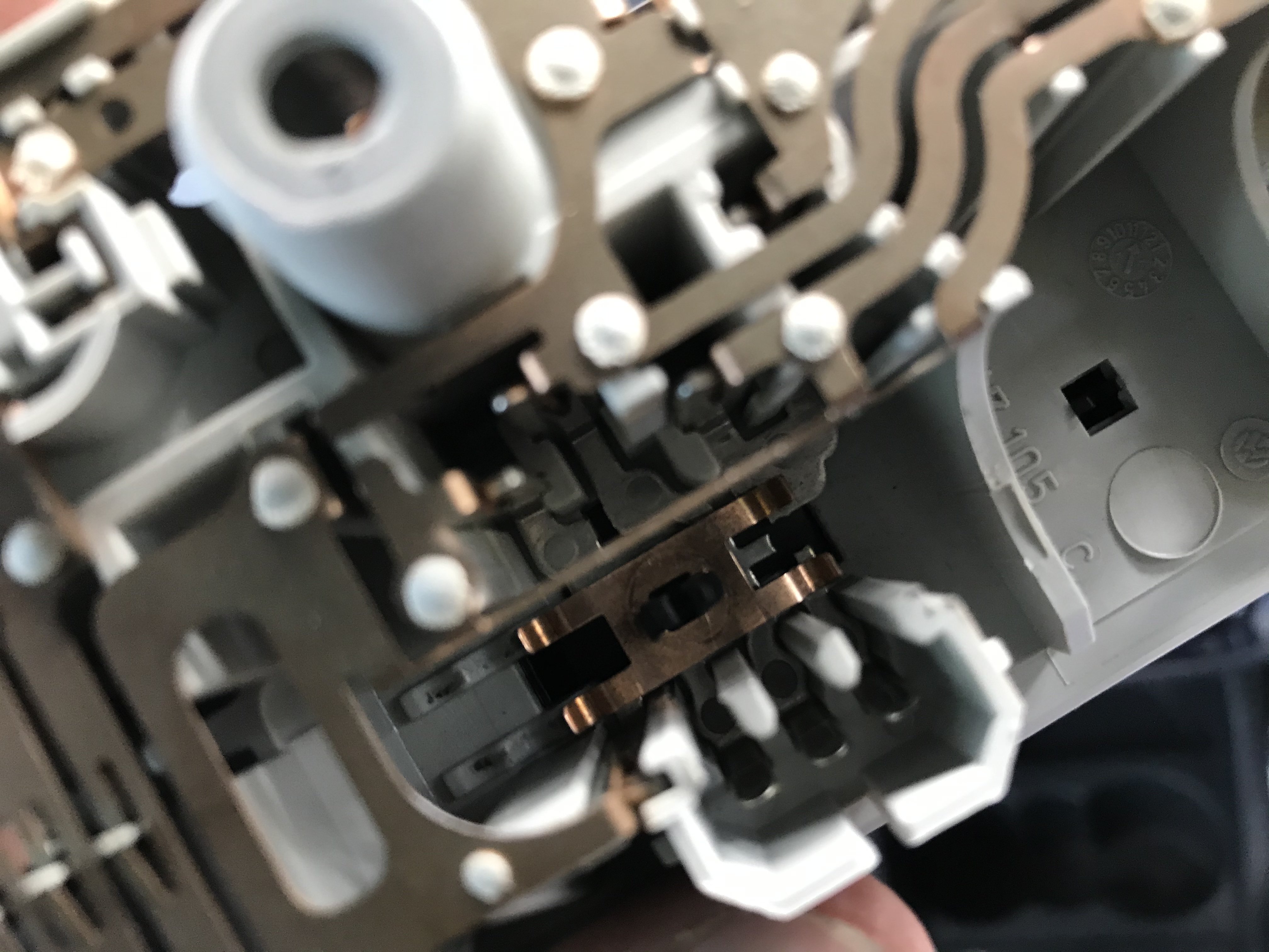

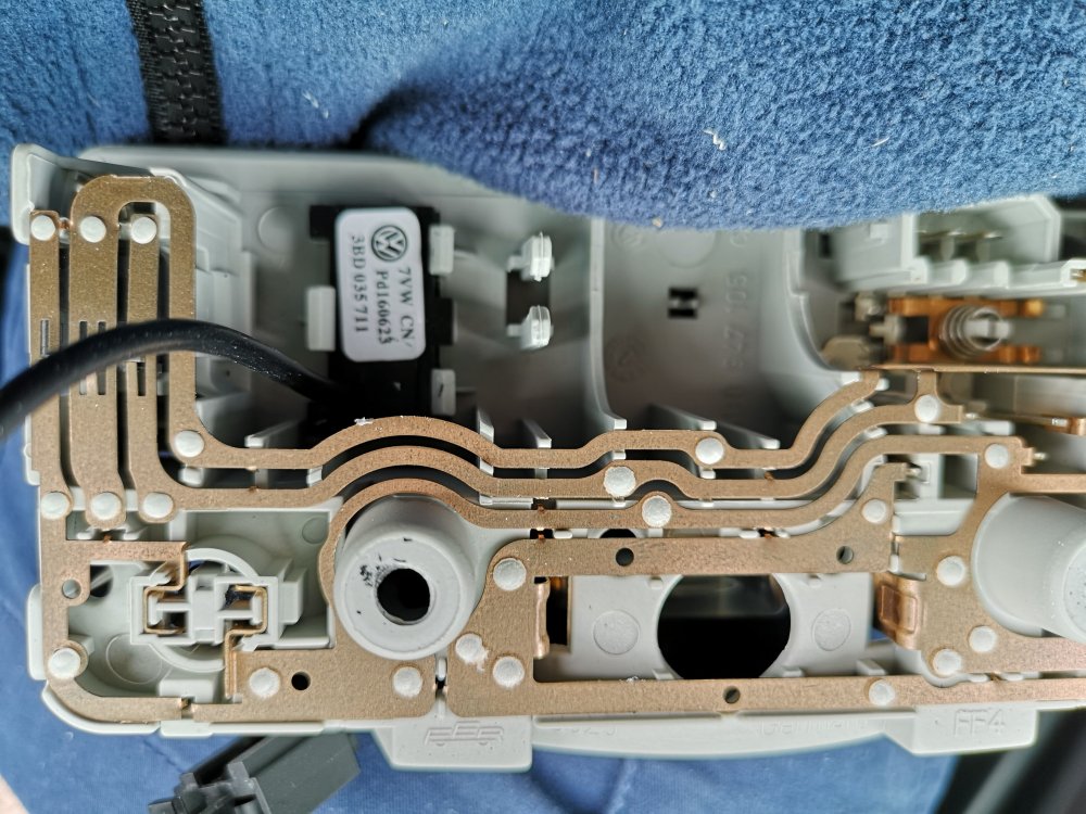

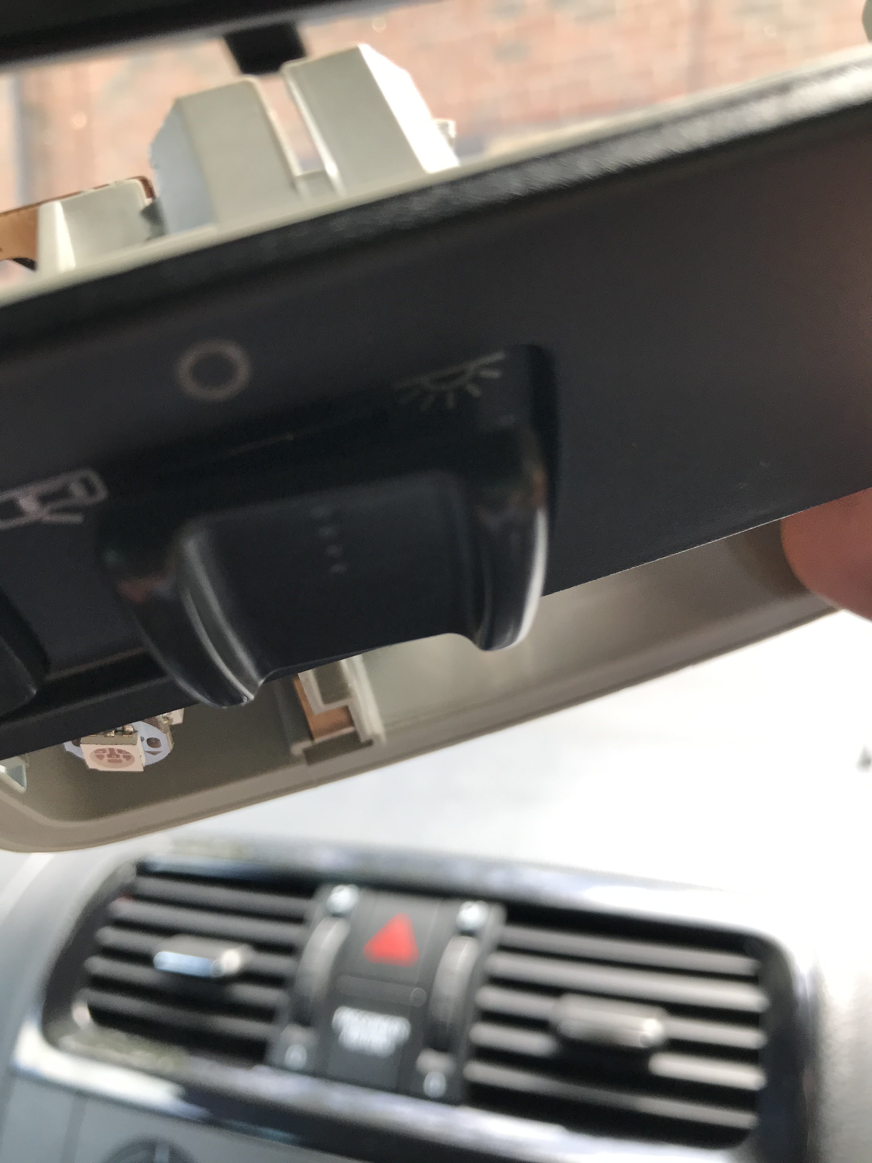

As per description.  Fitting a hands free microphone I’ve been a bit rough removing the light and the slider for the interior light has gone somewhat floppy (oh my)....I can’t see any additional bits on the floor and can’t don’t seem to be able to figure out what I’ve done.  Any ideas folks?
(I will add that I may have replaced that brass piece upside down, I’m not sure which way it goes)

You've almost got it back together right in your pics, but there's a little spring missing. You can just about see it on the side of this pic from my install:
Aha, I'll have a hunt around in the car for it....if I find it, I'll bung my light (or the replacement when it arrives) on eBay lol.
