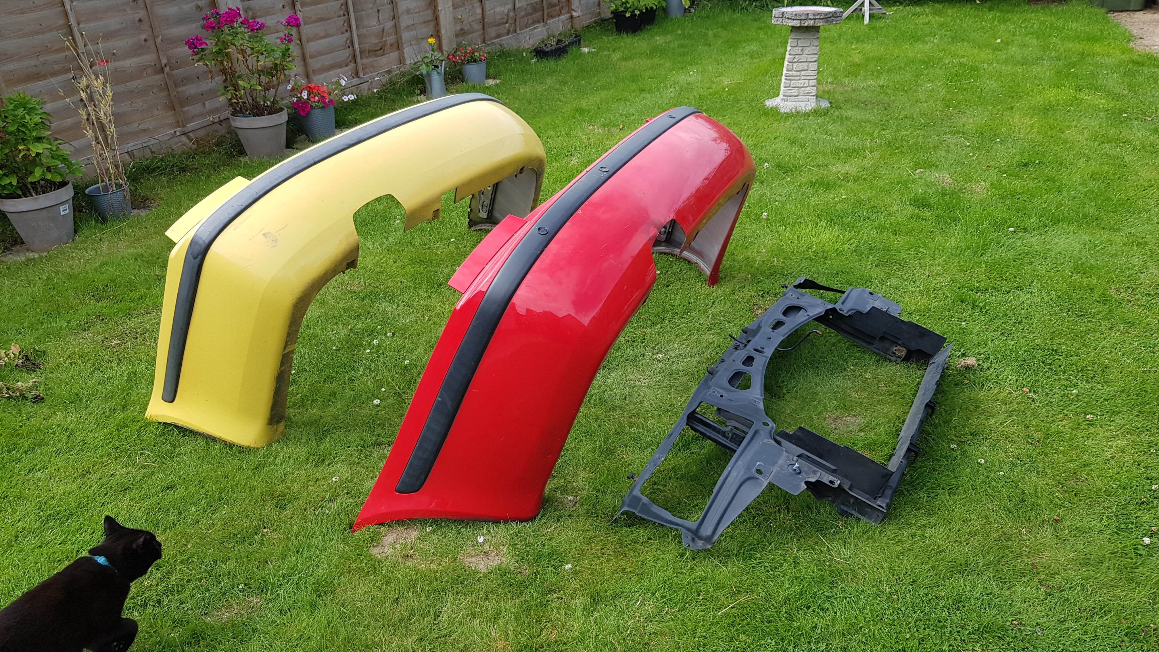

Incorrect. The VRS rear bumpers have cut outs for the exhaust whereas the non vrs bumpers do not. There's currently 2 vrs rear bumpers taking up space in my garden.
