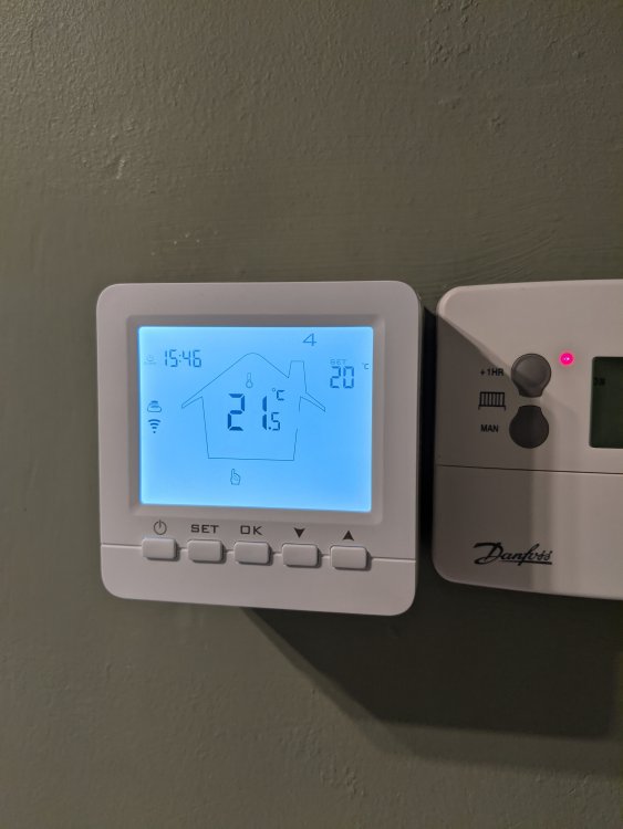

1 hour ago, cheezemonkhai said:
Does anyone know of a single package inline mains powered (not a plug),  live switching thermostat, which has wifi programmable times?
Not fussed about the fancy geolocation etc.
Check my post earlier on. That should be what you need I think.

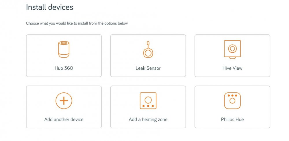

Well I finally got Hive installed on Friday - we’re getting fitted wardrobes installed and the fitters had asked for the programmer to be moved.
I mentioned to the plumbers that I was thinking of getting smart heating fitted and they said that they could fit a Hive system (compatible with Apple HomeKit) for just the cost of the kit, as the labour cost was the same as moving our existing programmer.
so far really pleased with it - after an initial call to Hive support as I couldn’t get the app to see the thermostat, even though it was working perfectly on as a normal non-app-controlled programmer, Hive dialled into it, ran through a few reset procedures with me and it was up and running with HomeKit!
The programmer’s been installed where the old thermostat was, and as per @Lady Elanore’s setup, the hub and receiver are installed by the router.
The cupboard’s a bit of a mess, as I still need to tidy up from where the power and data was run to the garage…I must have known more work was going to be done, hence not getting on to that sooner…at least that’s what I’m telling myself!
I like it so far, and it’s nice to be able to set different temperatures throughout the day…it’s certainly a lot easier to program via the phone than the tiny screen on the old programmer!
Thanks to all of you that gave advice on this topic 👍
