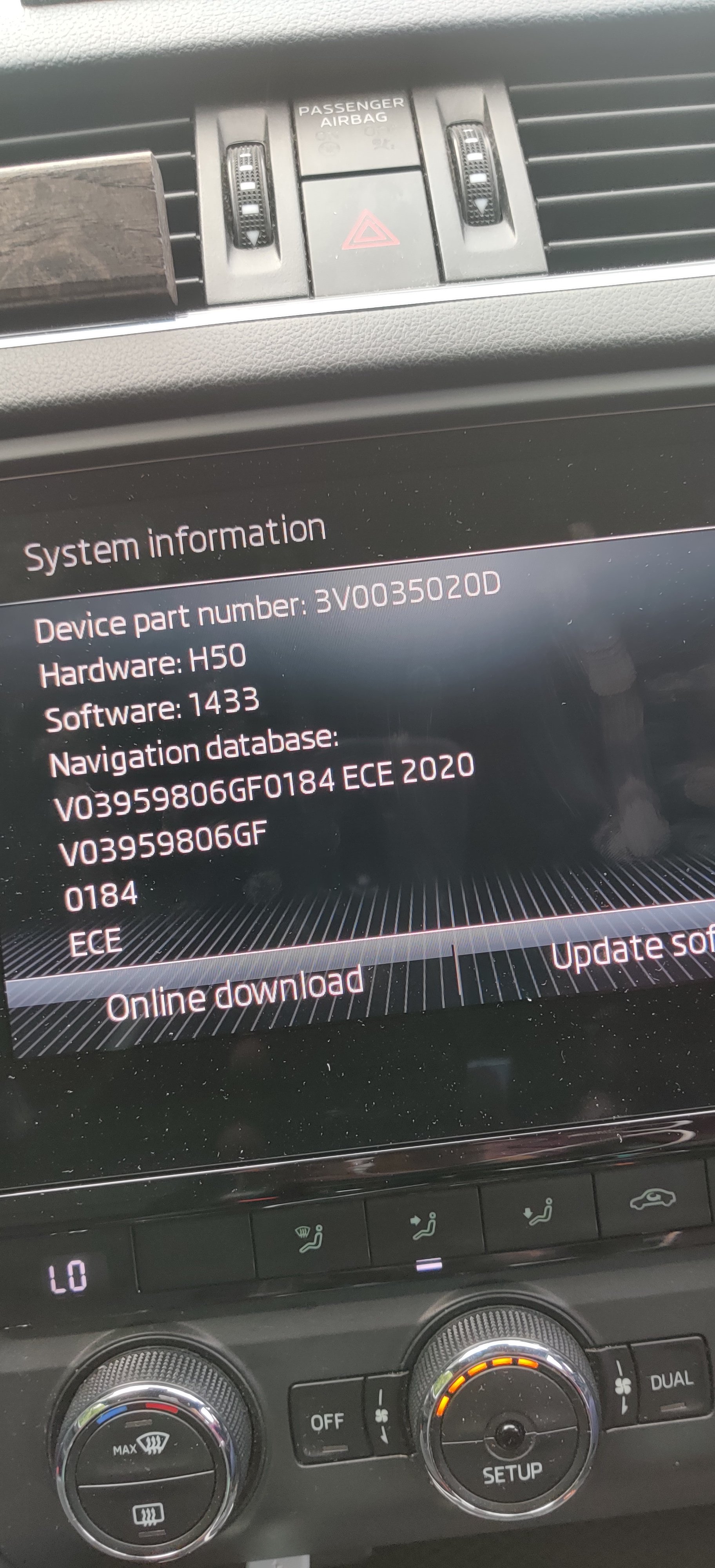

How do I find out if its Amundsen or Columbus? And how do I know if its MIB1 or MIB2?
Here's a pic of what I've got:

doing a search of your part number shows you've a MIB2 Skoda Amundsen

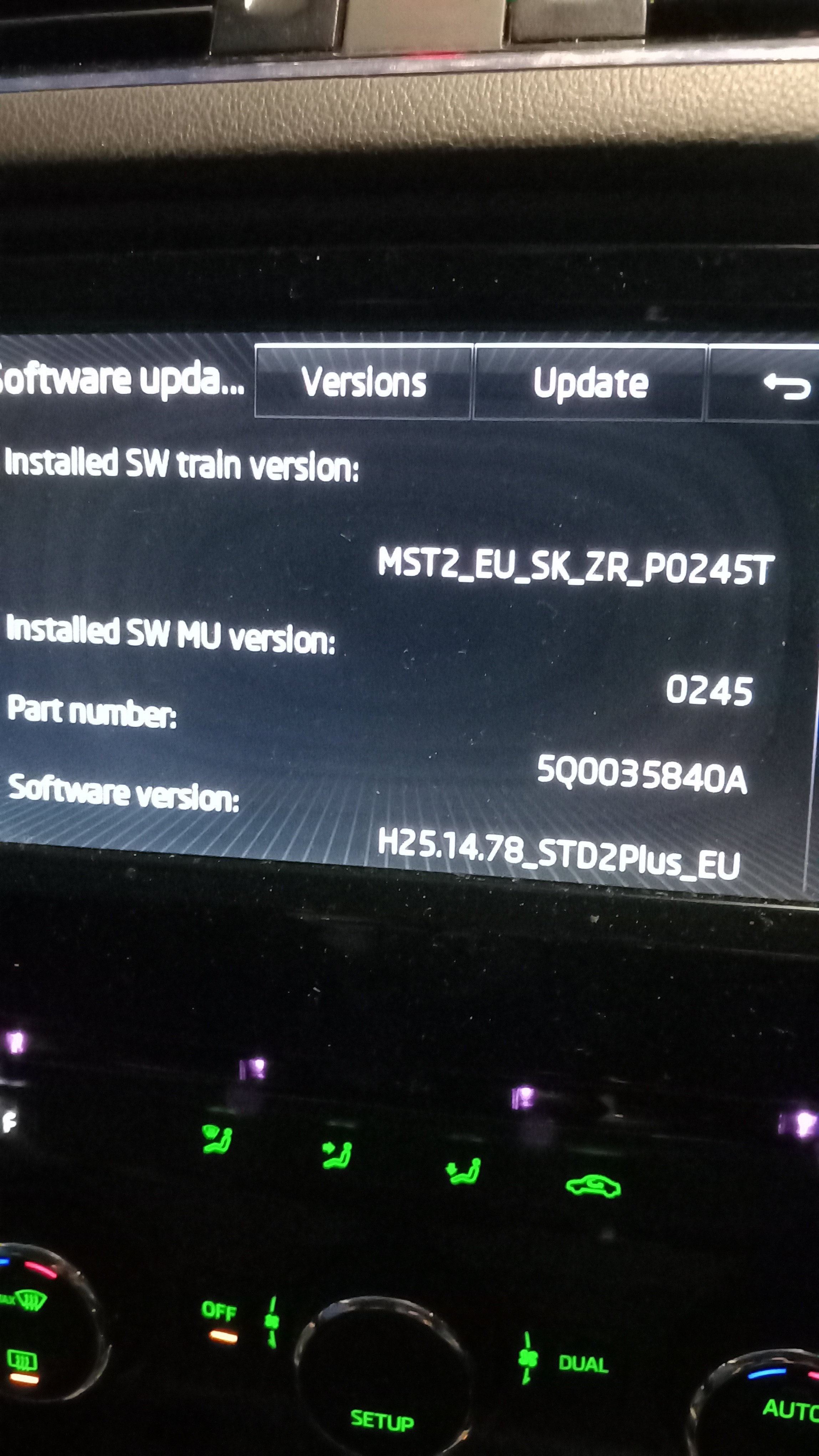

Hi,
I'm thinking I need to update the software on my Octavia Mk3 (late 2015) infotainment system - I believe the below is required:
5Q0 035 874A - MIB2 Skoda Amundsen
Installed SW train version: MST2_EU_SK_ZR_P0245T
Installed SW MU Version: 0245
Software version: H25.14.78_STD2Nav_EU
Much appreciated if you can tell me how to get the update and how to load it please.
Many thanks.
@moldaguus there is no SD card solution for your unit - it works ONLY for OEM sat nav units (Amundsen) and you have non-nav unit (Bolero) which requires soldering. If you are interested pls let me know - although I must have it on my bench in Poland.
@Gleni69 I sent a download link to 0253 in PM.
1. format SD (best max 32GB) under FAT32
2. unpack to root (metainfo2.txt and all the folders must be placed directly on SD, not in any folder)
3. insert SD card into the slot
4. enter Service Menu (long press MENU button)
Thanks @pab567 the update worked eventually, but maybe a tip for the benefit of other newbies. It kept failing to start with and this was because I was getting to the update button via Settings and then scrolling down to system information and clicking the update button from there - this then brings up an error reading the card. Whereas, if you follow the advice (trust me to find a different approach that doesn't work) to just hold in the menu button for a few seconds and then go to update from there it works!
