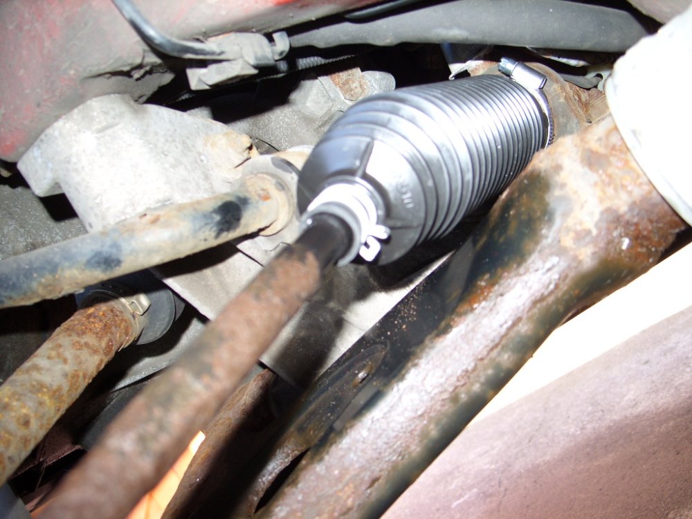

Ouch, I'm guessing it's the rack itself leaking into the gaiters, give the gaiters a squeeze, if they're squelchy then you have your answer.
They usually leak into the passenger side rack gaiter from the end seal.

The outer clips are usually just the spring type that you squeeze with a pair pliers to release. Just release it and give the gaiter a squeeze to see if there's fluid inisde it. The inner clips are crimped on. I had to use jubilee clips on mine as there is no room to get the appropriate tool in.

I managed to squeeze the gaiters and both did not feel squelchy, I did undo the end of both, squeezed and nothing came out.

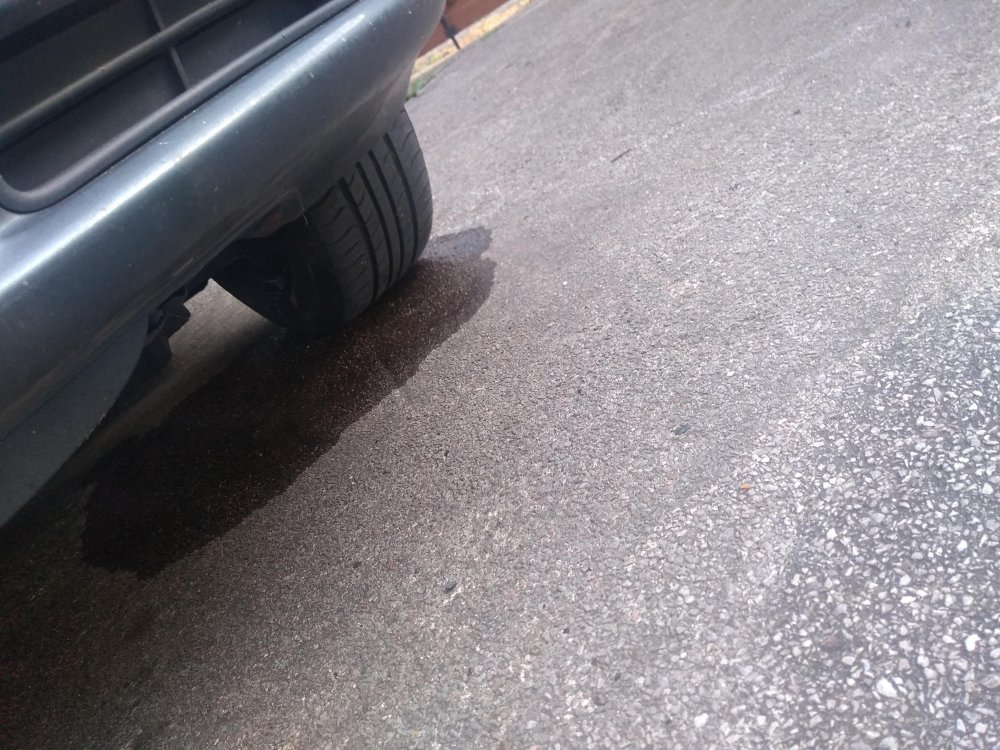

Been away for the weekend and I have come home to a patch under the passenger side front wheel, and it's not oil. The steering fluid had dropped a bit, but I would have though it would have dropped more given how much there is under the wheel.
I have bought some Lucas Oil Power Steering Stop Leak, which I think I will try tomorrow and see what that does, but not looking to good.
Martin
Are you sure it's steering fluid and not screen wash? I wouldn't expect it to leak much when the car is just idle. If it is steering fluid it might be leaking out of the pump/reservoir rather than the rack as the patch looks too far forward to be the rack.

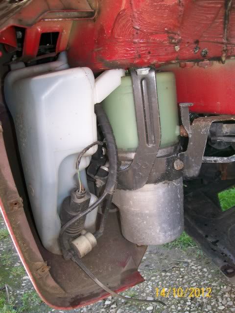

Screeen wash tank/pump is right next to the steering pump. Remove the T25 Torx screws in the wheel arch liner to inspect both items.
100-1124-zpsfa613492-jpg-fca6fa3127821c3
Edited by TMB
Thanks for the photo Lee, I have just been out again and rubbed my fingers through it and it has and oily consistency, but  not engine oil. it sound silly, but the only way I can describe it is that it feels like bear oil, if that makes sense, so I assume it must be power steering fluid, but there seems to be a lot of it.
I have not had a proper look yet, looks like I need to take the wheel off and the under wing cover and have a good look, I wonder if a pipe had corroded or something similar, I can still see power steering fluid in the reservoir though.
The photo really helps though.
Martin
No problem. I suspect it's coming from that area rather than the rack.
