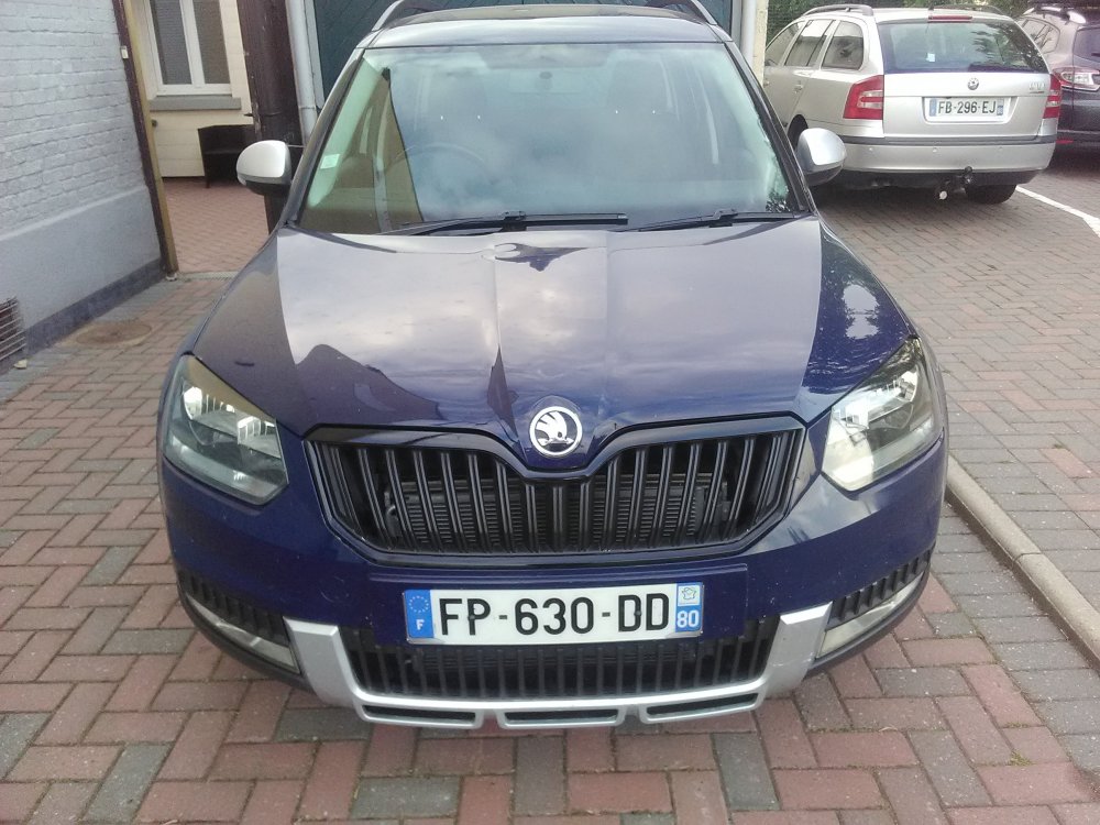

I have just done the same to the chrome grille surround on my facelift Yeti.
The surround was damaged in the accident but too expensive to replace as all that was visible was a fairly clean break and a small amount of chrome lifted around it, after seeing your pictures I decided it would look better in black, the chrome does not go with anything else except the bonnet badge which was also damaged.
By painting it black I was able to do a decent repair that is invisible to Stevie Wonder & Ray Charles, I sanded, used plastic primer (probably totally wrong) satin black followed by 2K clear coat because I needed a resistant finish knowing it was going to take a lot of hand pressure to fit the inner grill to it after the repairs and to refit the whole assembly into the slightly damaged bumper.
The now gloss black around the matt black inner grill actually looks really good and fitted it is much much better looking than the chrome surround and really goes well with the silver "Outdoor" bumper lower insert.
I have ordered a matt black bonnet badge to complement the job.
The price for a new chrome grille surround was silly money but the price for the black Monté Carlo version is insane!

Will upload a photo later, the primer used is more important than the finish paint, nothing will really adhere to the chrome even when its sanded, etch primer might have a chance, I dont think the plastic primer I used did anything but its all that I had.
The satin black was chipping from just the gentle handling moving it around to spray all the recesses, it would not have lasted 5 minutes on the vehicle, it now has a tough 2K clear coat protecting it which is the best that I can do.
Photo as promised:
Does that front end look like its had such a hard frontal impact as to set off 3 airbags and write the vehicle off?
The only thing that has been replaced is the grille inner as a couple of the plastic slats had broken off.
The bumper has been polished, no paint repairs, the silver part is as was, just a scratch visible.
Grille outer surround had a crack on the RH side which is still visible in the photo after the repair.
The bonnet badge is cracked & the nose of the bonnet will benefit from a little more persuading forward after the badge is removed before the new one fitted.
The inner bumper steel beam had in fact deformed & the longeron which is the initial sacrificial crumple zone had compressed, I got it 90% straight on my hydraulic press but it was better to fit a new one at £60 as all the panel gaps are set by it.
The plastic bumper and the polystyrene moulding behind it transferred enough force to deform the bumper iron crumple zone and set off the airbags yet both were re-used without any paint repair, Skoda really picked good materials.
