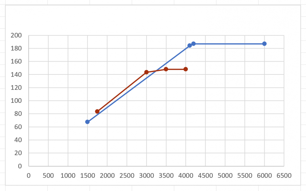

(I was just about to do comparison graphs for other Octavia engines for my own amusement.)
Here's a closer alternative for the 2.0 TDI 150PS (red), the 190PS TSI (blue).
Where the 190PS TSI seems like it's going to be way faster than the 150 TDI, for general tatting about, they are actually quite similar in power characteristics, until you get up into the revs where the petrol TSI can do its thing.
There are going to be a load of other factors, such as the pick-up of revs in response to the throttle, the gearing and probably a shed load of other things I'm too lazy to cover and likely don't have the expertise to know about, but purely comparing power at given RPM, in the lower rev range, the TDI has the edge at any given RPM for these two engines.
