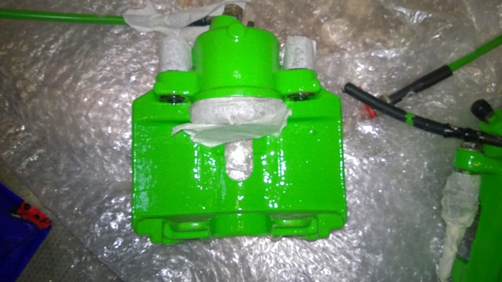

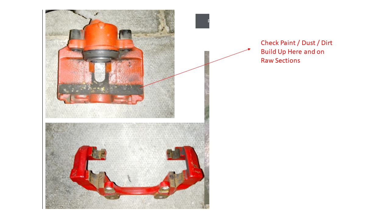

When i painted the second set maybe i shouldnt have painted the lower half (where the brake pad sits), and now i am thinking it is paint build up on the inside causing it to stick maybe shouldnt have painted it fully green on the inside? 88226032_RedBrakes.thumb.png.8724650ac60292ced32d72fd922acc71.png
