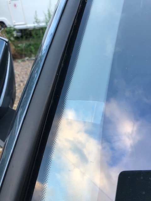

Just had my windscreen replaced after developing a massive crack.
There's two bits that I'm not sure about and hoped someone could compare against their vehicle.
a) is the black outside trim on the A pillar the same as the attached photo. Mine both have a channel now on the outside that looks suspiciously like it should have the outside edge of the window sitting in them.
b) is the ceiling liner loose. Mine has a sort of frayed edge by the dashcam and can be moved in and out quite a bit.

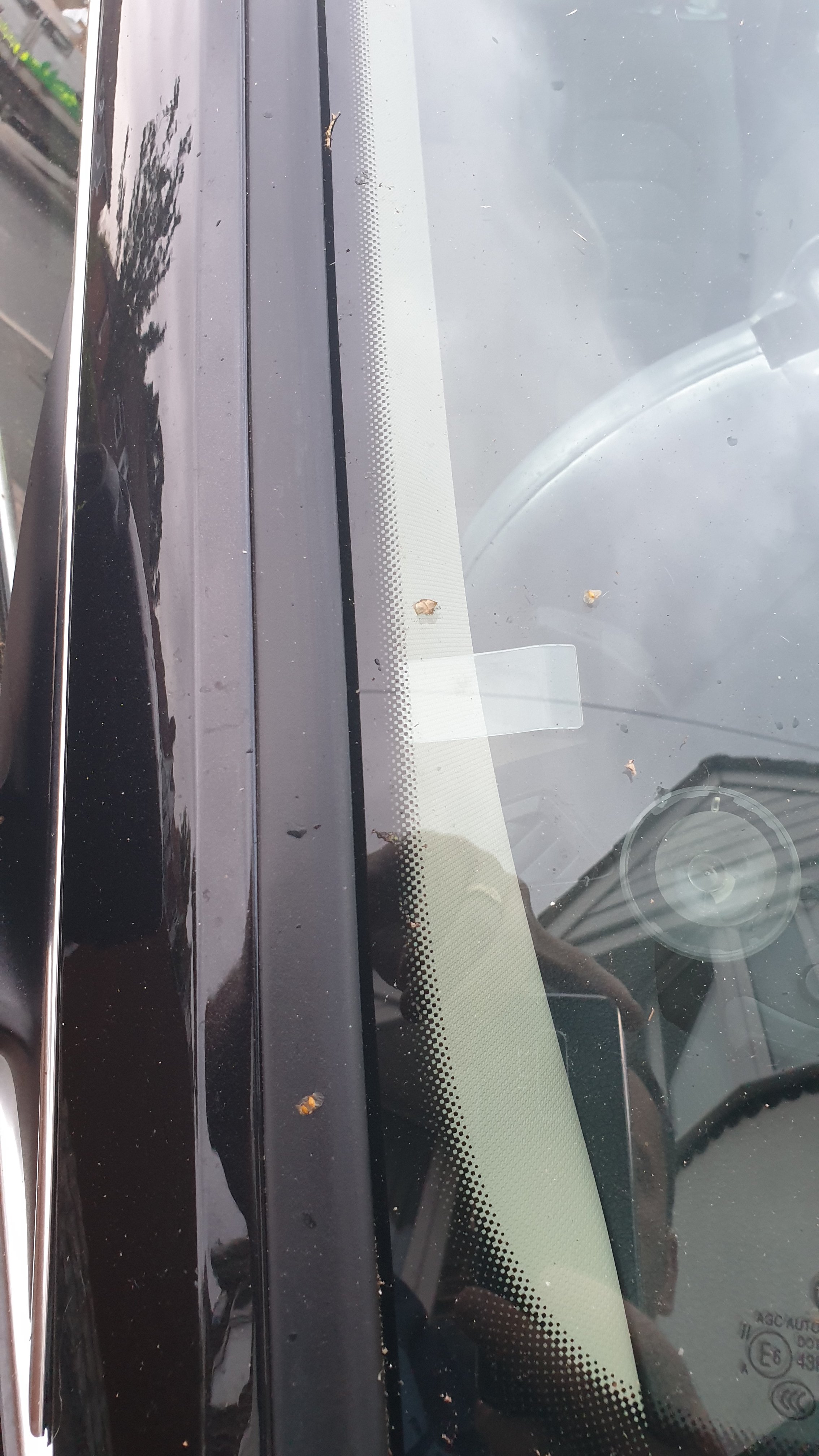

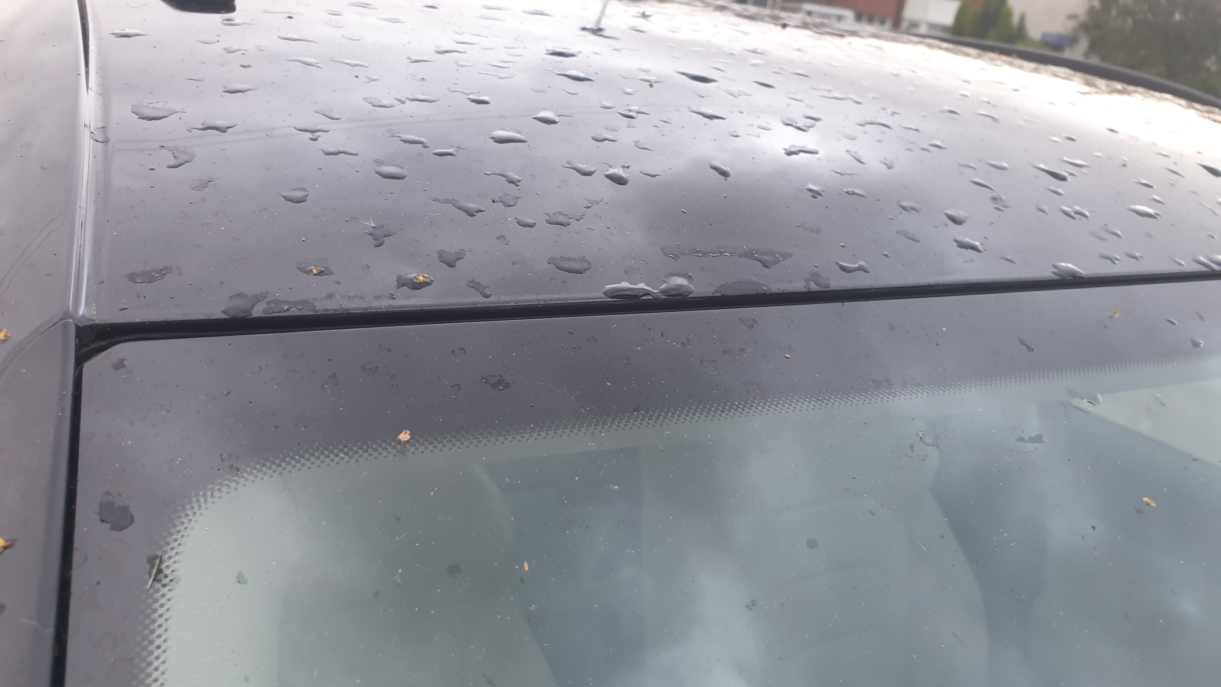

Here you go mate, hope u can get some comparison...?
Your windscreen is different, yours has less black around the outside edge, from what I can see hence you can see the finish on the A post

It looks like the A pillar seal flange is the wrong side of the glass . 😬
Similar angle on mine. It would seem correct comparing the two. However possibly not OEM glass, as stated above, the tinted edging is thinner. The liner edge can fray. Should not be loose.
