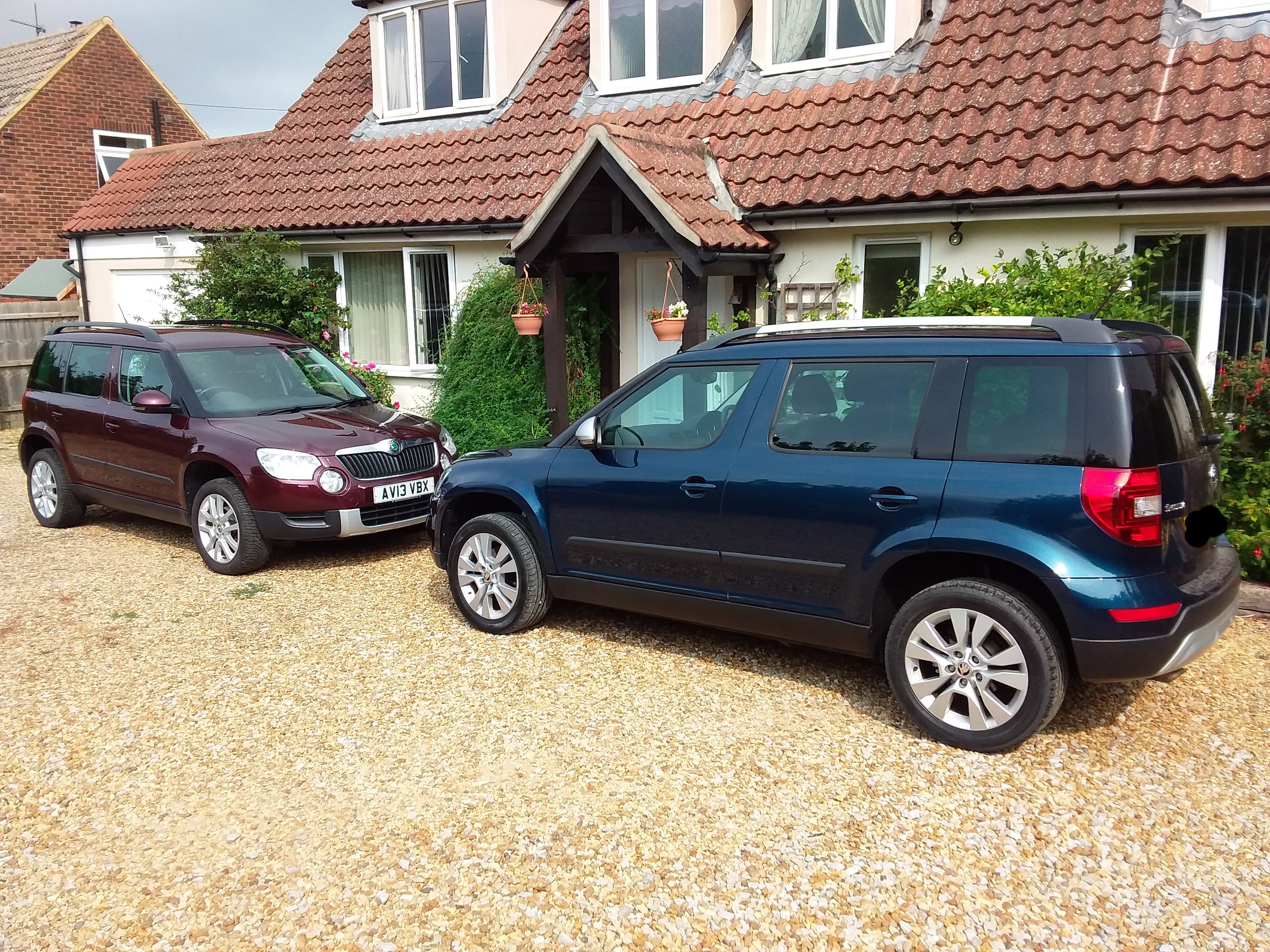

I'm glad it's not only me that notices oil temperature. My 2013 Yeti 1.2 Tsi ran at around 90 degrees once warmed up BUT my new 2017 Yeti 1.2 CYVB runs at 100 degrees.
