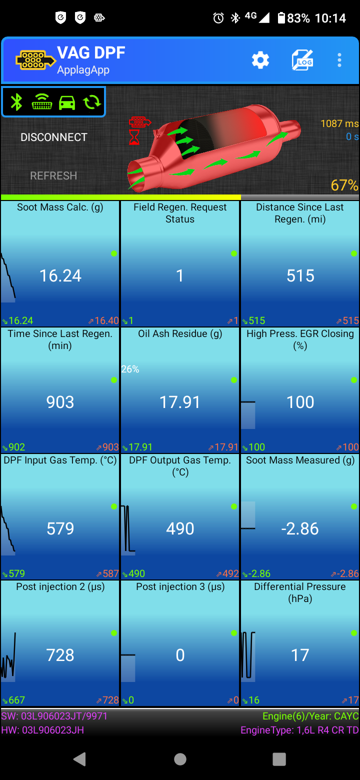

If you have an OBD11 reader and smartphone VAF DPF app gives you all information.
The screenshot here was with a cold engine, the DPF changes colour when it is regenerating.
^^This is what you need.^^
I have a sixth sense on when mine is near a regen and use VAG DPF to confirm it, If needed I just go for a drive until its finished.
If you need to force a regen there is another app called Carista that allows you to do that.

This is an old thread but just to show what VAG DPF shows during a DPF regeneration, also note that it's 515 miles since the last regeneration, I put that down mostly to using Archoil AR6900-D Max at 50ml per 50 litres of diesel at every fill.

What RPM was the differential pressure measured at?
1000 rpm raised tickover as I could only do that when I was parked.
I rev mine to the maximum 2.5K rpm while parked using VCDS, there is little or no pressure drop at 1kRPM but a significant amount at 2.5k, figures from the top of my head from a few days ago, 500kms since last regen, calculated soot load 13. something grammes, measured 3 or 4 grammes, differential pressure at 2.5K rpm about 38 whatevers, probably hectopascals.
17 at tickover looks very high to me but I would have to check my previous readings to be sure.
I recommend you do the test at the standstill rev limit.
