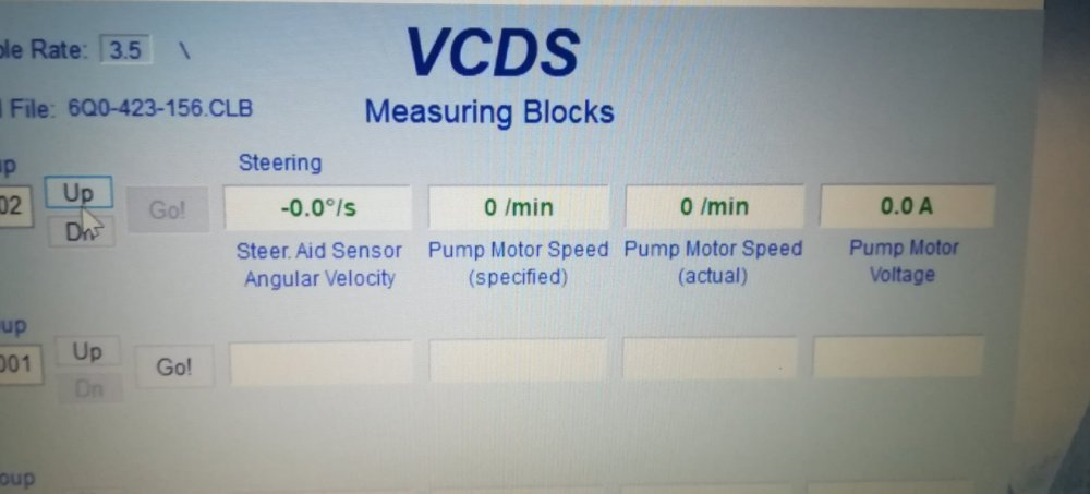

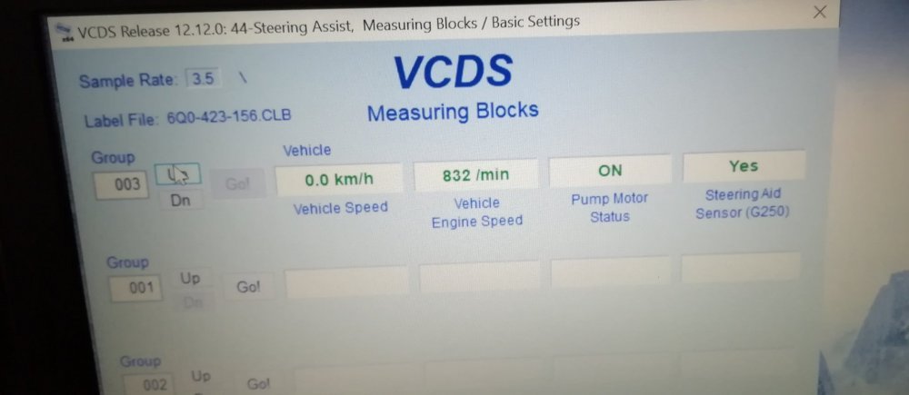

Here some vcds measurements on channel 44 before changing the pump.

You mean my original pump before changing is fine? The measurements in steer. aid sensor were changing when i turn the steering wheel, but the pump motor status and pump motor voltage is 0 always
