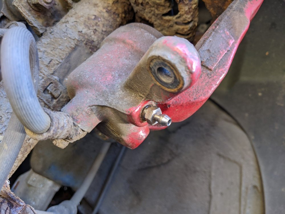

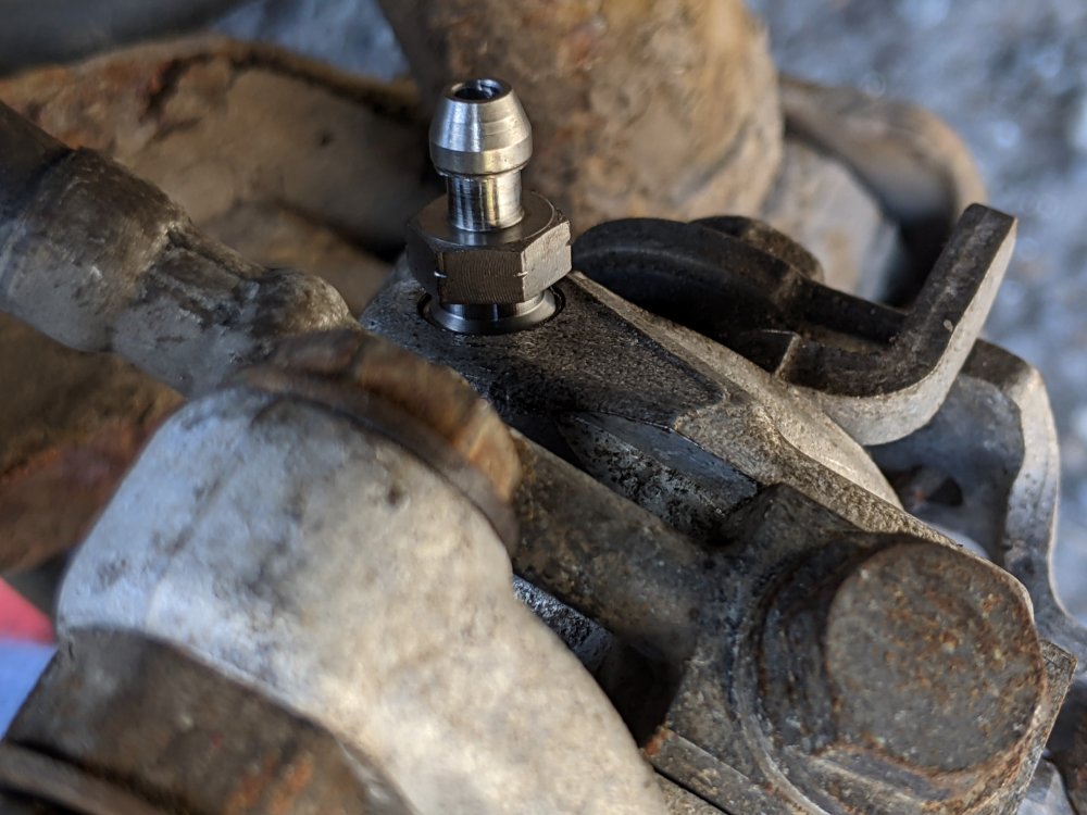

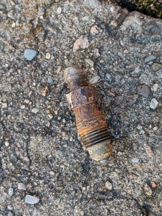

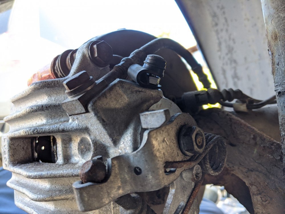

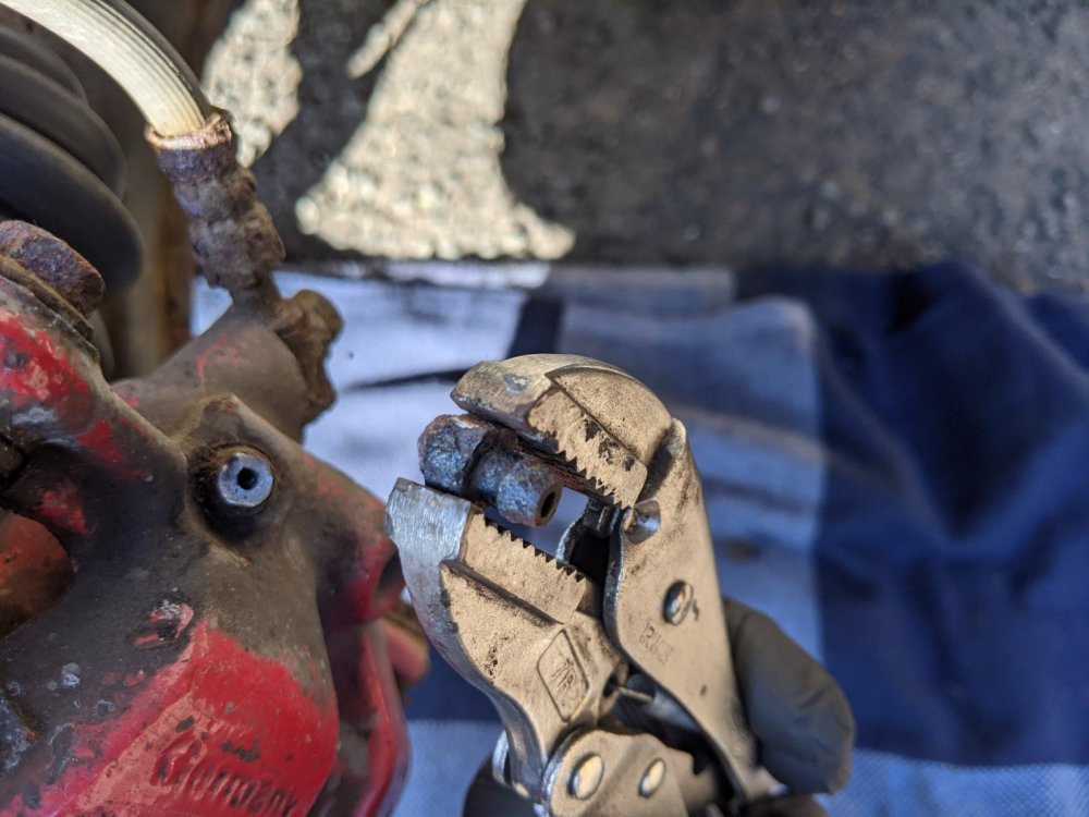

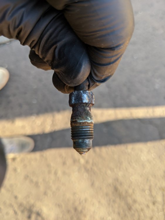

So yesterday the weather was decent so i managed to set about cleaning up the brakes all round and replacing all the bleed nipples, unfortunately that last nipple i tried to change snapped on the drivers side front, i may try and remove the remaining part or just replace the calliper

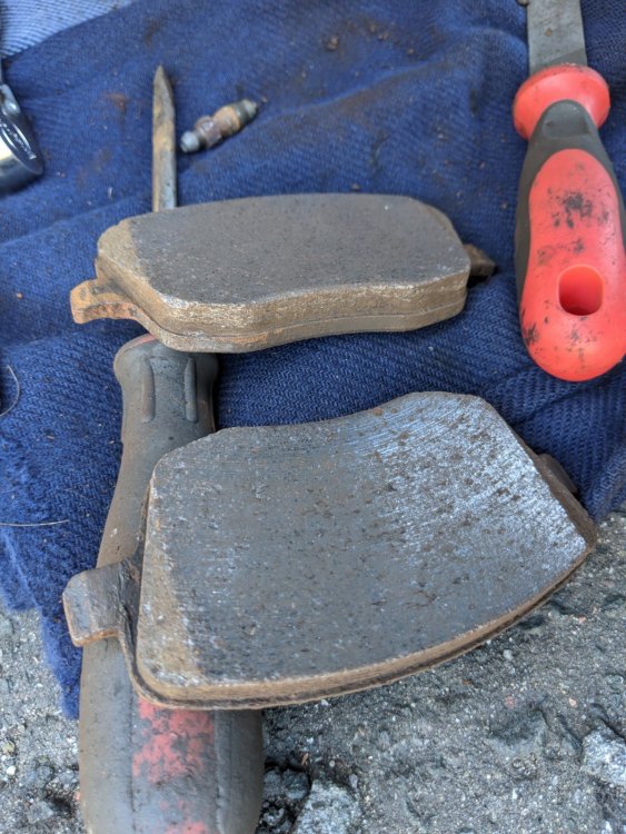

the discs and pads were all in serviceable condition and the pads were still nice and free within the carriers from when i fitted the brakes however many years ago that was, cleaned them up and applied grease

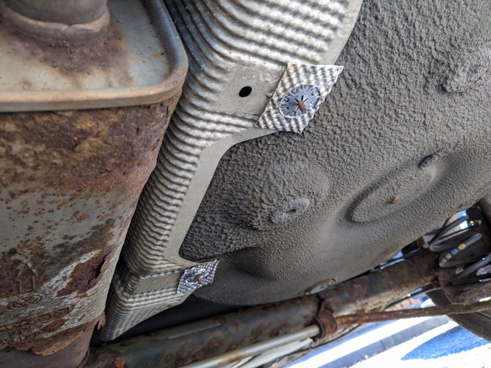

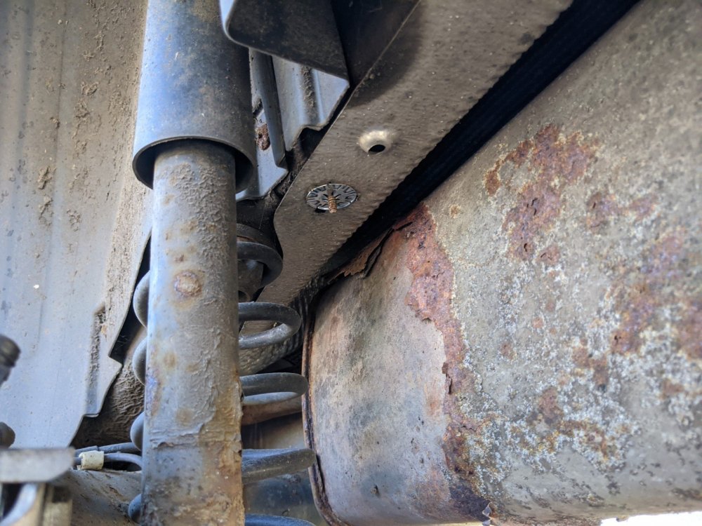

i also re-secured the rear heat shield with some scrap heat shield i had lying around and cut them into sections and folded and then secured the heat shield in place, nice and secure now with the new clips, its not the prettiest of repair but i would rather it was fitted than just removing it completely
