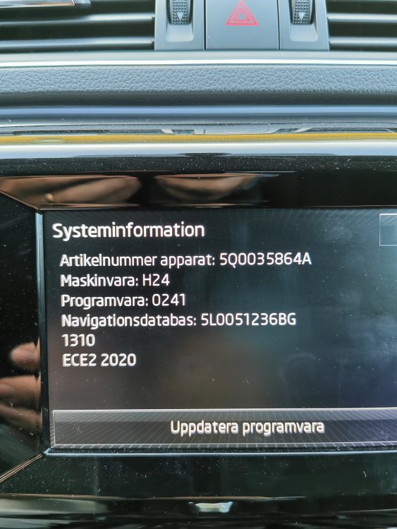

I am trying to use android auto on my skoda superb 2016 but I can't figure out how to get it to work. I don't know if the problem is in my phone or the infotainment. If I connect using usb my phone shows up but when I select it the screen in the car is saying it is scanning through android auto and mirrorlink but does not find anything. The strange thing is that my phone says android auto is started. But I cant see any difference in the dash, as I suppose ther should be an android auto icon or some new functionallity ?
Does anyone have any suggestions. Will updating the infotainment make any difference ?

It will probably be a combination of HU firmware, phone firmware & cable, it won't be anything to do with Huawei ban which only affects the latest phones which won't have Android (so no android auto).
