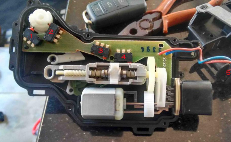

If the driver's side lock is faulty it can affect the operation of the rest. There are microswitches inside that need to be working for the system to function properly. Also, bad solder joints in the lock unit caused by the repeated slamming of the door over the years can cause issues. The brushes in the little DC motor can get gummed up too.
Microswitches numbered 1 to 4 here....

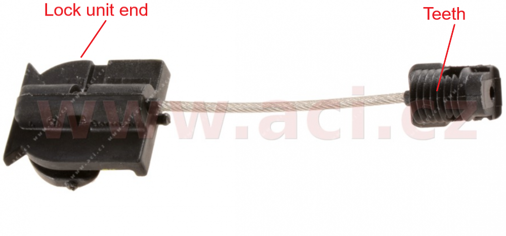

Doors not opening from the outside after 'intervention' can be simply down to the little 'stepped peg' that links handle to lock going back in the wrong position.
I'll add a photo later if it's not obvious what I'm referring to.
This thing?....
.Thanks. The door handle problem was due to the handle carrier spring being damaged when garage was trying to break into the car. That's all sorted now. I thought it was the part you pictured causing the problem, and was trying to use that to tension the door handle until I worked out the problem. Central locking is still not working properly. Mainly passenger side. Front door seems to work most of the time but the rear passenger doors not locking at all now. Thinking I'm going to change out the door catch and see if this sorts it🤞
