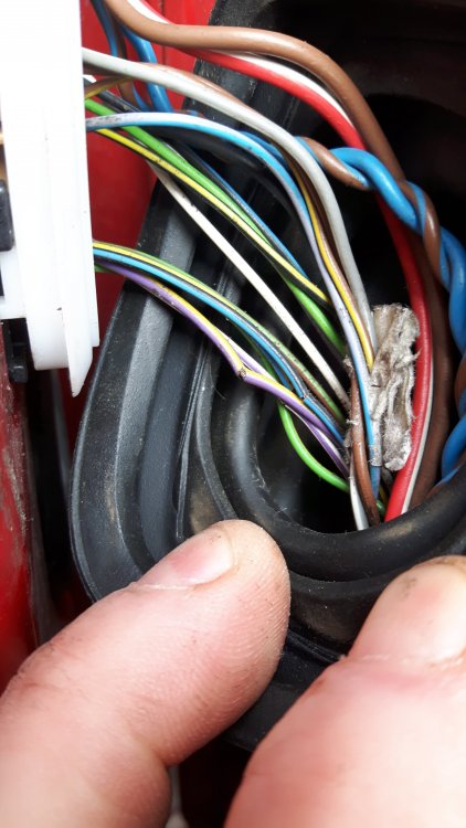

Had reports from the good lady that the doors have been locking themselves whilst driving (not programmed to do so), and have personally experienced occasions when the tailgate hasn't responded to the release button above the numberplate.
Had a look in the driver's side bellows this morning and think I've found the problem(s); several cracked wires:

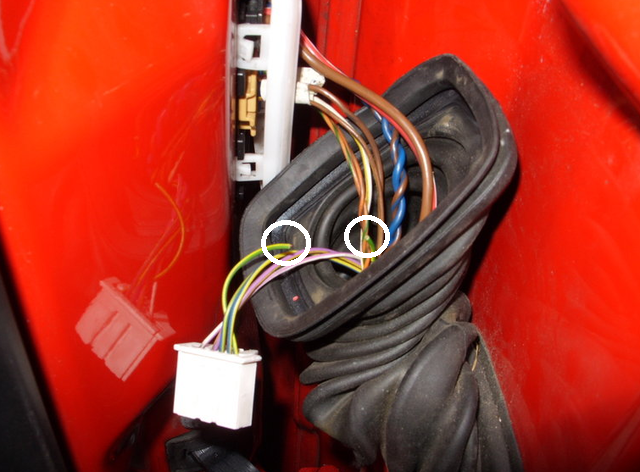

So "replace the lock" isn't the only answer. Will have a look at mine since I'm getting locked and unlocked when I shouldn't. Close the door with keys on the car, car running: *lock*. Lock has to go down as soon as the car reaches a certain speed: *lock* and immediately after *unlock*. All in a rather erratic manner. Also the dome light isn't getting triggered by the passenger side door but that indeed has to be one of the microswitches in the lock, but having a look at the wires won't hurt a thing.
Same thing happened to mine only just one wire. The doors were randomly locking/unlocking when driving.

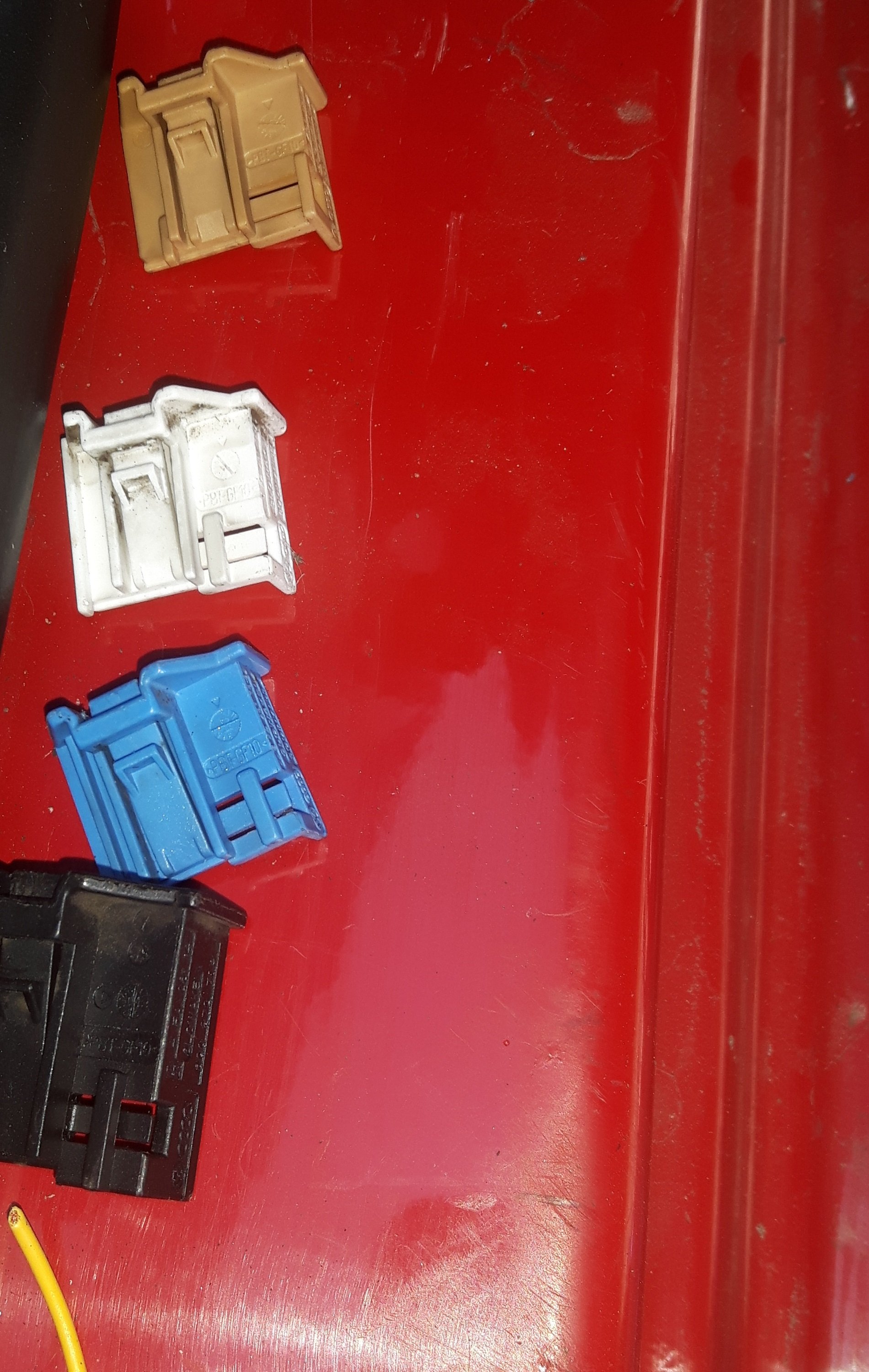

BTW, the slidey-off bits of these connectors are quite a bit of the bulk of the connector, so if you are planning to try to extract the connectors through the bellows, take them all off first, and don't put them back on until you've got everything back through the other way when re-assembling:

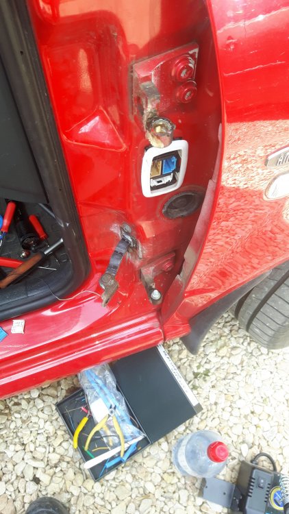

At that point I was almost ready to give up for the day, but just then the missus arrived with a cup of tea for me (well it is her car...) and I described the difficulty I was having in examining, let alone getting anything anywhere near these pins to clean them.  She came straight back with "how hard is it to take off the door?".
Now I didn't know the answer to that, never having tired it, but even before I thought about it, I started to say "but the bit I want to get at isn't in the door" with a slightly impatient tone.  Before I'd finished the sentence I figured out that removing the door would improve access by a country mile, so said "let's see...".
It turns out that it's spectacularly easy. Two 13mm nuts, one at each hinge, an M8 XZN screw holding the checkstrap to the door, and of course those wiring connectors if they weren't already disconnected.  I expected it to be moderately heavy so made sure I had a good grip on it before lifting it off the hinges. Absolute piece of cake!

This left just the black housing to extract from the A-pillar. Easy, just a little release tab top and bottom. For once Skoda were actually generous enough with wire length to pull this out far enough to turn it round and see how to release the four separate connectors. Middle two, brown and blue ones are slightly harder than the top and bottom black and white ones, nothing to delay one long though.  Then the same slide-off style clips that let you in to de-pin.  You do need a twin-prong depinning tool for the black one's pins btw. This one has flat power-carrying pins, the rest are all square, and pretty thin and delicate looking, so go gently.

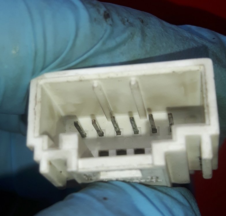

This was the best photo I took of the grubby pins, couple of them were oxidised on all four sides to some extent. Pretty sure this will have been the problem.
Repair pins are available, but none of mine looked too far gone, so just gently scraped clean with a scalpel, after de-pinning each, one by one.
