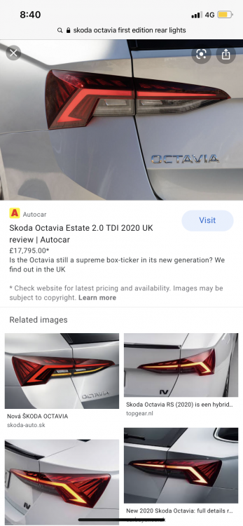

Like in this pic it runs all the way to boot but on my boot nothing??

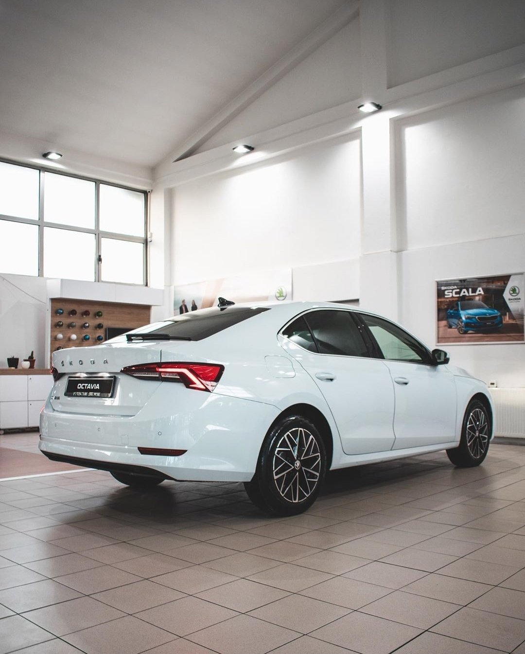

Here is a photo from my dealer's show room. As you can see even in the showroom the lights on the boot are not lighting up.
So Skoda won't care.

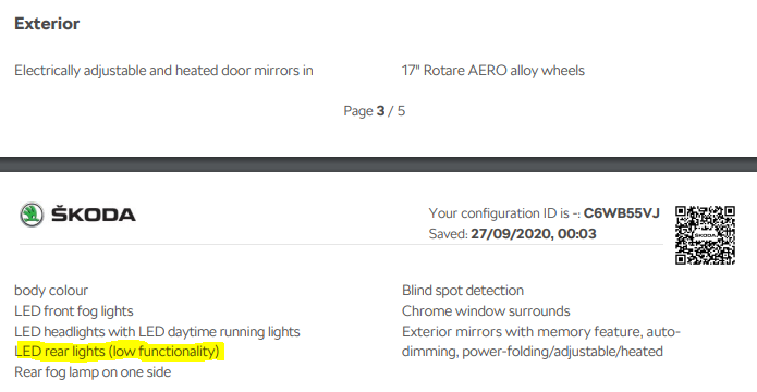

Having looked at some of the reviews of the Mk 4 on YouTube from other countries it seems that the rear lights go all the way across even on the lowest spec cars (those with the 8.25" infotainment screen). Bizarre.
To get the LED strips that extend into the boot lid you need to ensure your Octavia has the "high functionality" rear LED lights.
These are only available as a factory cost option and are bundled-in with several different options packs.
1) Full Matrix LED headlights, rear LED lights (high func) and dynamic indicators...
2) Rear-view parking camera, Full Matrix LED headlights, rear LED lights (high func)...
3) Rear-view parking camera with rear LED lights (high func) and dynamic indicators...
As you can see the high functionality LED rear lights can be specced independent of vehicle model and also without the Matrix headlights.
You can have a lowly spec SE with the high functionality LED rear lights simply by speccing the reverse camera.

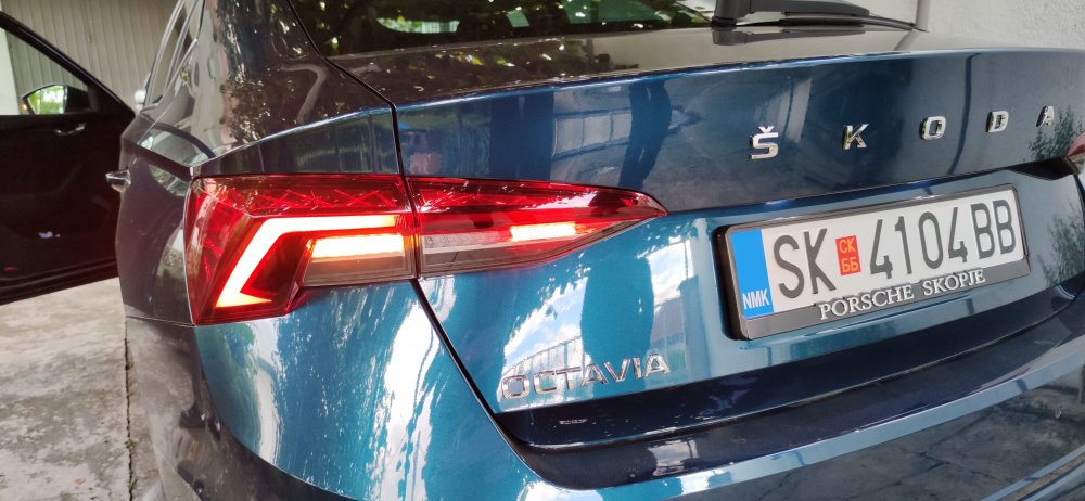

Here is my car. All the lights and turn signals on
The specs for North Macedonia are likely to be different than those of the UK.
Presumably your Octavia does not have either the reverse camera or Full Matrix LED headlights?
True, but why not go all the way with the light bar. It doesn't make any sense.
