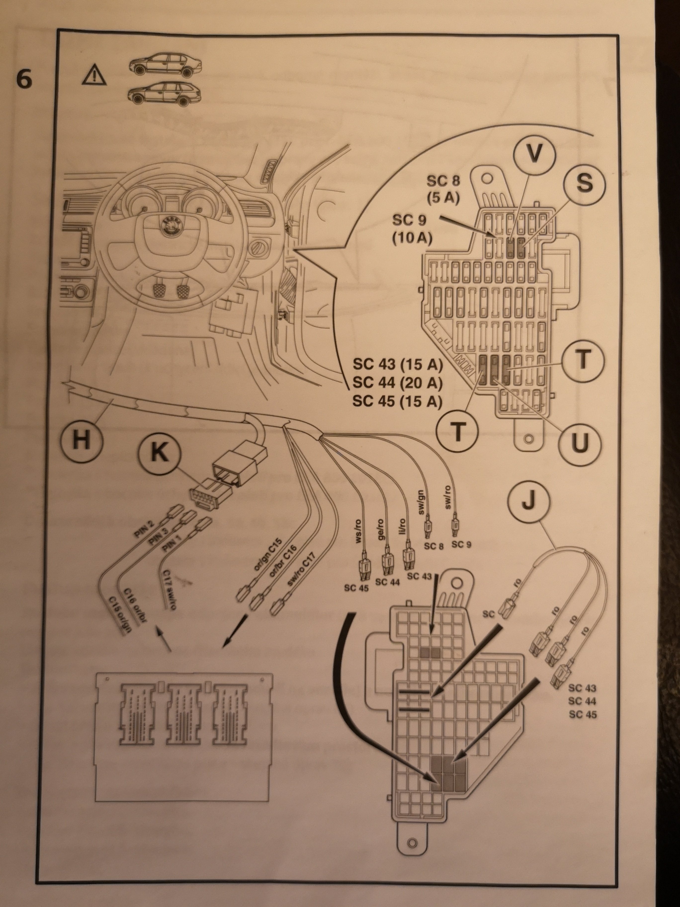

This isn't something I've massively looked in to as I'm happy to be corrected, still, from a quick google I believe the following is correct.
If a vehicle has towbar prep, there will be a connector in an appropriate location to take a towing module.  If this is the case, you'd need a kit similar to https://www.ebay.co.uk/itm/174195333679 which appears to include the module and the towbar side of the electronics.
If a vehicle does not have towbar prep, there will be no wiring present so you'd either need to buy the additional loom or create your own. Obviously you'd need to check for a Yeti but I'd guess at:
- between 2 and 4 power feeds taken from various empty fuse holders
- a ground or 2
- twisted pair for CAN-bus
- many wires to the towbar socket

It'll probably be the same as a MK2 Superb which I found the image below for. Basically, many fuses, CAN-hi/lo (C15/C16) and the brake light switch (C17):
