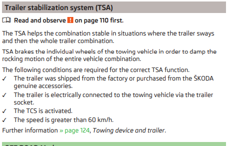

You will then benefit from the Yeti dong the trailer bulb monitoring the parking sensors and lights will work correctly and the stability control will enable "Trailer Stability Assist" when you have a trailer attached

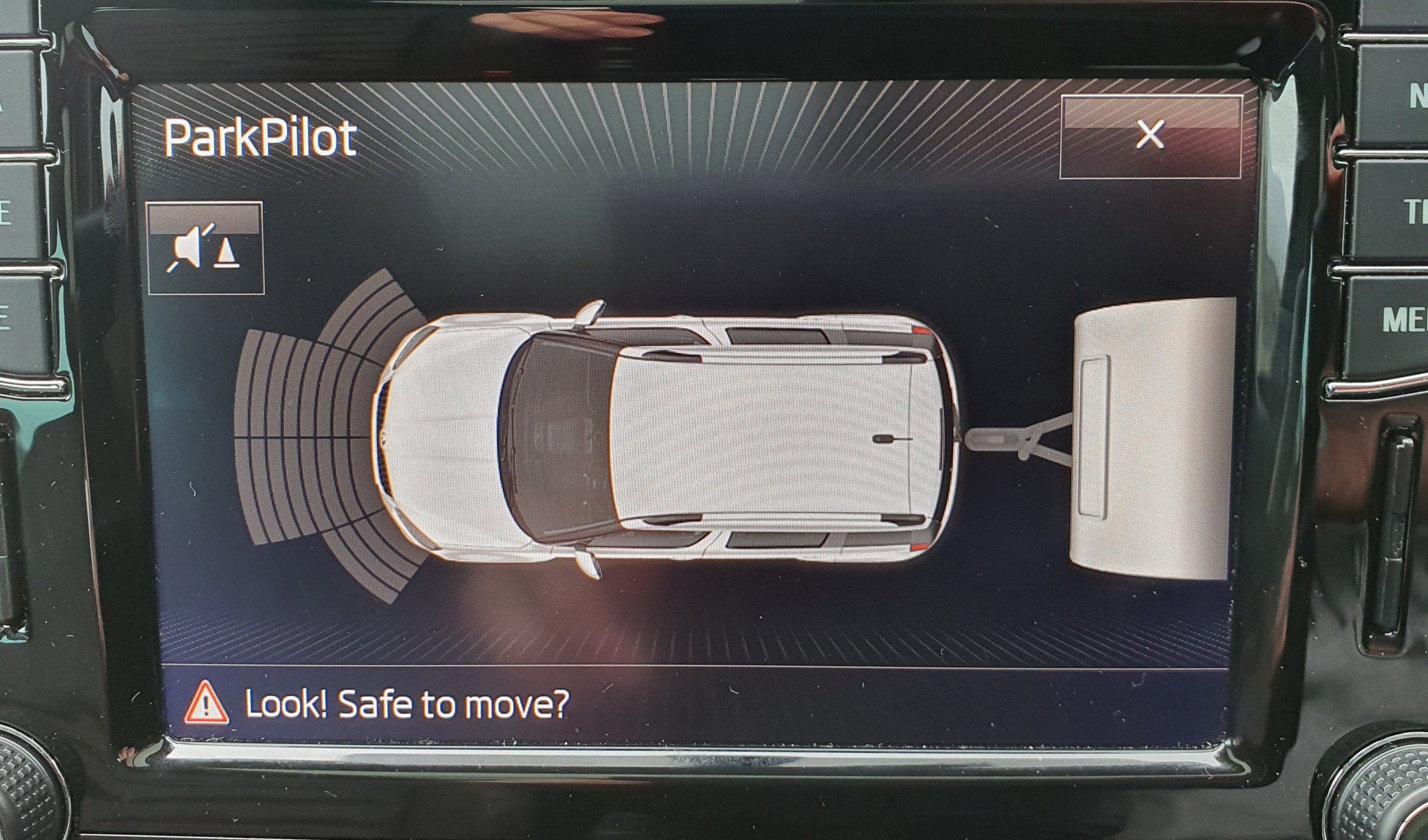

The Yeti doing bulb failure monitoring and foglight switching.
Correct operation of parking sensors.
And most importantly antisnake adaption of the cars stability control
