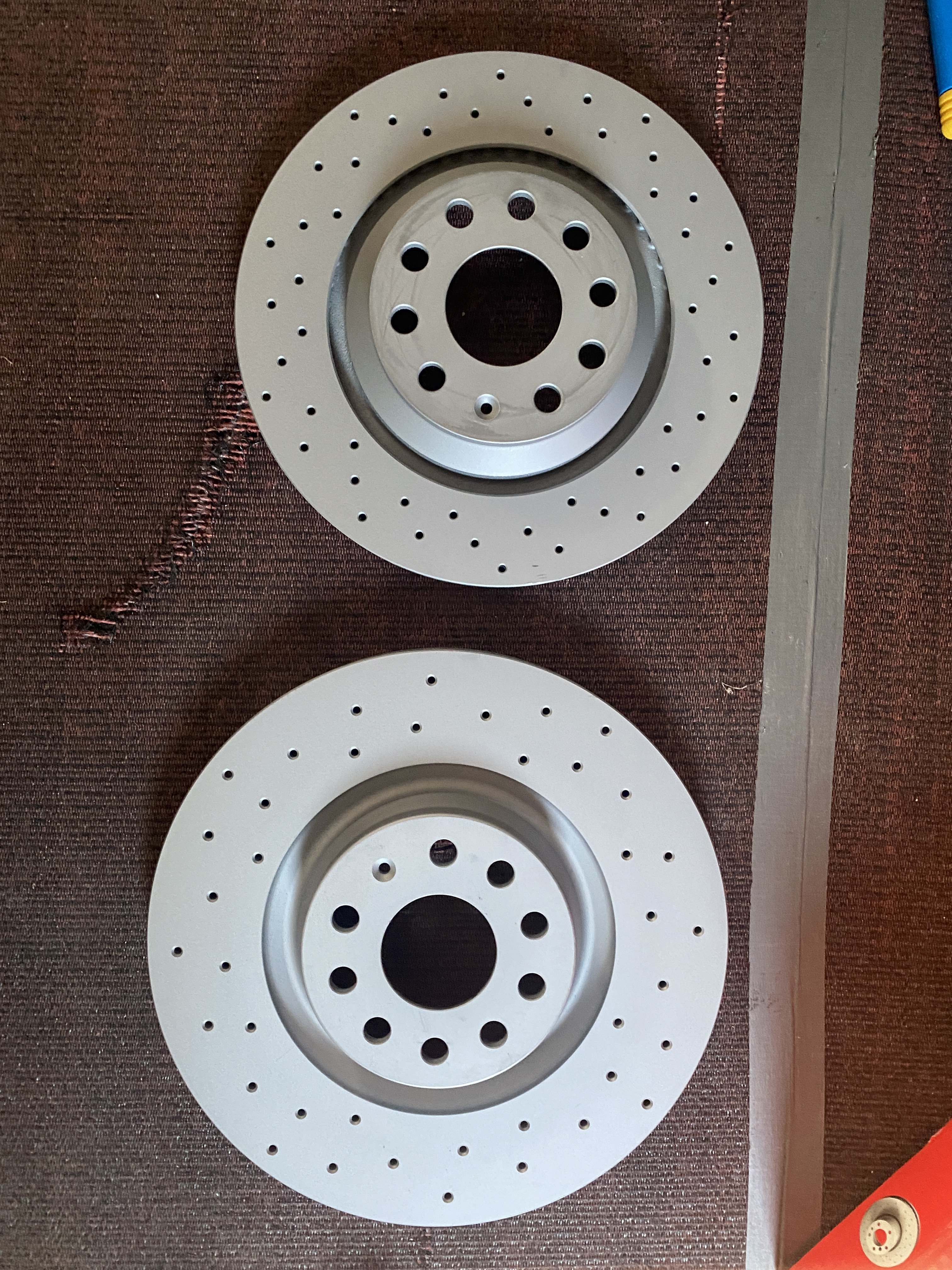

brought these from AUTODOC last week. They are Zimmerman sport discs. Had them on from of the superb and an octy before that and they have last a bloody good amount of time. Upgrading the back ones to the vented 310mm like the petrol 289’and golf r etc
