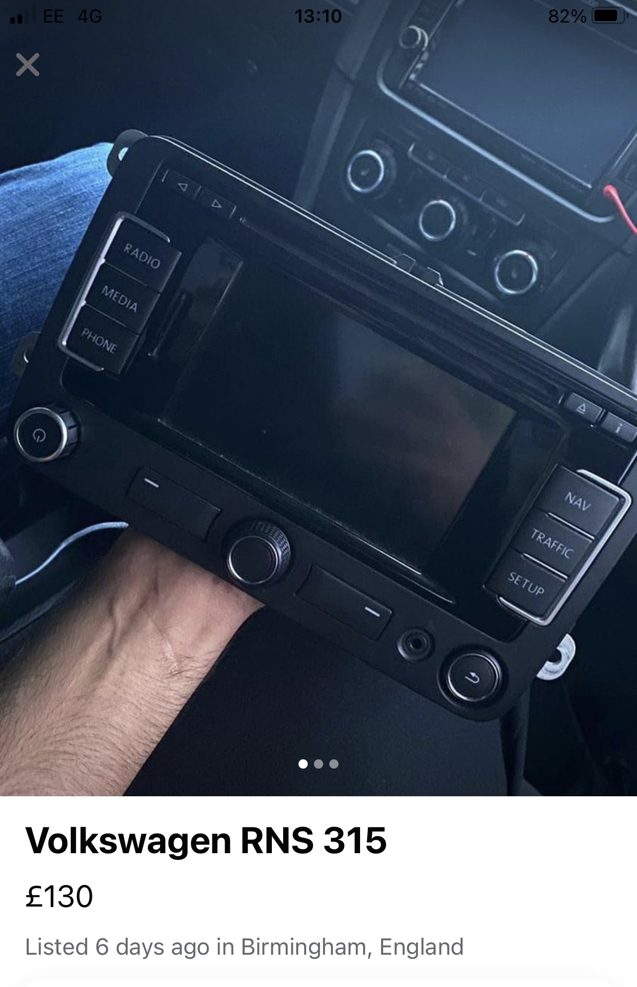

Not sure of your area but there’s one sitting there at £130 on my first search, albeit VW.
