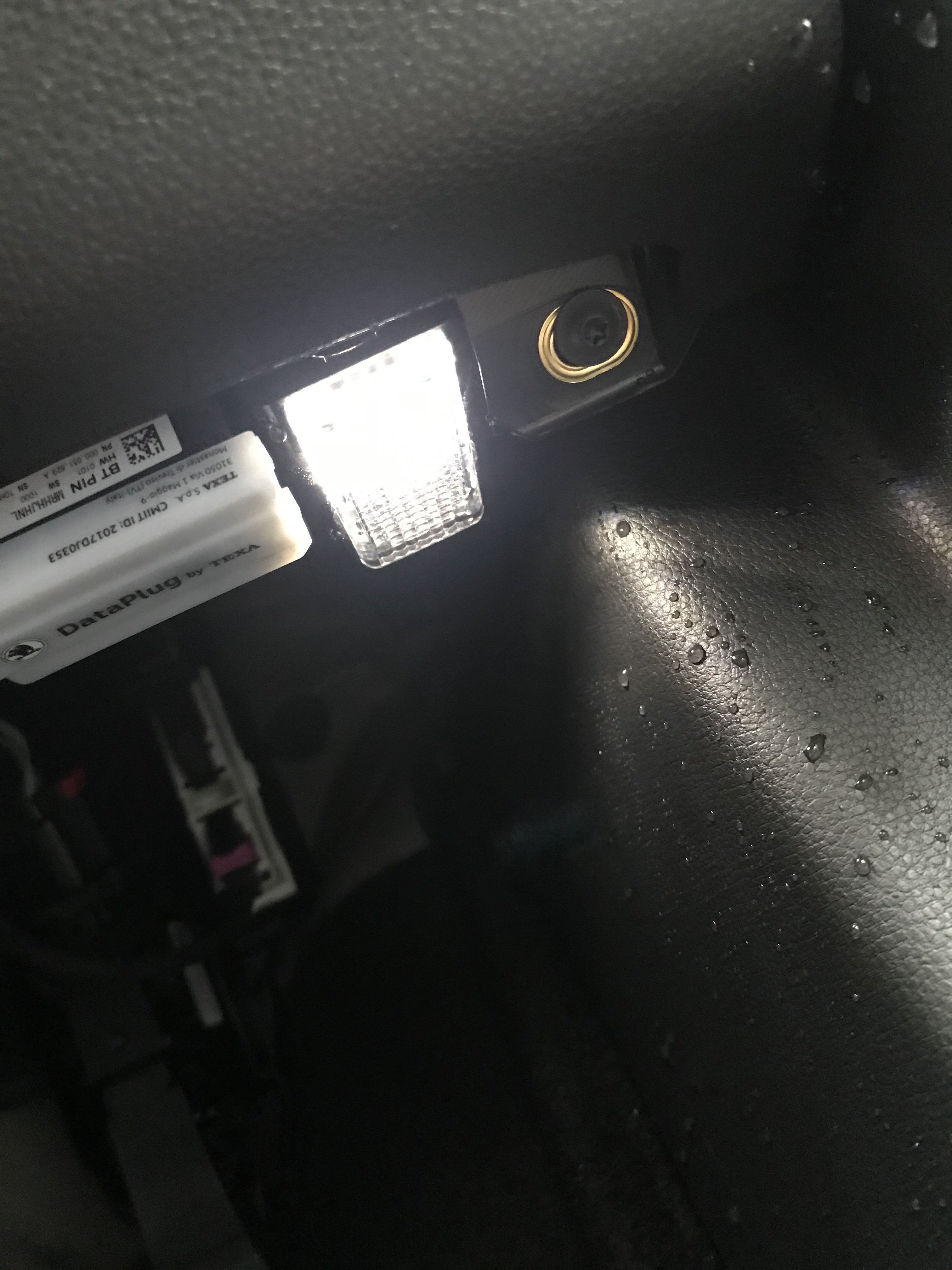

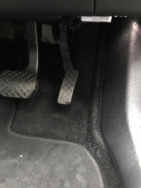

Hi all

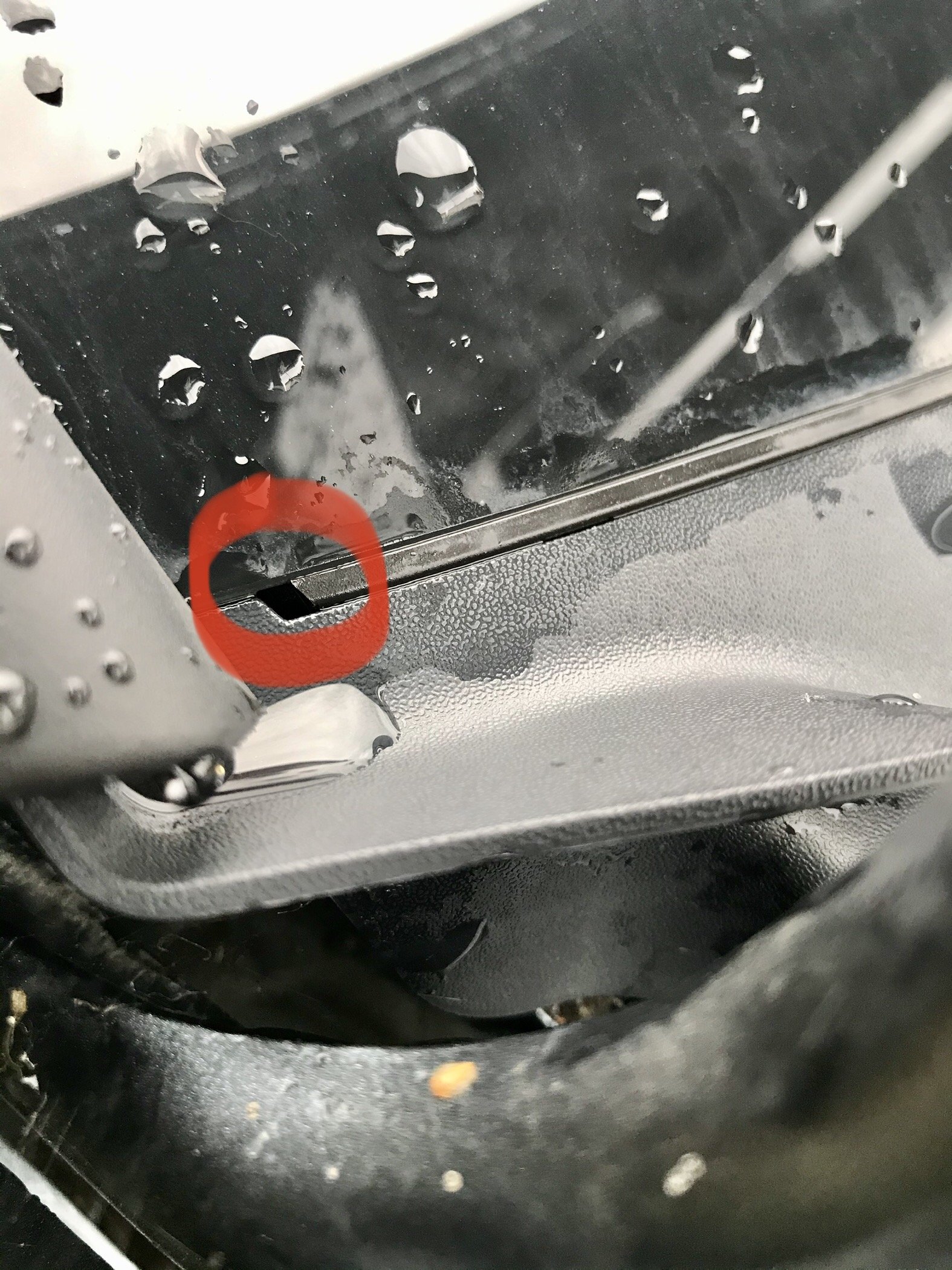

got in the car this morning to find drivers footwell soaking wet with evidence of water coming in from behind the dash. I’ve had a little look around the exterior and found a possible gap in the windscreen seal at the base. See attached photos. I have booked the car in with Marshall’s but could not get an appointment until 19th October. I wondered whether anyone else has experienced this with a Karoq during Heavy rainfall?
Do you have a pano roof?
That gap doesn't look right at all!
Surely that just a badly fitted trim, The windscreen should be fitted with a line of glue all aound its rear edge inside bonding to the bodywork.
More likely to be a blocked sunroof drain, if fitted, or a blocked drain in the scuttle area under the bonnet causing a pond which has found a route to overflow  into the car
Thank you for your comments so far. Yes have panoramic sunroof fitted. No sign of anything coming down from there but not checked any drains etc. If it is a drain mentioned, any idea of where these can be found and I’ll take a look? Fingers crossed it’s just something really simple like that! Thanks again.

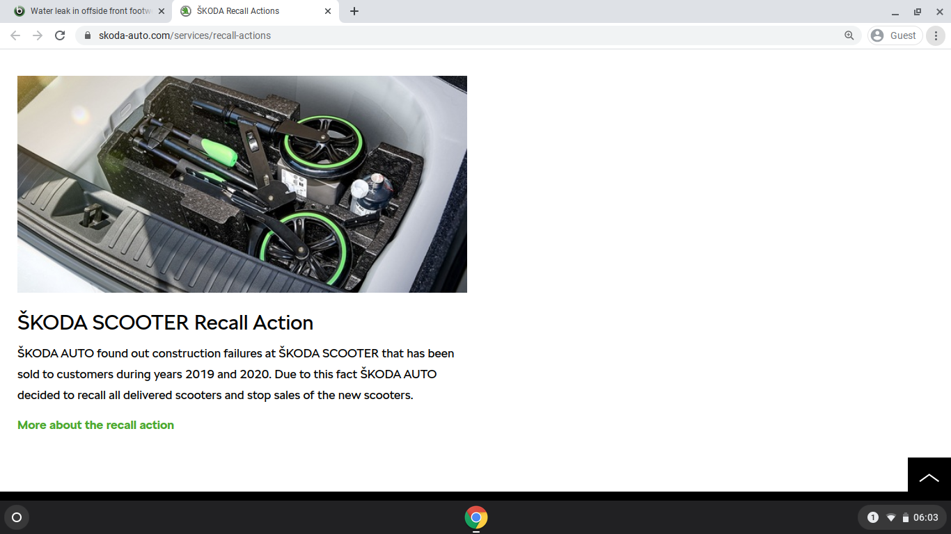

They are not RECALLS.   Dealership staff and Skoda Customer Services might well say a RECALL.   They are a Recall action as they now are called,  that is a Service Campaign really.
http://skoda-auto.com/services/recall-actions
A Workshop Service Campaign or SKODA SECRET SERVICES action.   Need to know and if you are not visiting a dealership you are not needing to know.
It is a ridiculous situation that Skoda have been up to for years now.
http://briskoda.net/forums/topic/337617-skoda-service-campaigns-no-recall-being-done-briskoda-forum
