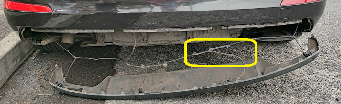

As you can see from this image, someone else had butchered the loom on the car, and no power was flowing to the 3x sensors on the right
Bottom line for you, is you are best to get a scan of the car to find out what fault codes exist
One easy way to begin to check the cabling is, each of the sensors have 3 wires going to them,  +12V power, a 0V earth return and an output, so you should find that there are 2 pins in each plug that go to the same 2 pins on the other plugs - but not to each other and only the output pins are completely separate from all the other pins.
Edit:- but as has been said already, when you get a couple, three or all four sensors claiming to be faulty, then it is usually a wiring issue. The way that VW Group's supplier has made up these cable forms, there will be joins as the common +12V DC and 0V return lines are daisy chained along the bumper.
