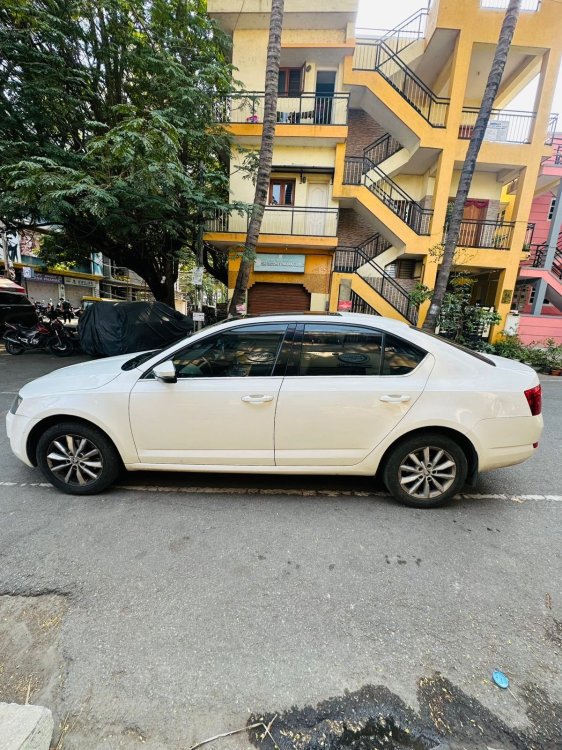

Hello,
I am new to this forum. I recently bought a used Skoda octavia 2.0 tdi style plus variant(not sure if this variant is called such in other countries, I have attached a picture for reference). I had a complete inspection report from Skoda before buying and they had mentioned about the suspension strut cut and bushes damage as well. I want to change them now and most of them in my country is biased towards Sachs, but I don’t think they are good as it is very stiff and good for highway rides. My rides will be mostly in the cities with humps and potholes, and I don’t want to go with bilstein as they are very very expensive where I am. Can anyone please suggest what other aftermarket brands I can consider which is pocket friendly and also durable. I heard about Magnetti marelli, monroe & trw. OEM suspension is really bad and stiff like Sachs and also double the price of Sachs which is already expensive and is not worth it for a 10 year old secondhand car. Can you please suggest other options.
