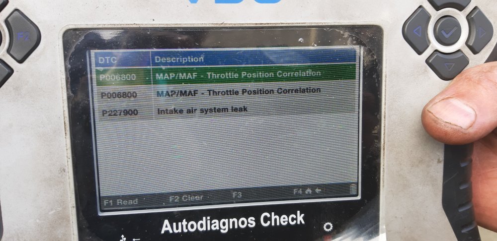

Hello,
Im in need of some help / advice. My EML has come on and the faults are as per the photo...Any ideas or has anyone had simular ??.. Is it easy to fix and roughly how much ???
Thanks in advance..Paul 🙂🙂
Usually caused by the EGR valve sticking open slightly allowing exhaust gases (too much) to enter the cylinders and therefore less air to enter cylinders. Replace EGR valve with new one. Quite common not just on VAG engines. No idea of cost.
