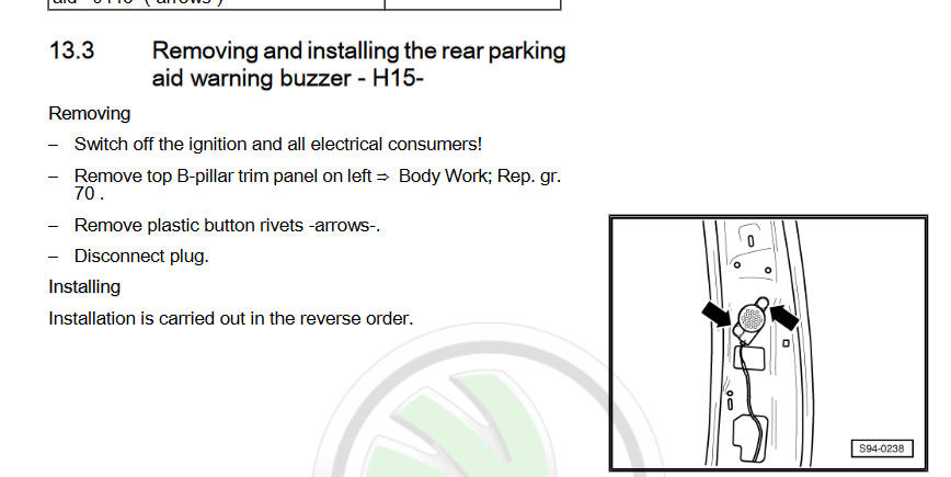

I know it's a bit late for you, but for anyone in the future, you'll want H15 for the rear.
