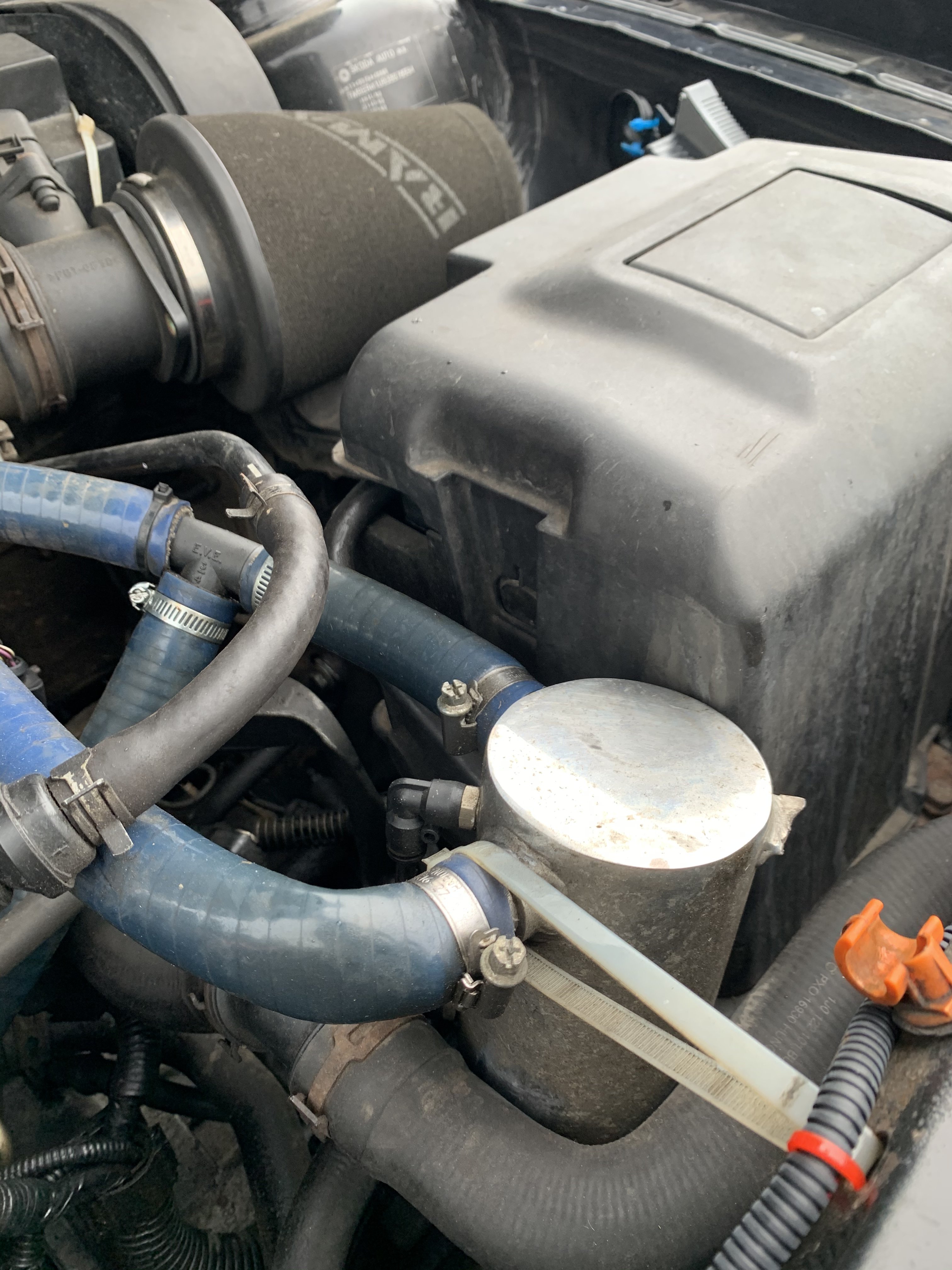

Just picked up a second hand mk1 VRS yesterday. The previous owner says the car needs an oil change, so that's top of the list. The car's come with an unmarked, aluminum, cylindrical "oil cooler" that's cable-tied to some aftermarket hoses at the top of the engine bay. I'll add a picture when I go back out to the car this morning. Anybody familiar with something like this? If so, got some questions for you...

Your description of its approx location leads me to think its not a oil cooler but something called a OCC (Oil Catch can). Like many engines
the engine "breathing" is a closed loop system. What that means is, it recirculates gasses via one way valves and pipes back into the combustion
chamber to be burnt off. The down side of this is over time valves and the pipes become clogged, also you can get a build up of film on the turbo
impeller. All not a good thing.
The solution is to fit a OCC, this filters in effect the oily air, cleaning it so nice clean air gets burnt . The OCC should have a drain off and
periodically drained (more often in the winter because of internal condensation forming).
If you can post a picture this will confirm its function though ive never heard of a extra oil tank / cooler being fitted by a "enthusiast"

Mine doesn’t look that cool, but yes after further inspection (and actually using my brain) it’s a catch can. Going to be interesting figuring out all the little bits of this car and being more mechanically minded than the previous owner...
:thumbup:
The engine does have a oil cooler of sorts, its a square metal box (with 2 hose connections), the engine oil filter does actually secure against its lower face.
