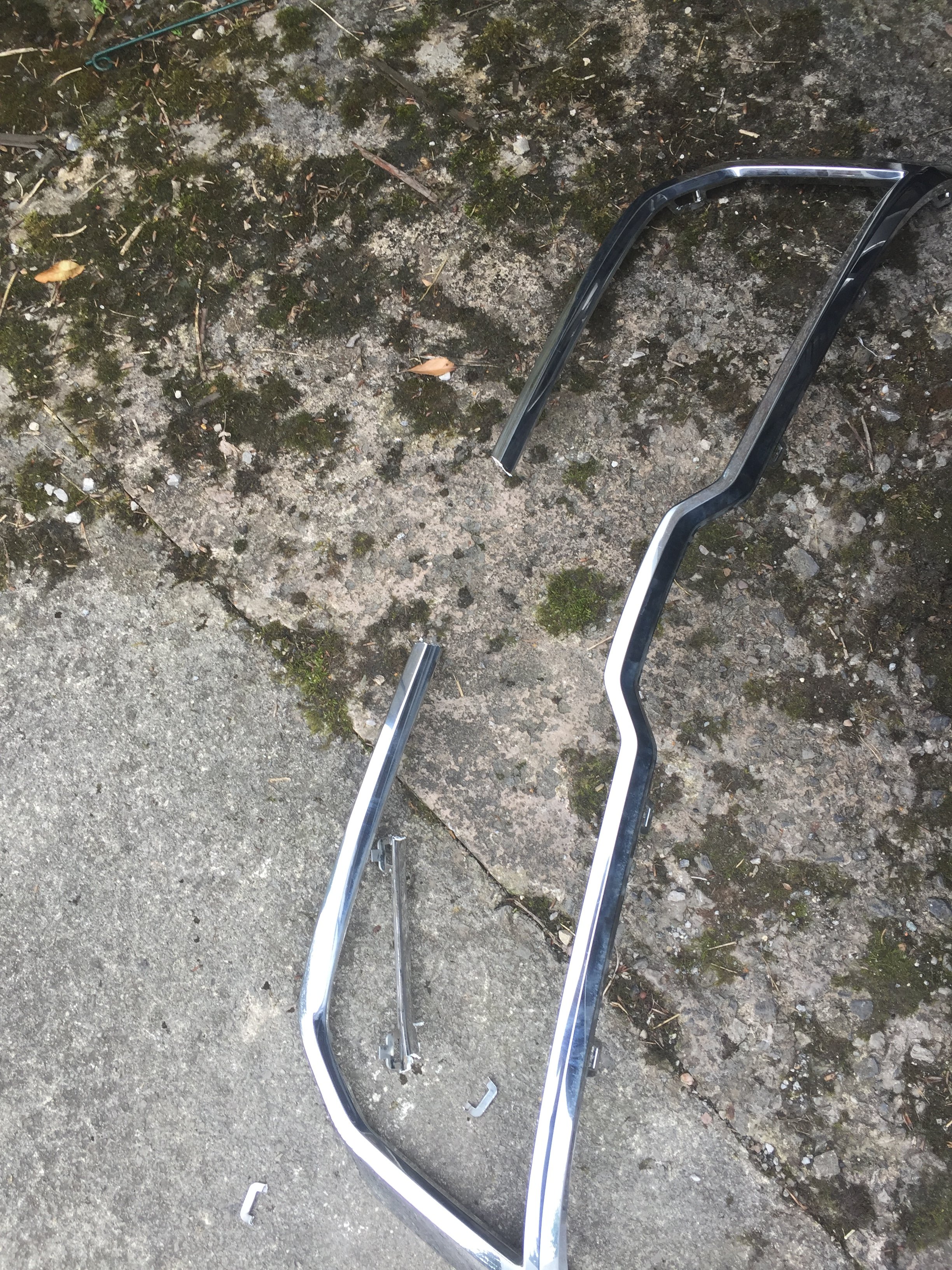

I fitted the black frame & black badge, originals were both broken on removal with no damage to car or front radar.
Front of car looks a lot better, but my car is black magic.

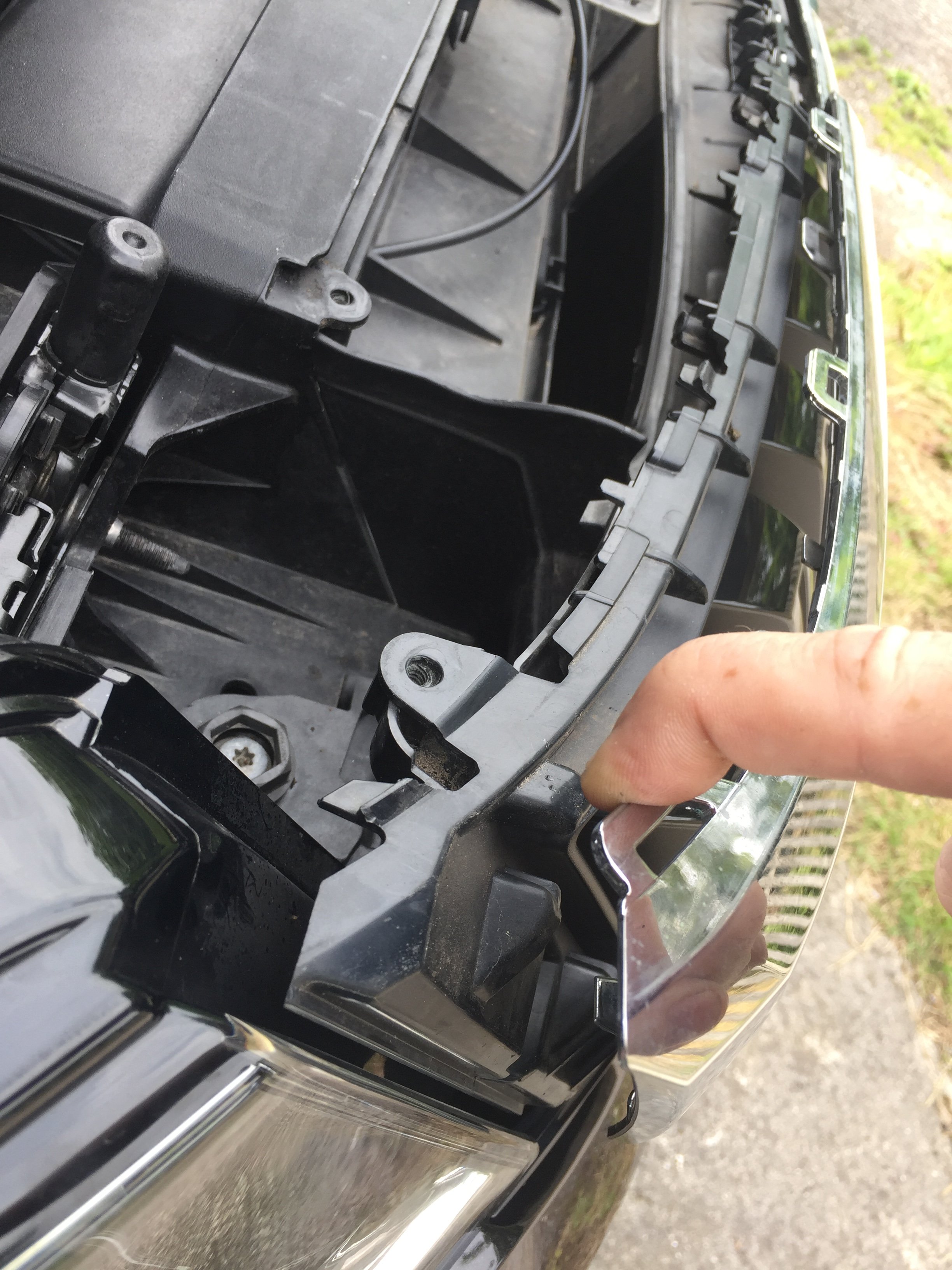

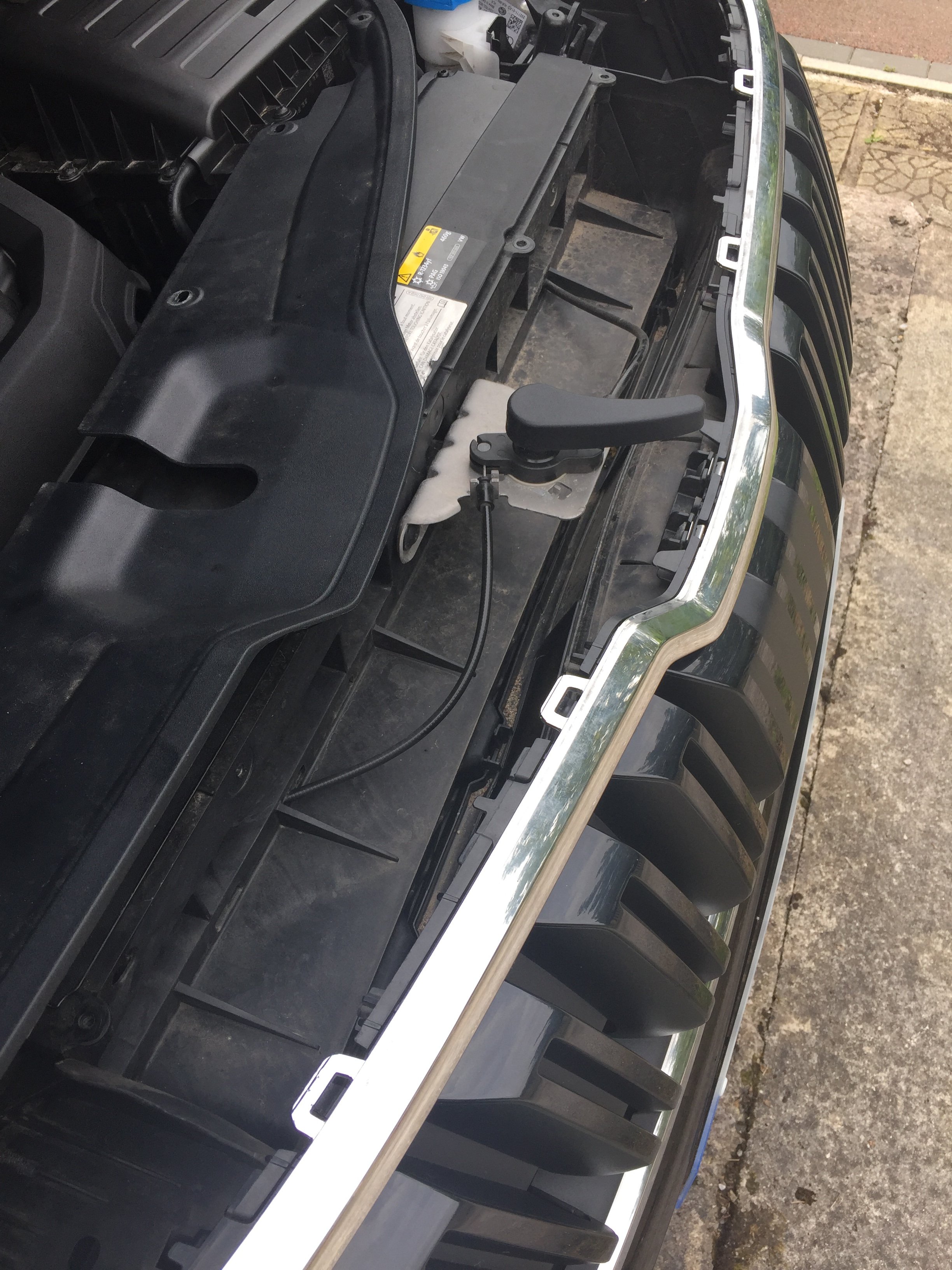

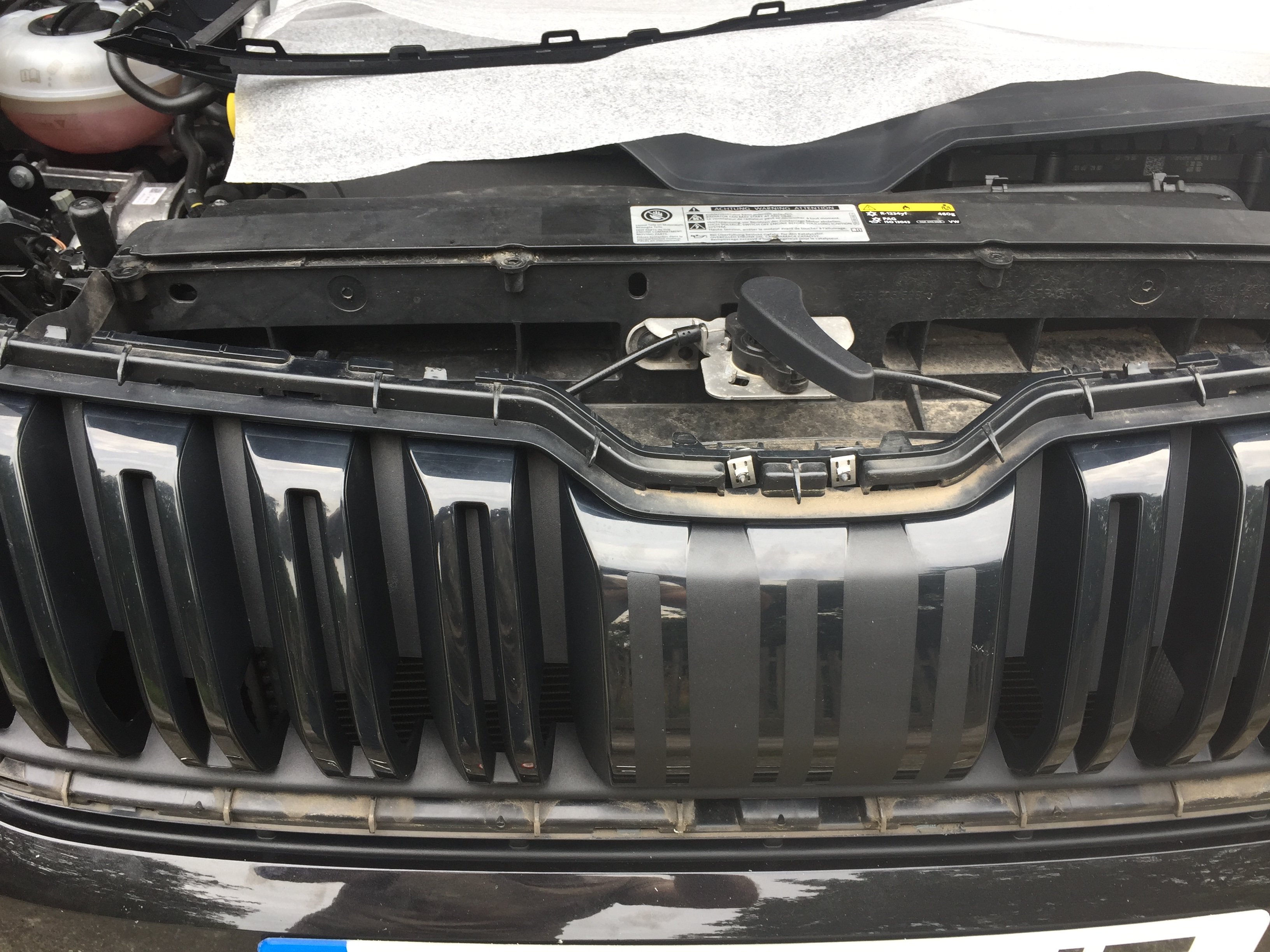

Thanks for letting me know it’s possible. Are you able to give me a few details about your removal procedure please?,it’s really important I don’t start something I can’t finish.....
Are there screws/bolts to remove or is it just brute force to get it off??
I removed the top trim off mine in order to gain access to the upper grill surround clips. I couldn’t get to the lower clips without taking the bumper off, so ended up breaking off the old grill surround. New on clipped in very simply.
Thanks for this, gives me a little more confidence to attempt it.
