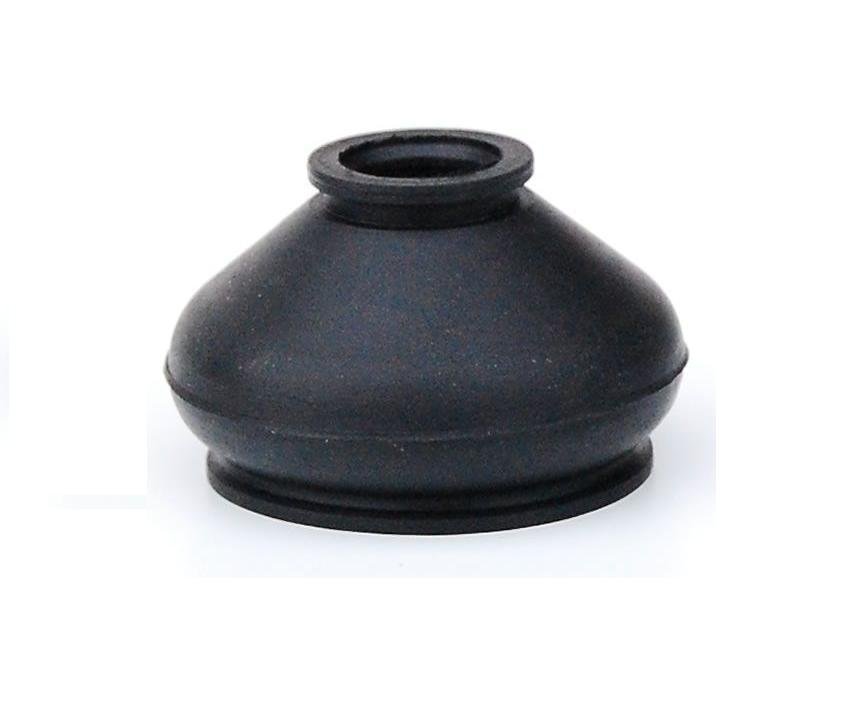

Please help!! I've just had a service and it came back saying nearside front roll bar link ball joint gaiter split...and it would be an MOT fail...
Can I buy one of these easily from euro's or similar? Can someone please translate it as well please? Is it a boot????
Thank you
Edited by muffty
Sounds like the rubber boot on the drop link has a split / hole in it. A drop-link can be bought from ECP etc cheaply and easily changed.
