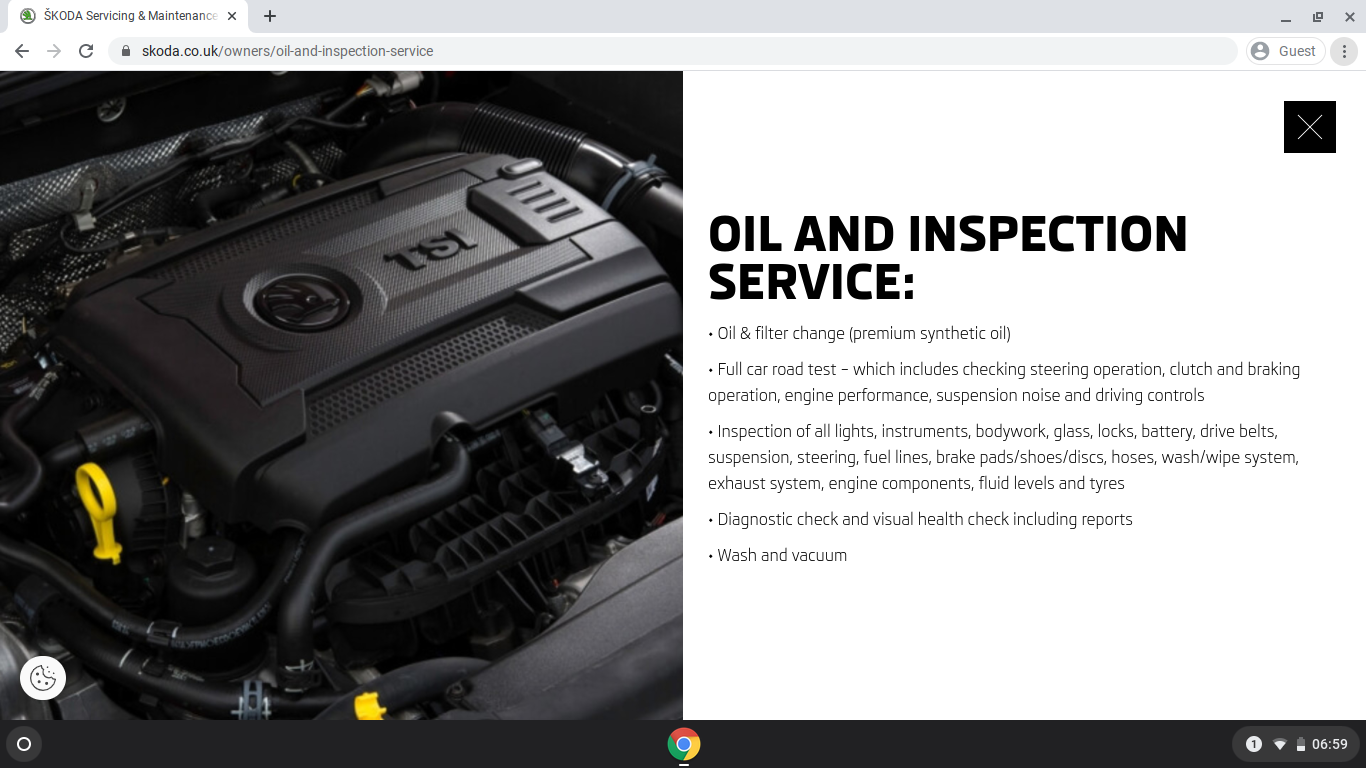

Services might seem like just Oil / Filter services, but at least an annual service should have your car getting a visual inspection and report which is good if you are not doing the checks.
