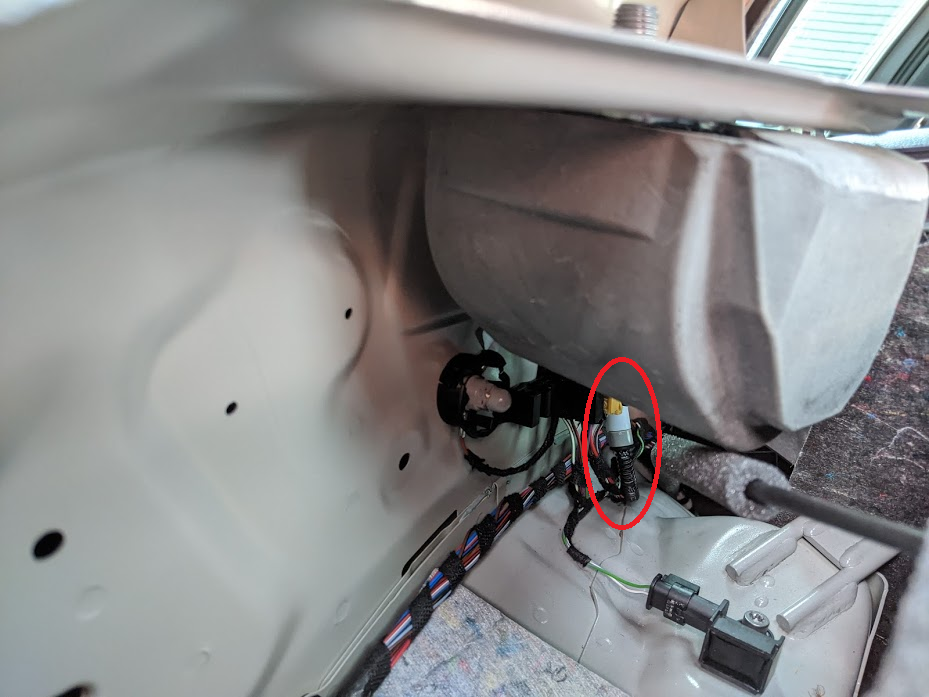

Not sure on the exact route of the washer pipe but on my '18 plate vRS hatch, I noticed there is a also a connection on the left side of the boot before it goes up to the boot lid.
If that's popped off, it's plausible the fluid could run down into the boot area :)

The connection I found was much lower down, around the rear seatbelt area:

I'm trying to work out from your photo what position inside the car I’m looking at? Ive stripped away the inner walls on the left of the boot and the area but not as far as the rear seat belt.

The connection in my picture would be about here:
If it's so wet behind the left light, it suggest the problem is around that area as it's unlikely for the washer pipe to make it that far.

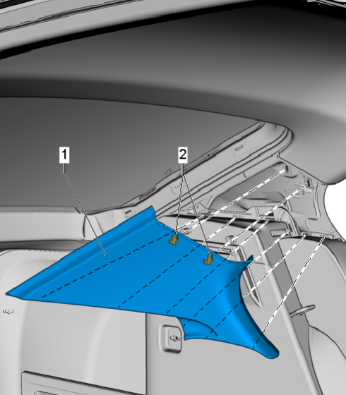

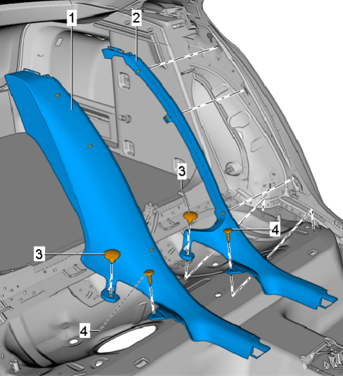

The top of the C pillar just pulled off:
I just pulled the top of the lower C pillar out slightly but left the lower part attached:
I haven't got an image for the next bit, but I think there were one or two obvious screw for the 'top' panel on the boot side to pull away.
Various metal clips were used, I think one stayed attached to the car body. If this does happen, grab some mole grips or plyers and remove it from the car body, it should just slide back onto the trim ready for refitting :)

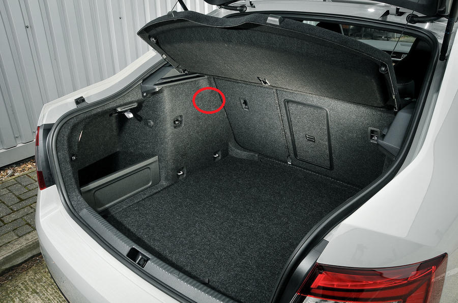

It’s the parcel shelf supports ( not sure if this is the exact one but looks similar) . This is covering the seat belt roll . I’ve only removed the part in the left hand side to remove the carpet.
The fitting is on the left looking at the image and there is a square plastic area which goes through a square cut out in the carpet and then a steel spring clip which snaps into a metal hole in the boot. The clip part has fallen away and  l was wondering if it’s worth removing the whole piece
Looking at this image I’m wondering if you need to remove the white trim that comes over the top of it.

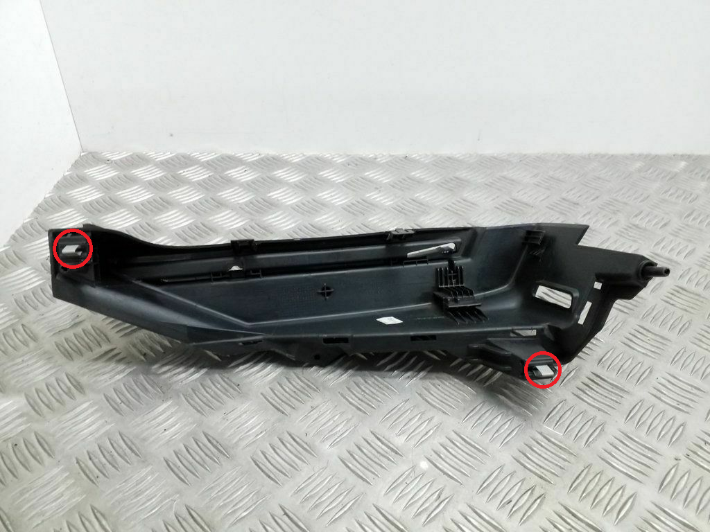

Looking at the image below, there are two metal clips, is it one of these you've lost?
If so, I'd suggest finding it if only to stop it rattling around. Maybe a magnet on a string or stick?
Which white trim piece? The triangular one in my last post? Then yes, remove that before trying to refit the below.

Cheers mate, yes that’s the one  I have got the metal clip that fell off and if it can be refitted onto the plastic that retains it I’ll do it. I suspect I could find some other way of fixing it back on.
Its whether it’s worth removing even more trim to remove the shelf support so I can put the clip back in place. Once the carpets back in and the shelf refitted it’s probably not going to make that much difference
