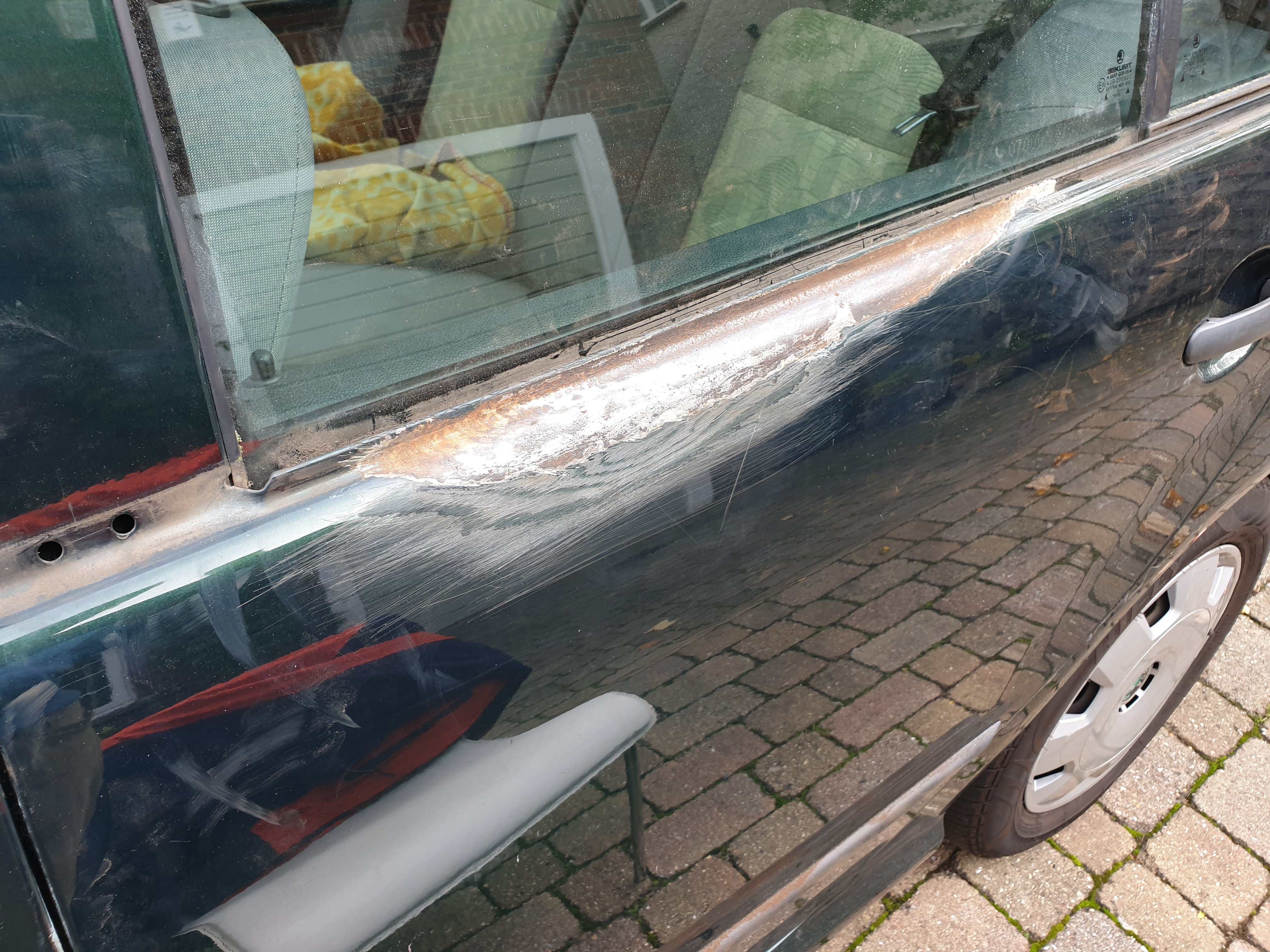

How would I remove the bottom part of the rear door seal as in the picture?
Tried gently pulling it but it doesn't seem to want to come off.
You have to pull it upwards. I found this out on my 20 year old Fabia,when I noticed if I slammed the drivers front door the seal lifted on the handle end on its own. I just used silicone seal to hold the seal in place . The seal has an aluminium core. In your photo I can see corrosion of this inner metal which shows as bumps on the outside, just like mine.

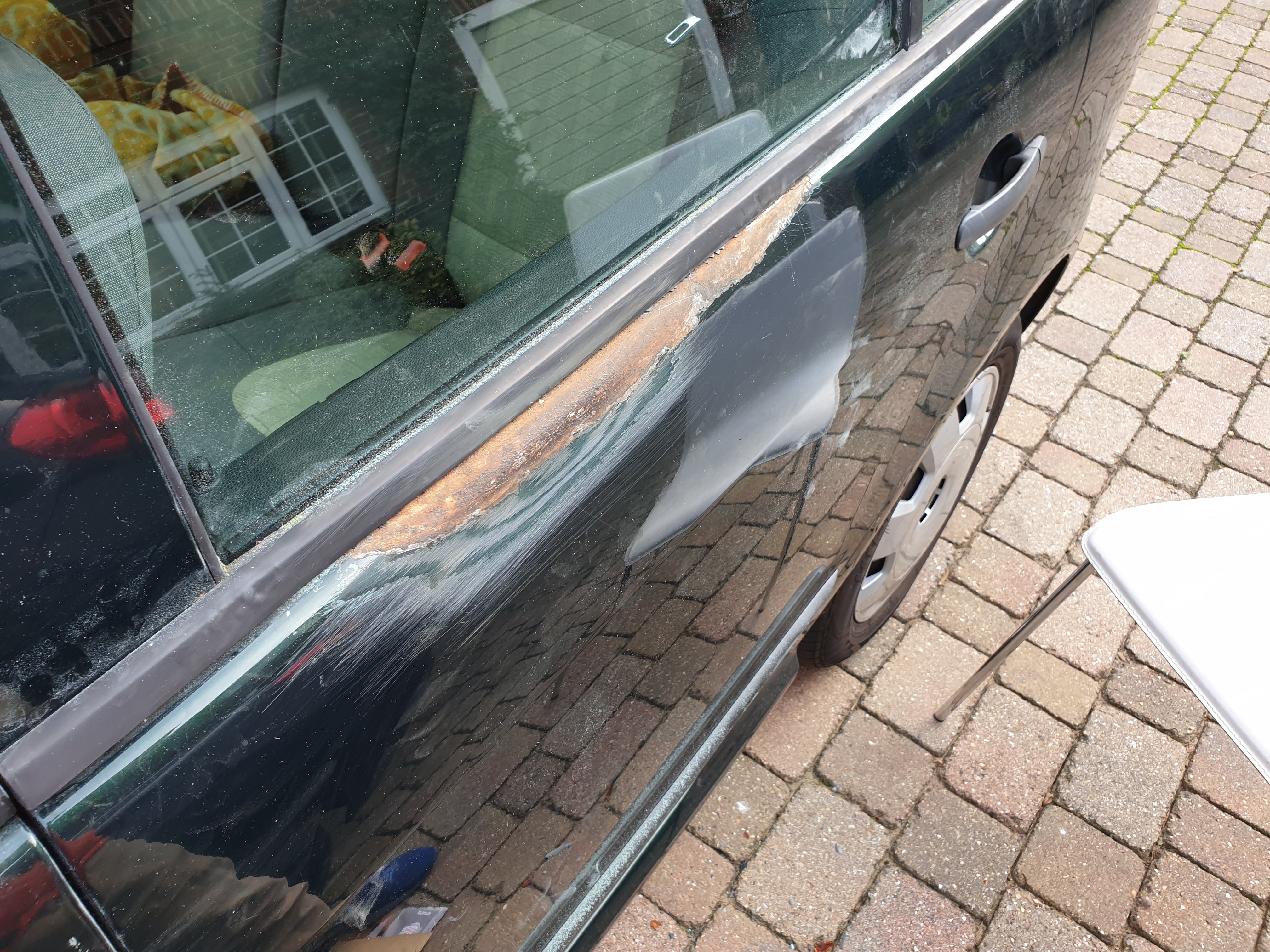

Thanks it has too small clips on the front edge of mine and the rest just pulls out. Lots more corrosion than I expected on the passenger door.
