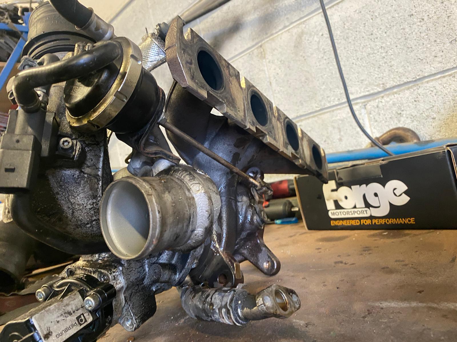

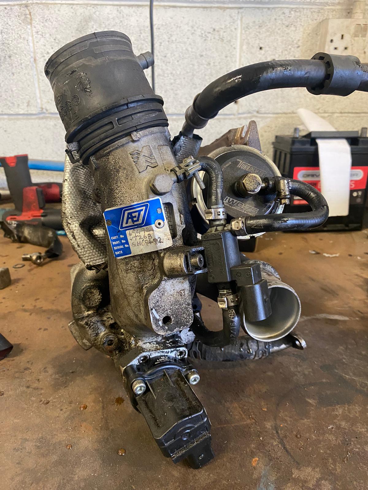

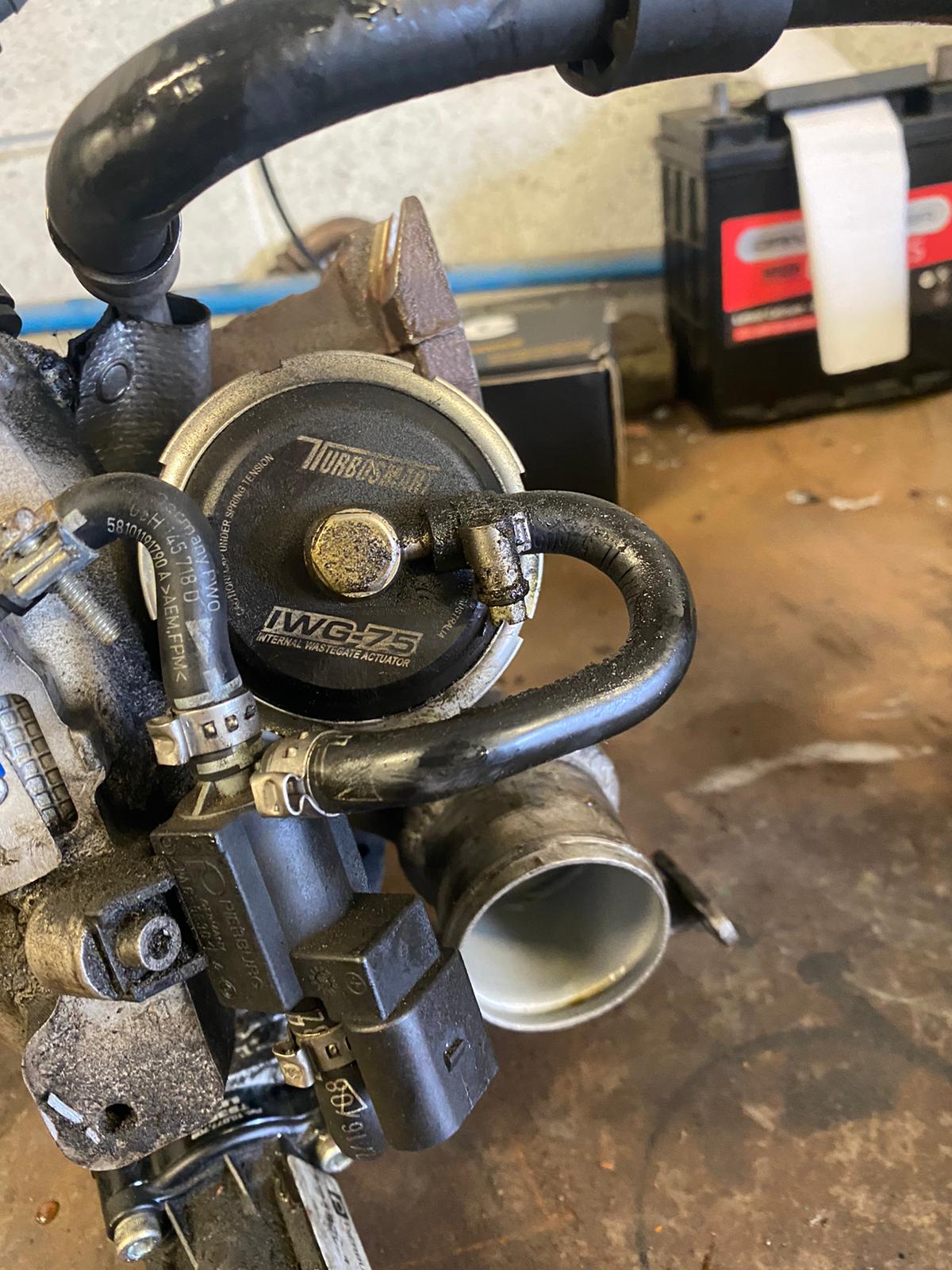

Got the turbo taken off and its an old AET VT268 based on the K04
Sending it to AET for an inspection, it seems the actuator nut was loose but want to ensure its not a seal.
Im hoping its not needing a full rebuild.
Just an update, i sent it to AET Turbos who have inspected it and basically told me that its needs rebuilding due to wear in the shaft, cost of rebuild is £714 including VAT :doh: that will the same spec around 360 - 380bhp - the hybrid turbo must be about 8 years old. So if they do rebuild it will have a new core based on the latest technology.
