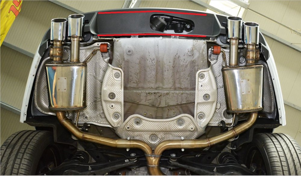

Yeah it was like a day or two that it got back to life but then stopped again. According to another owner the sensor is actually a strip inside the bumper, like in this photos:
If that's really the case there is not much to clean since the strips are not visible/accessible? Or you mean some other part?
