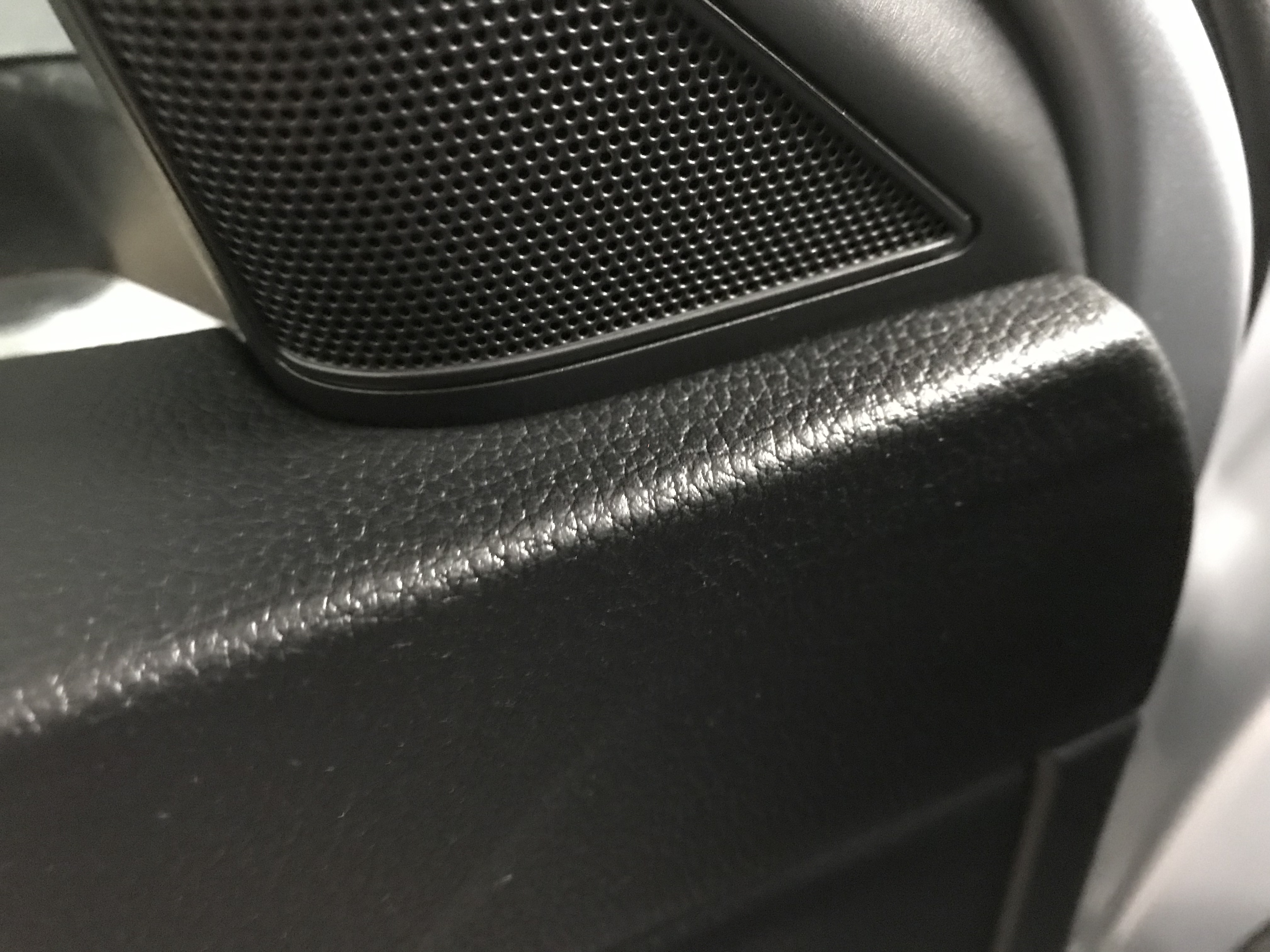

Recently became fed up with the rattles in the dash, and in the interests of avoiding stinky people at the minute, I’ve just gone ahead and fixed them myself.
So for anyone that’s suffering the same issue hopefully this helps. (My IT skills won’t)

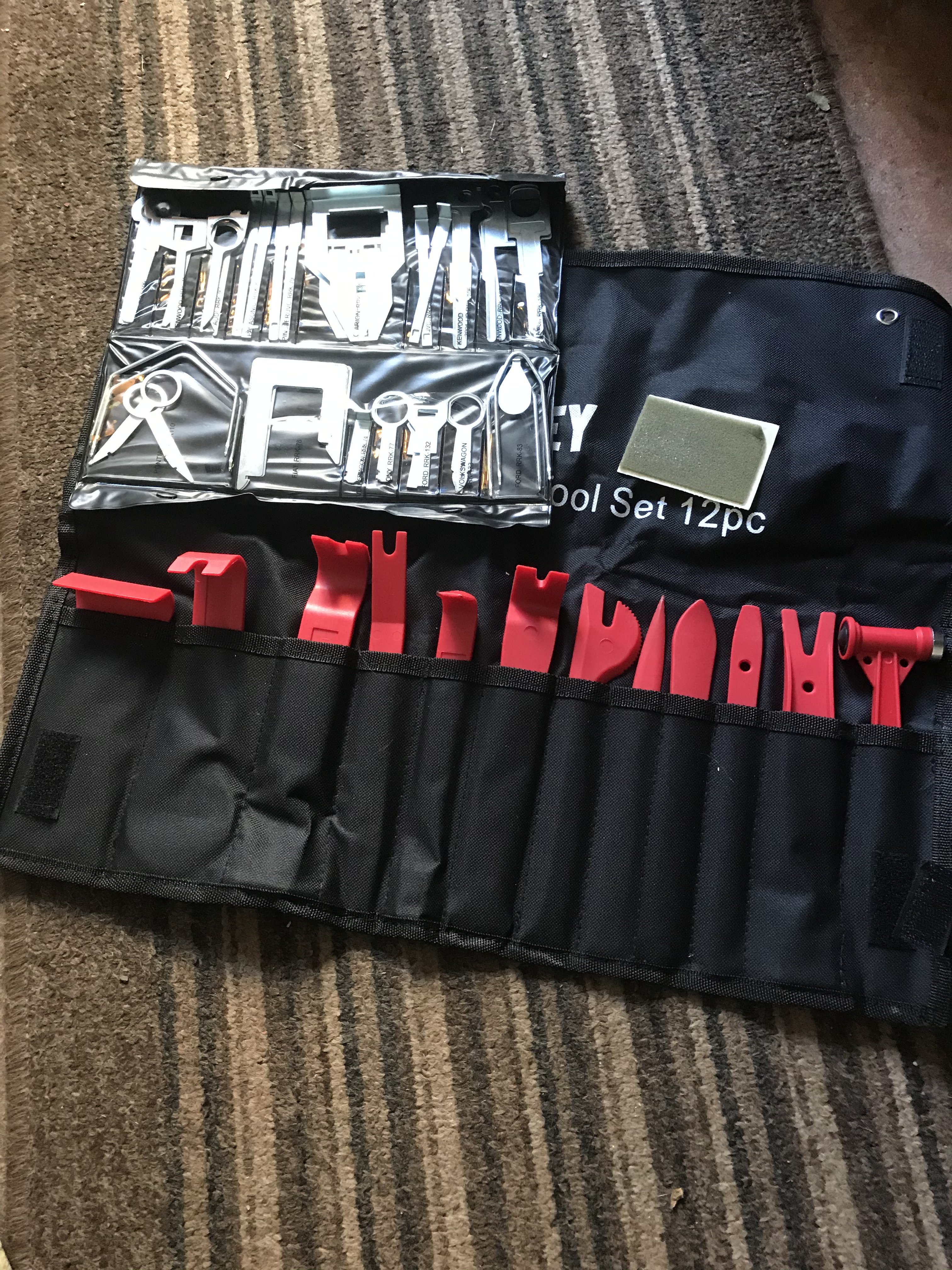

I’ll add the pics to show the tools used, which can all be bought on the bay of evil if required.

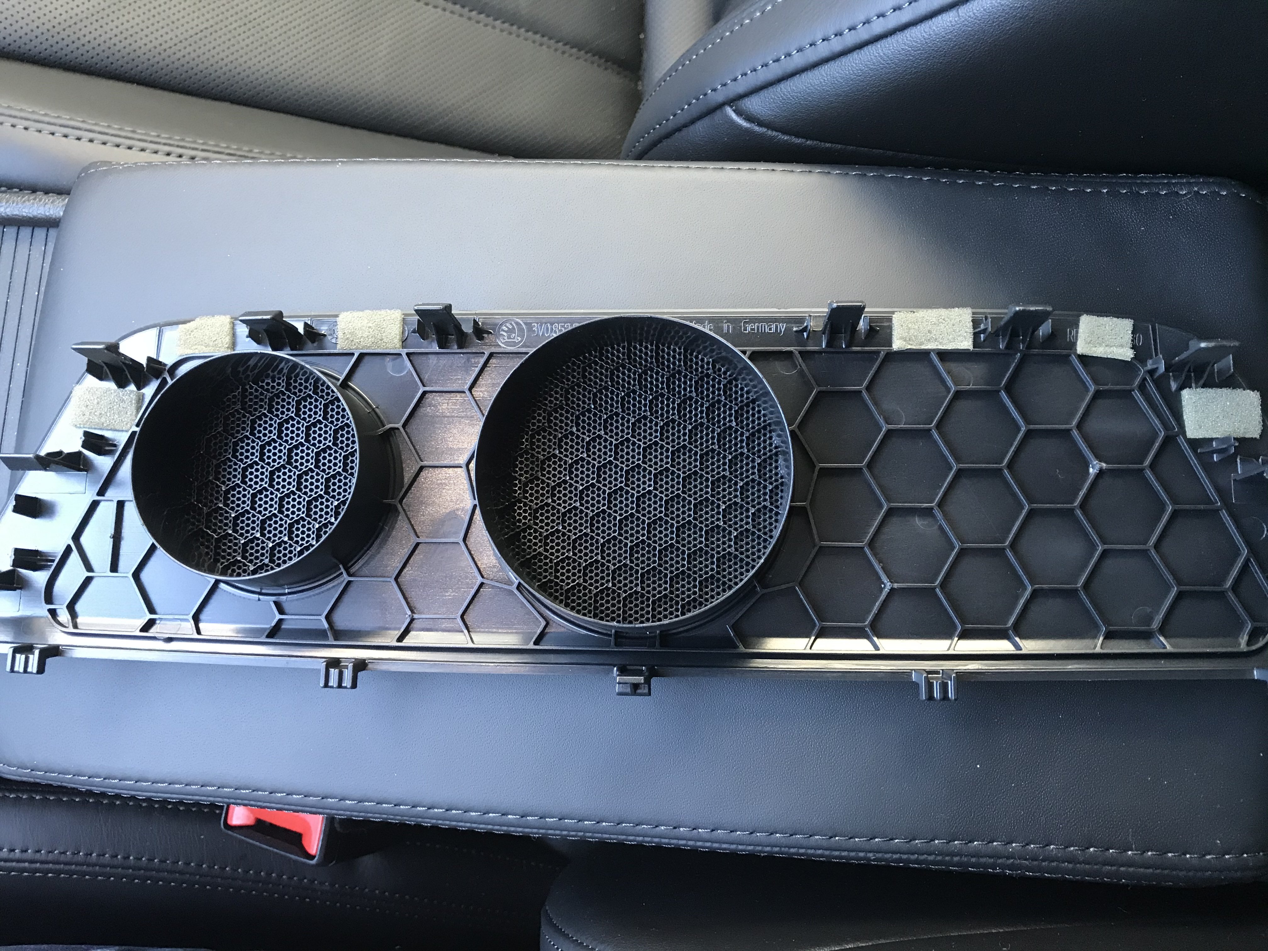

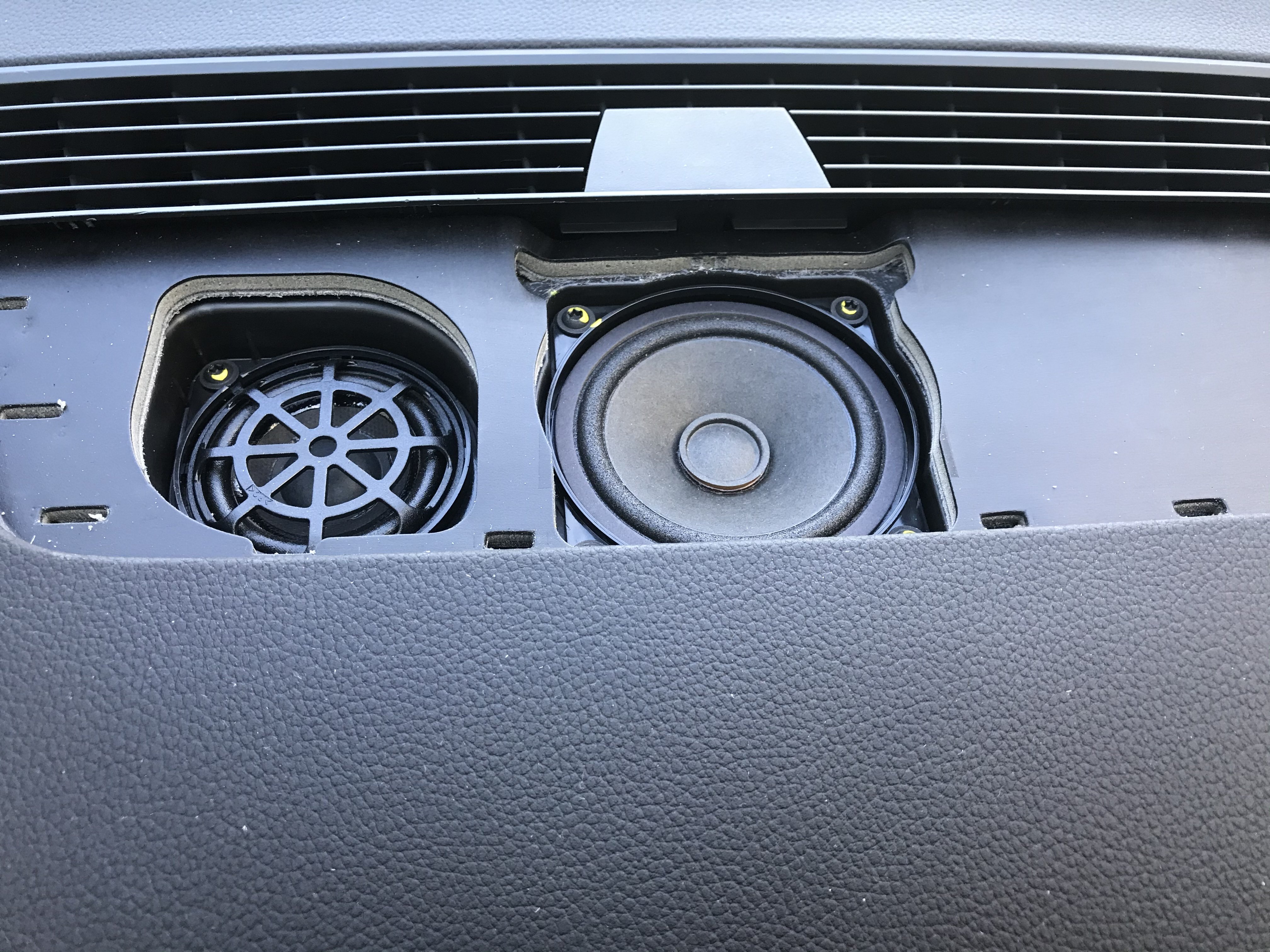

I removed the top speaker cover with the trim tools and padded. Remove the trim gently from the front first as the rear needs to be pulled away from the screen and not pulled upwards. Replace in opposite order.

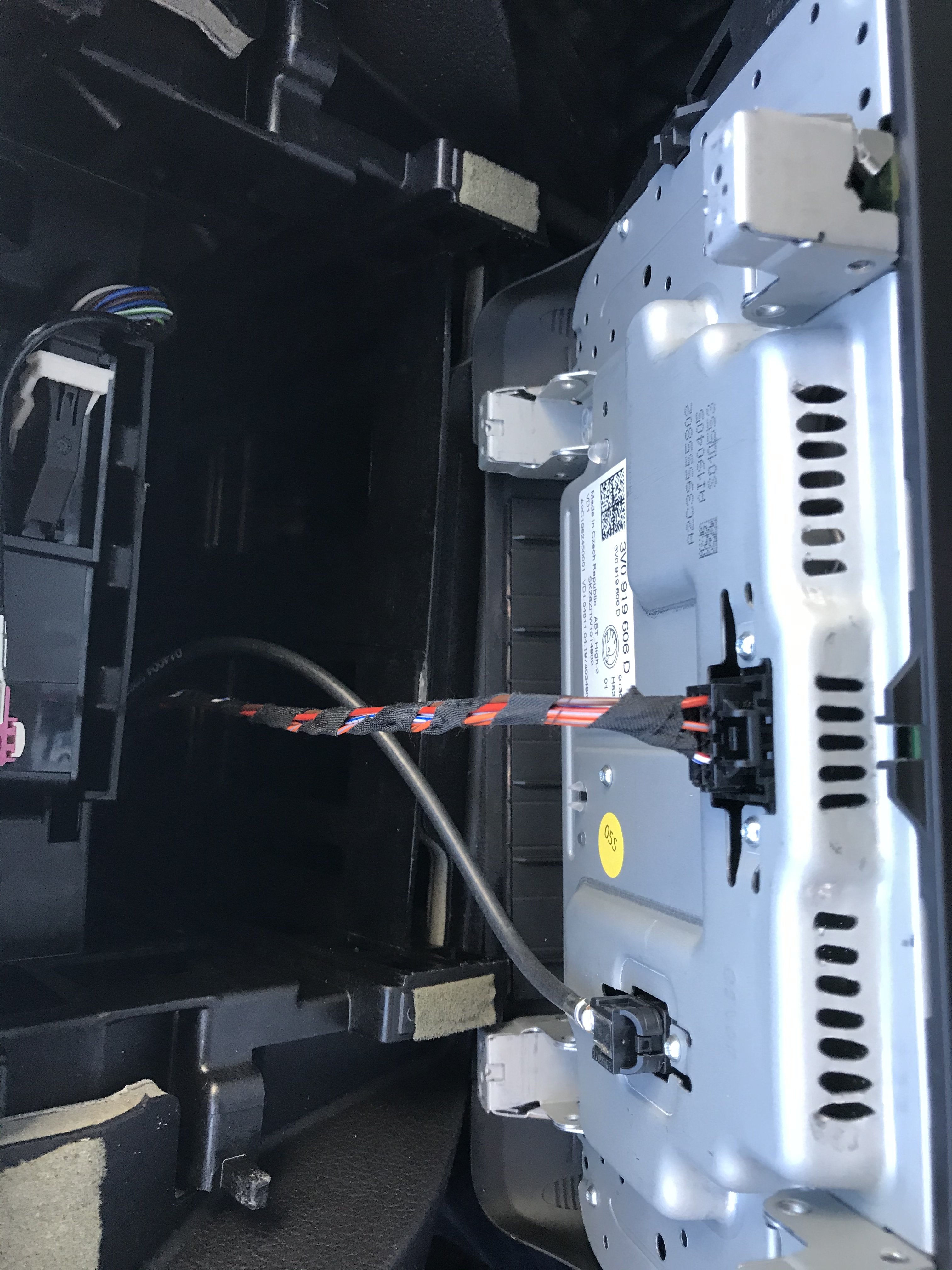

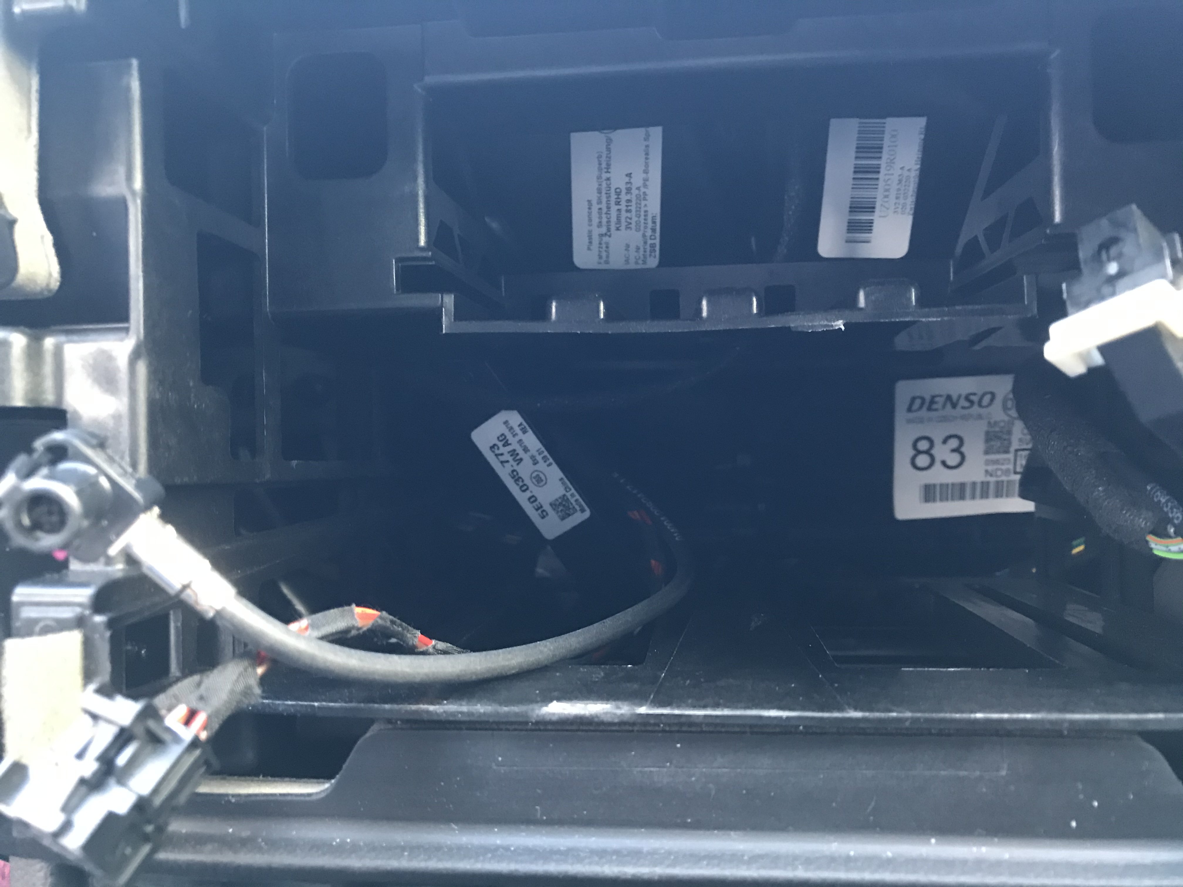

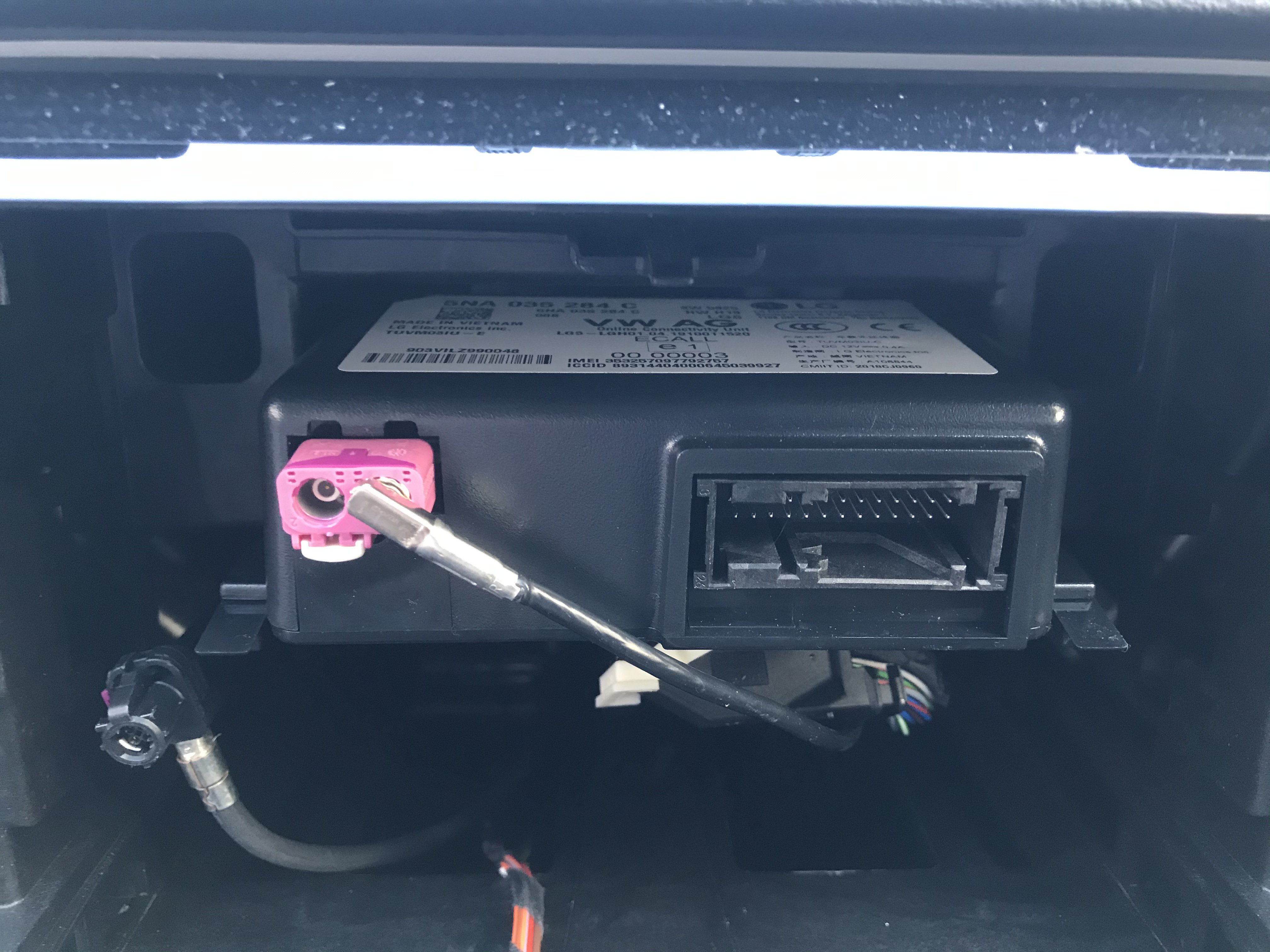

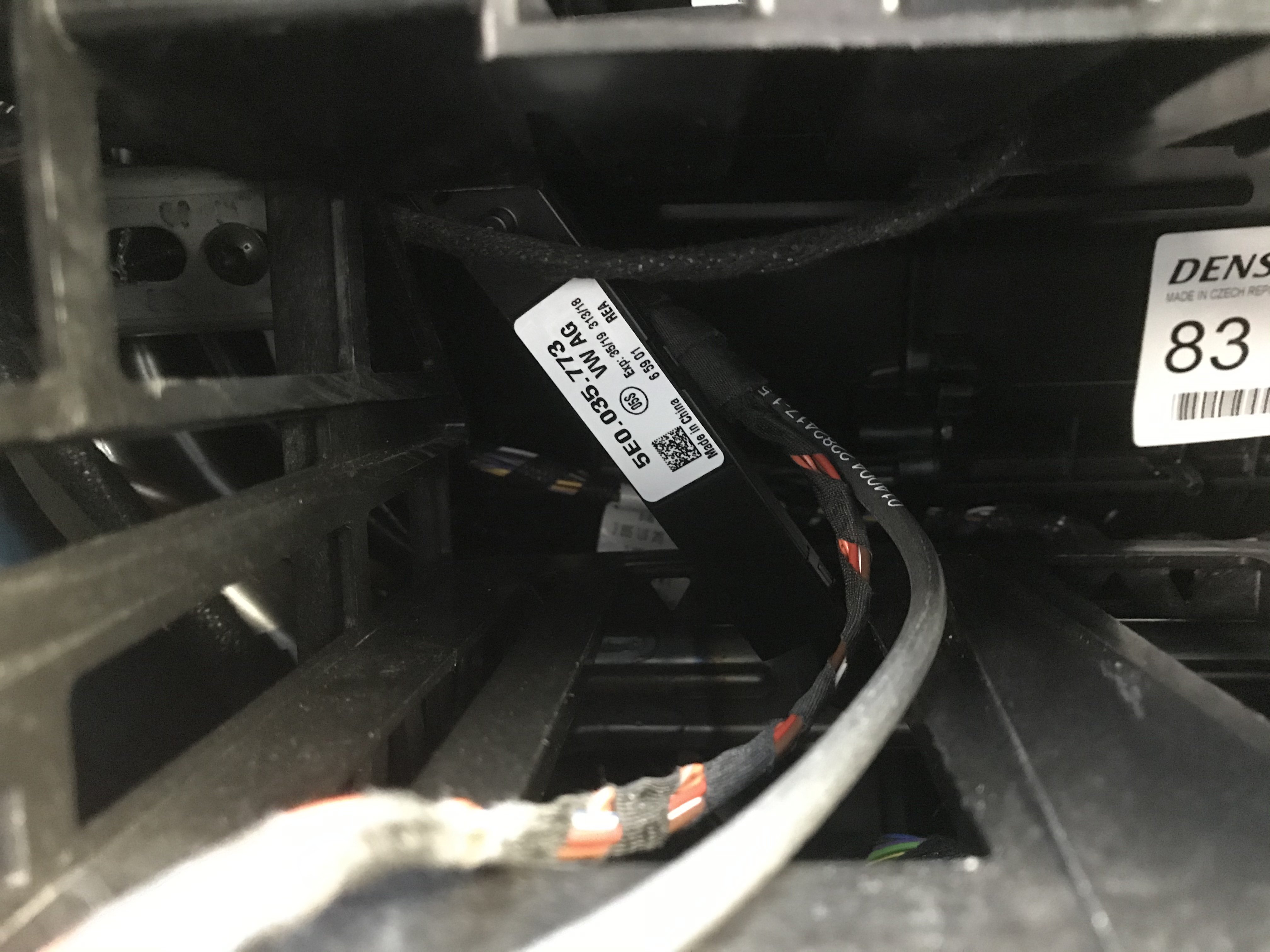

centre console rattle turned out to be the Antenna, which had come loose and was rattling about behind the touch screen.

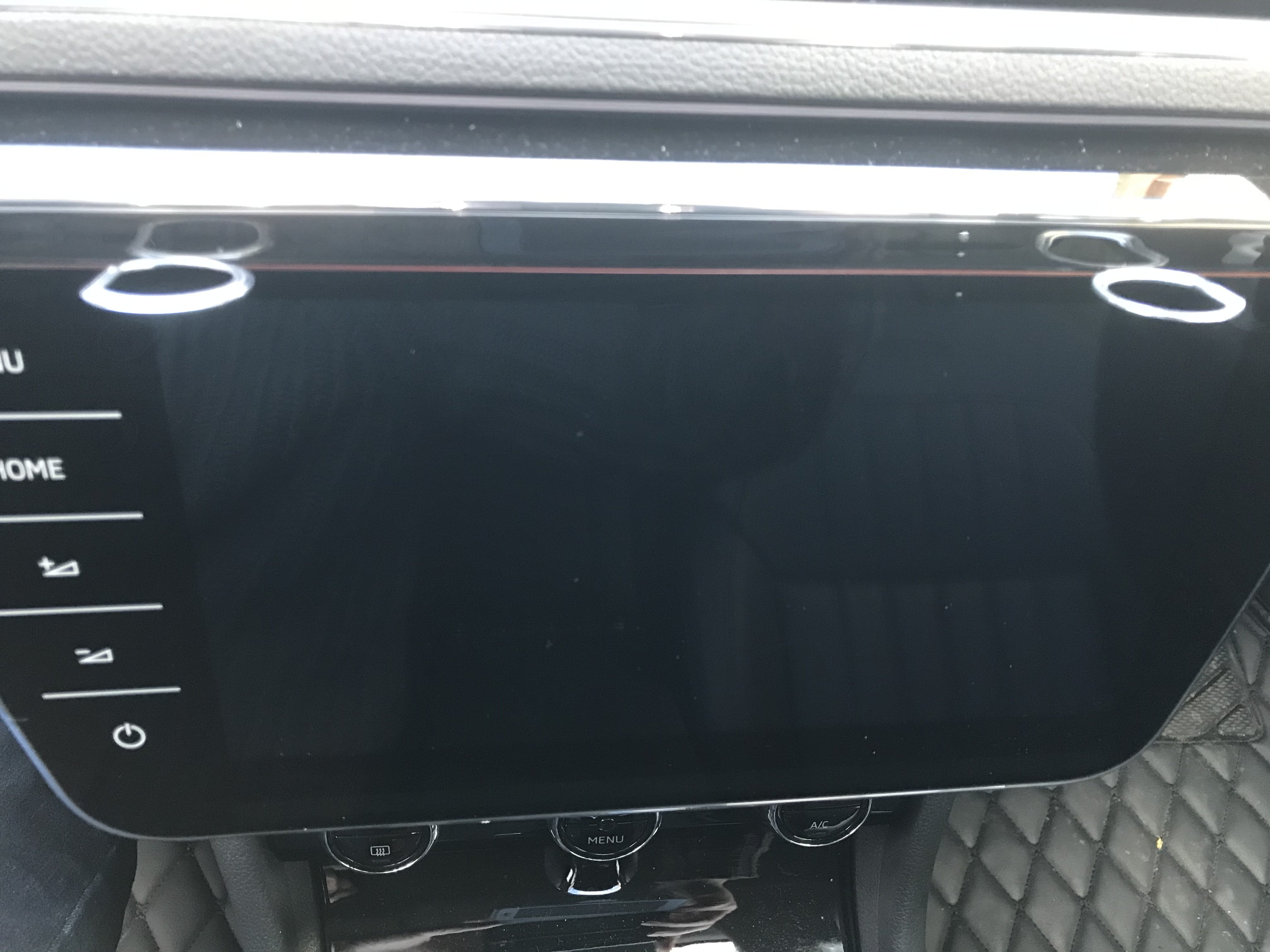

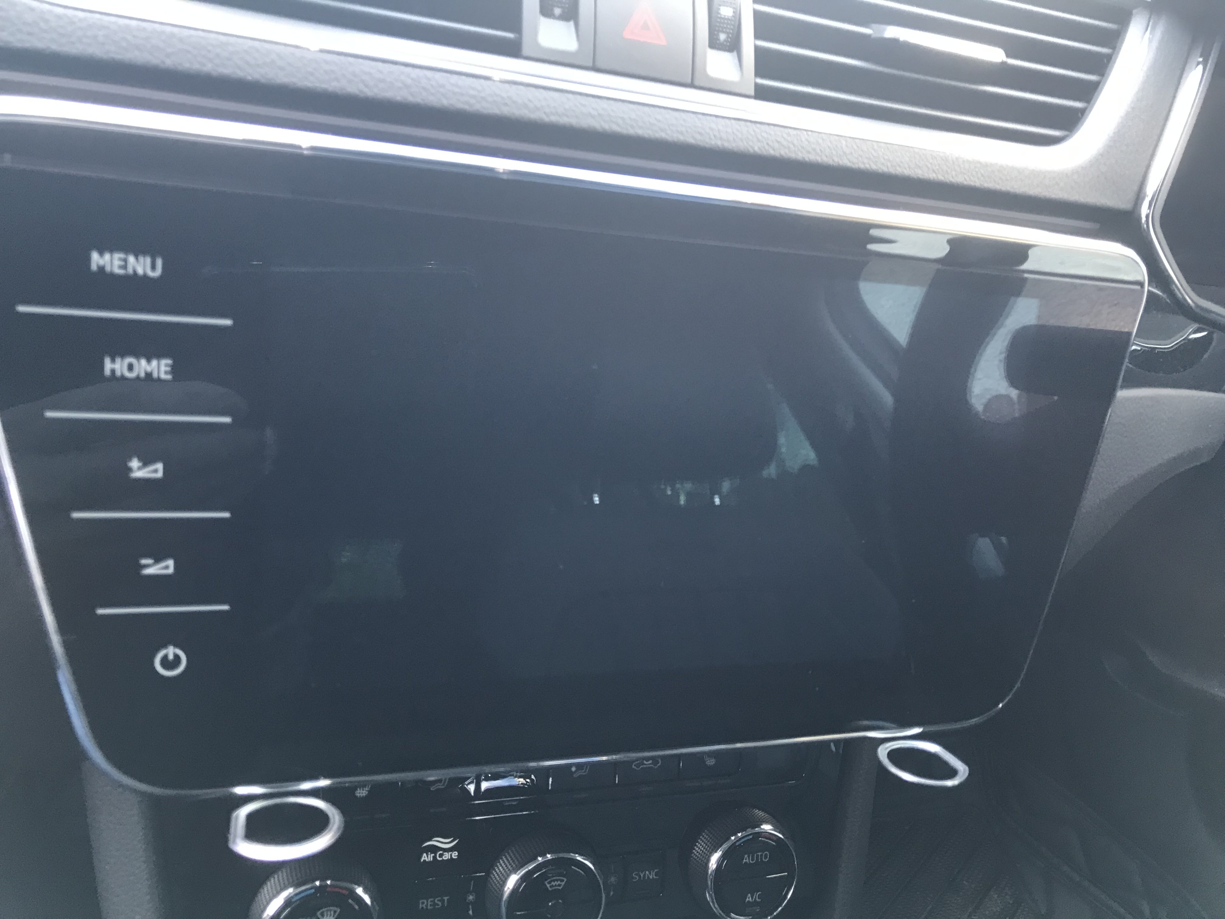

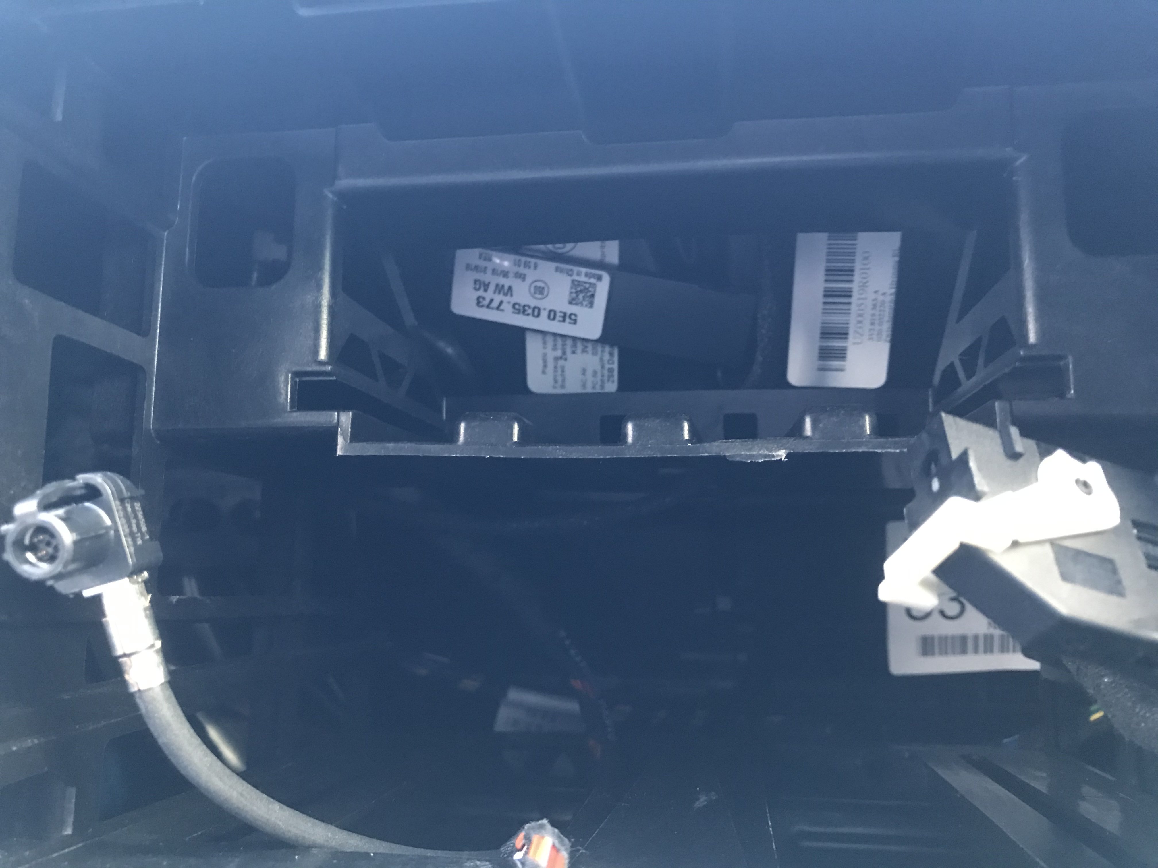

To fix this you first insert the radio keys into the 4 slots and lift unit away towards the interior. Remove the two leads on the rear and set head unit somewhere safe. Then remove the fast connector from the connectivity unit and lift the two tabs on either side to remove it completely from the dash.

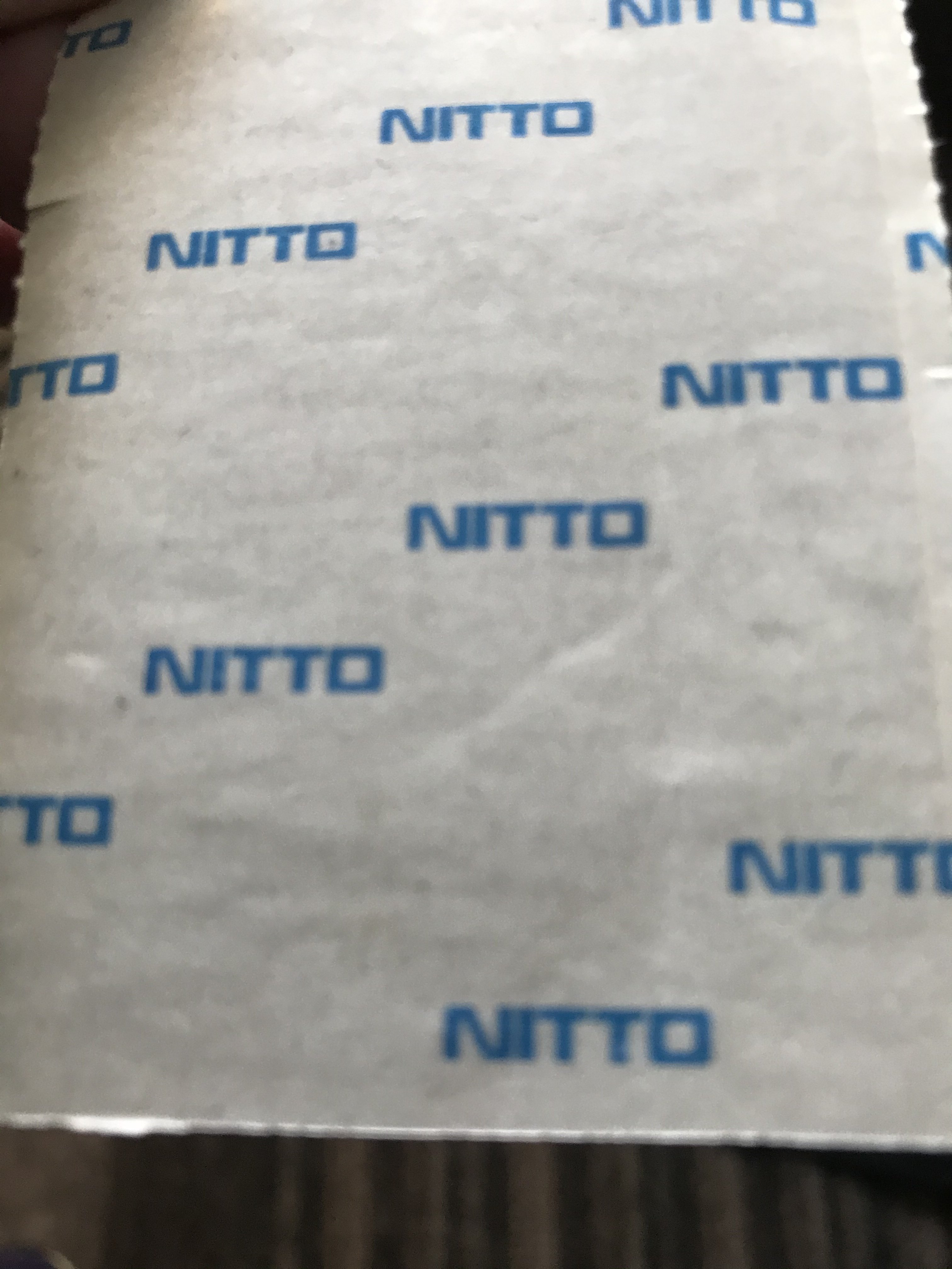

this will give you access to the antenna. I used a very strong double sided 3M tape to fix it in a location avoiding further rattles.
refit the connectivity unit and speed connector (harness). The unit just slides into place and clicks in tight.

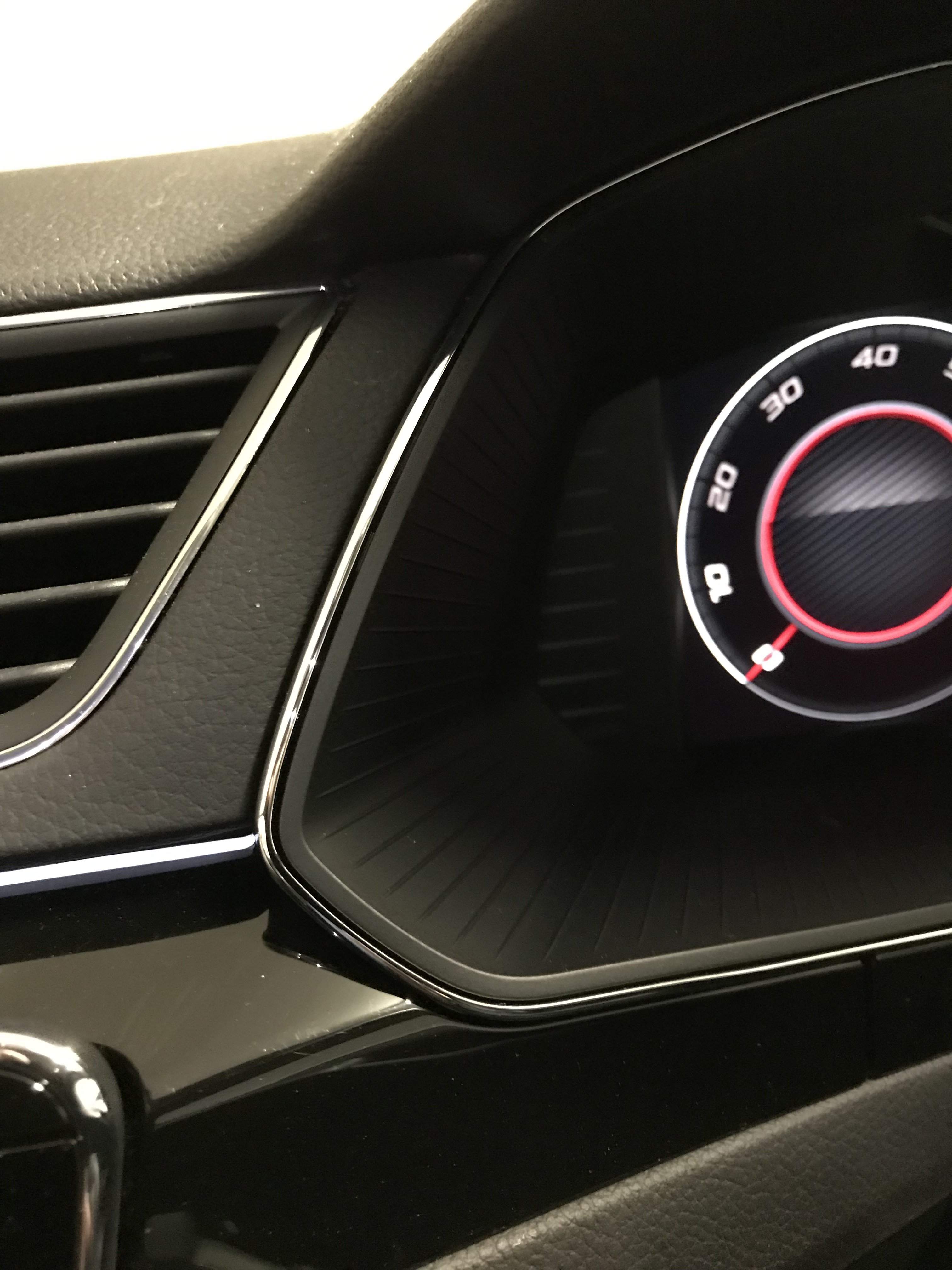

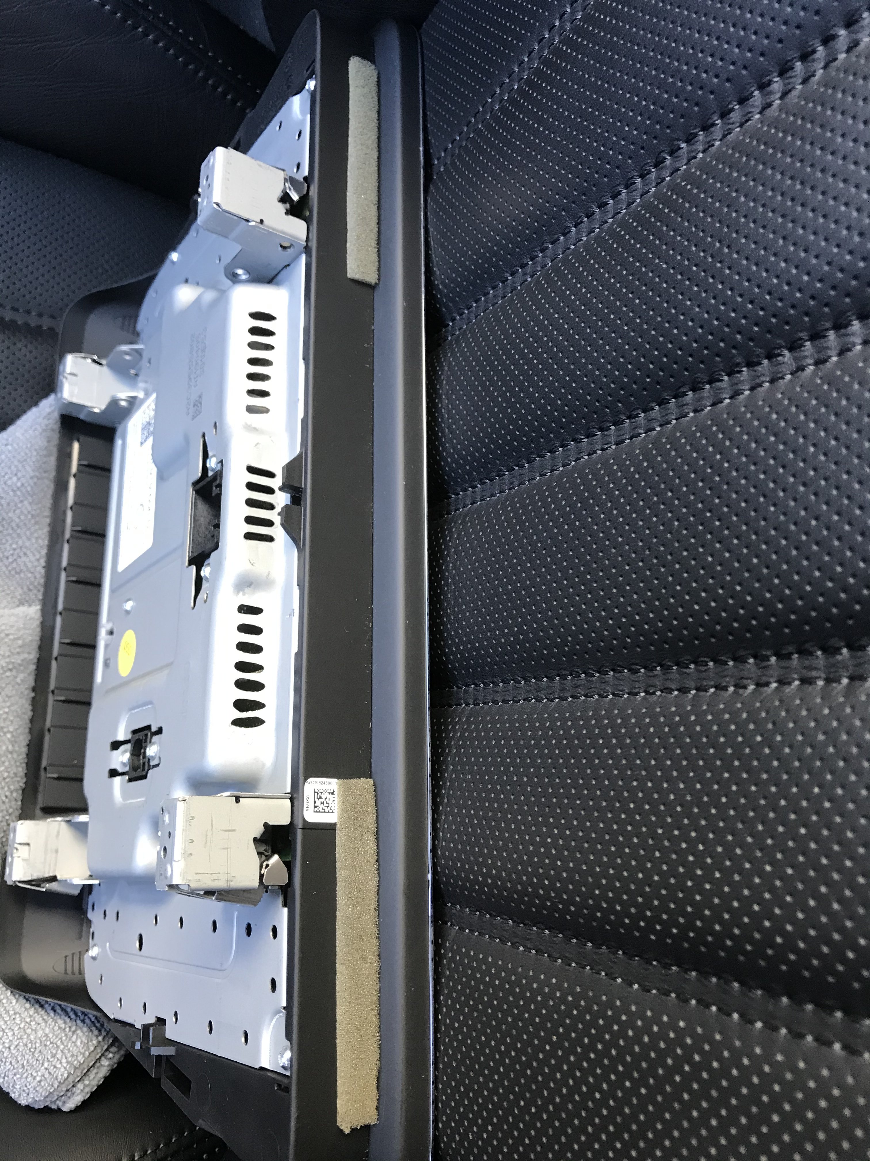

On the frame for the screen mount, I’ve padded several touch points just to be sure, and again on the top edge of the screen itself, as this touches the dash trim strip slightly and can vibrate.
Replace the two fittings into the rear of the screen and refit into its location in the dash. Listen to make sure each corner clicks home and locks in. Just be careful applying to much pressure to each corner just incase. I’d hate to see a cracked screen.
Think that makes sense. Hopefully the photos will help.
Think I’ve to upload separately to avoid hitting limit. I hate this interweb nonsense.

Exactly the same issue with my 2019 Superb executive.
Rattle and vibration from behind the screen on coarse road surfaces usually at motorway speeds.
Removed the screen and the GPS antenna was hanging down exactly the same as in your picture
Attached it  as described with 3m double sided tape and the rattle has gone.
The original adhesive must deteriorate after a couple of years with the heat on the dashboard.
Thanks for the info,  the rattle was really annoying previously.
A timely topic. I've got a rattle on my 2017 L&K which I thought had gone when the main dealer said there were some loose heat shields, but it's still there at just under 2k rpm which is when the car changes gear when taking it easy. I think it's in the driver's door but not too sure. Also, any recommendations for toolkits for removing panels would be appreciated.

Rattles in doors on both sides of mine were from grill trim just above the door panel. I padded them very lightly. Just enough to stop them rubbing off the door panel. One of my other buzzing noises was coming from the clocks, where it meets the dashboard. Again, padded and refitted.
