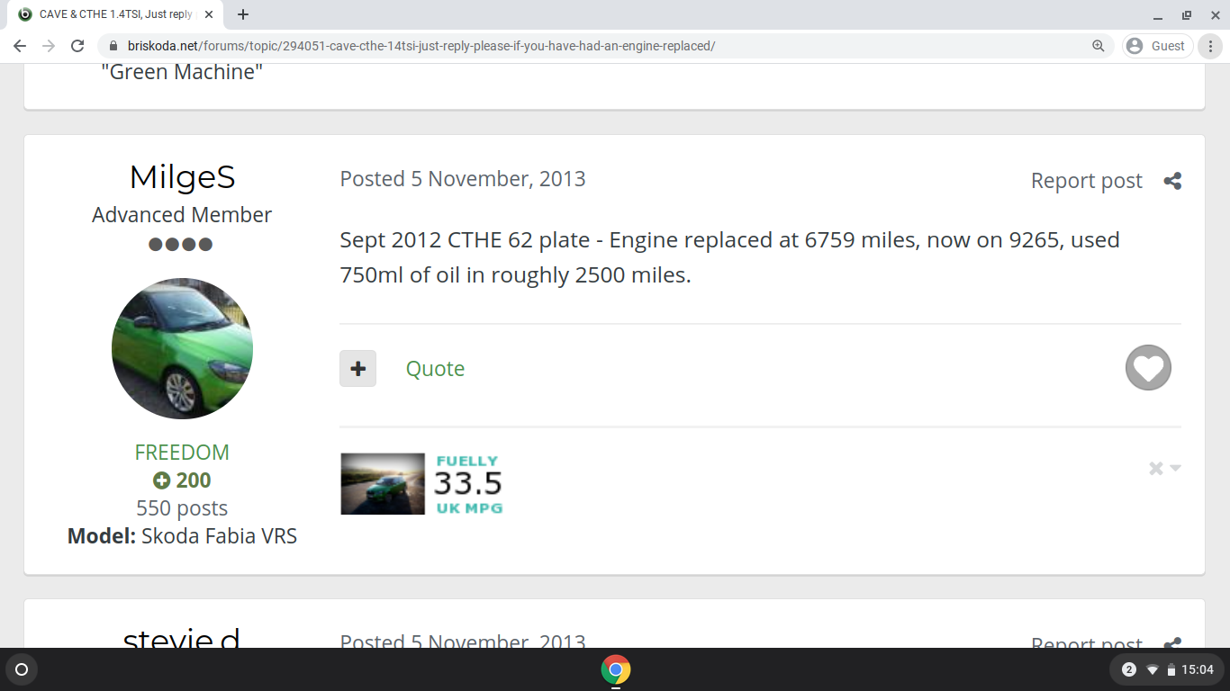

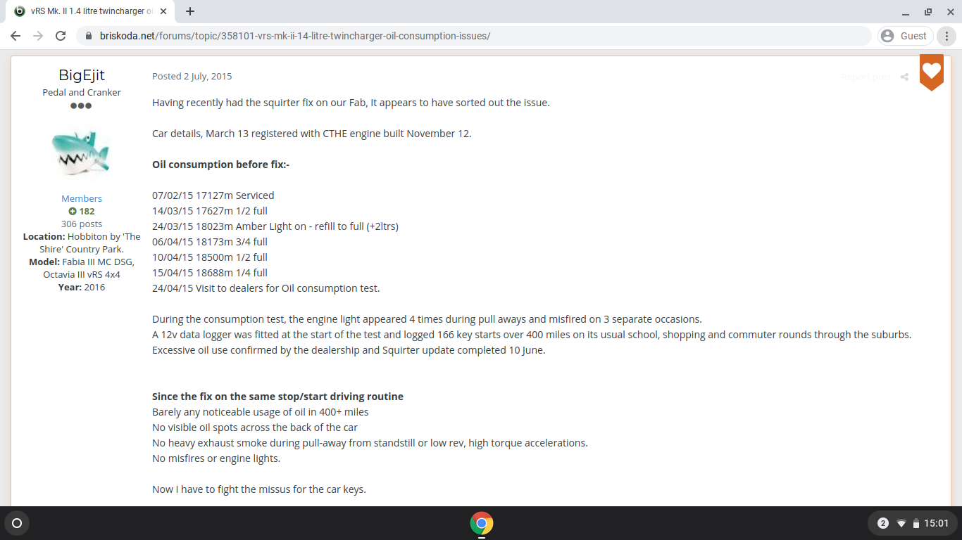

Didn't realise about problems with the early CHTE engines. So what did they change on the Early CHTE engines that's different to the later CHTE engines?
The Software, because they had to delay the delivery of SEAT Ibiza Cupra in 2013 once they had started production again in 2013 and there were 'issues'.
Then strangely a member here got a early CTHE and they still did a Breather Mod and fitted the Oil Spray Jets when it used oil.
What is strange about that is how did it leave the factory without the Updated breathers that were being retro fitted for over a year before they stopped building the CAVE's.
Here is another one, not the one i meant.
EDIT, the bottom one is.
They did Breather Update and Squirters before then replacing the engine.

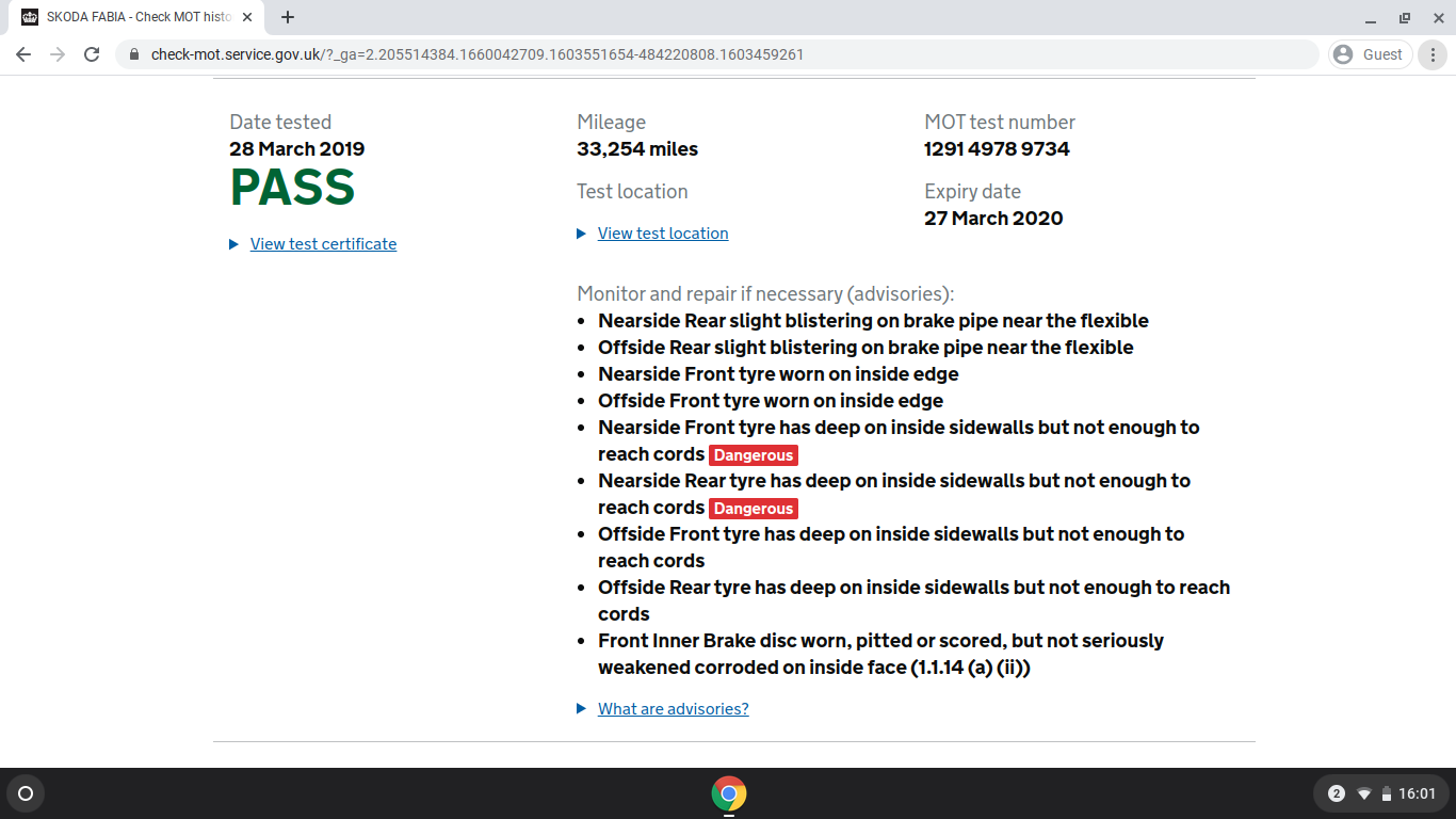

Where are you buying from, is it a trader?
Go on the condition now and the low miles.
Checking what Discs and Tyres it got, and the first 3 years history and any more recent.
It maybe got treated better and looked after better in the last 9,000 miles / 18 months than before those.
Edited by e-Roottoot
