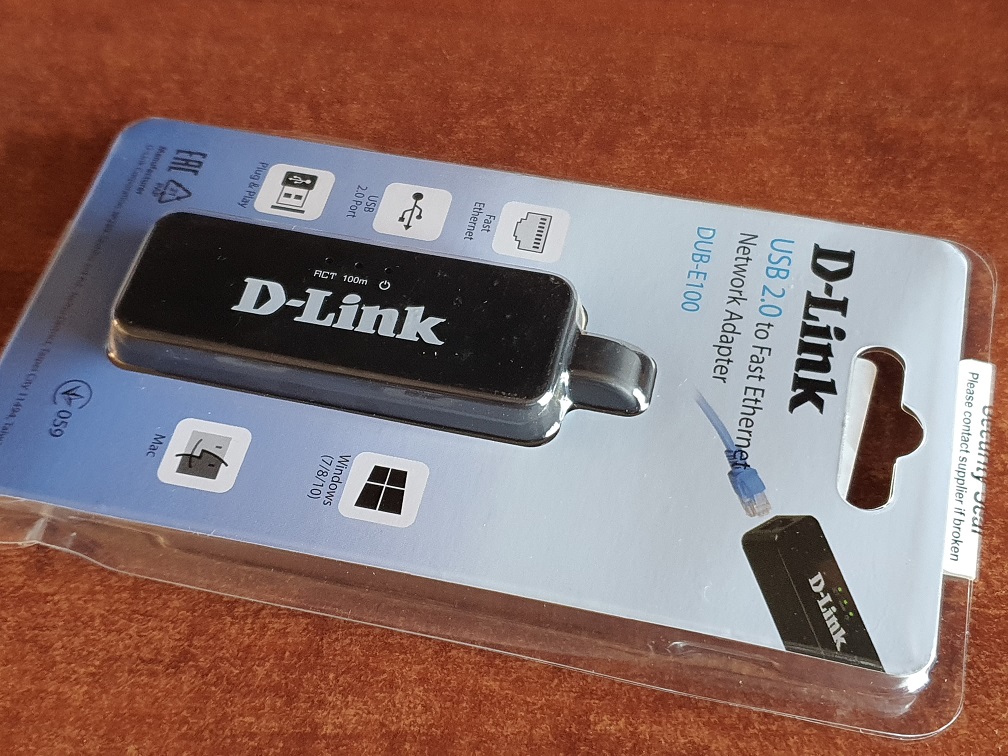

Can we use the USB port for flashing?
Can you please elaborate more on the connection of the d-link
where it should be connected
The problem is, you will use USB port on your car (in the midle console) to connect D-LINk so you need another port like SD or may be CD from where you could grab the files (i am not sure with CD but is easy to check) but with CD you will not have a chance to copy your original files from MIB.

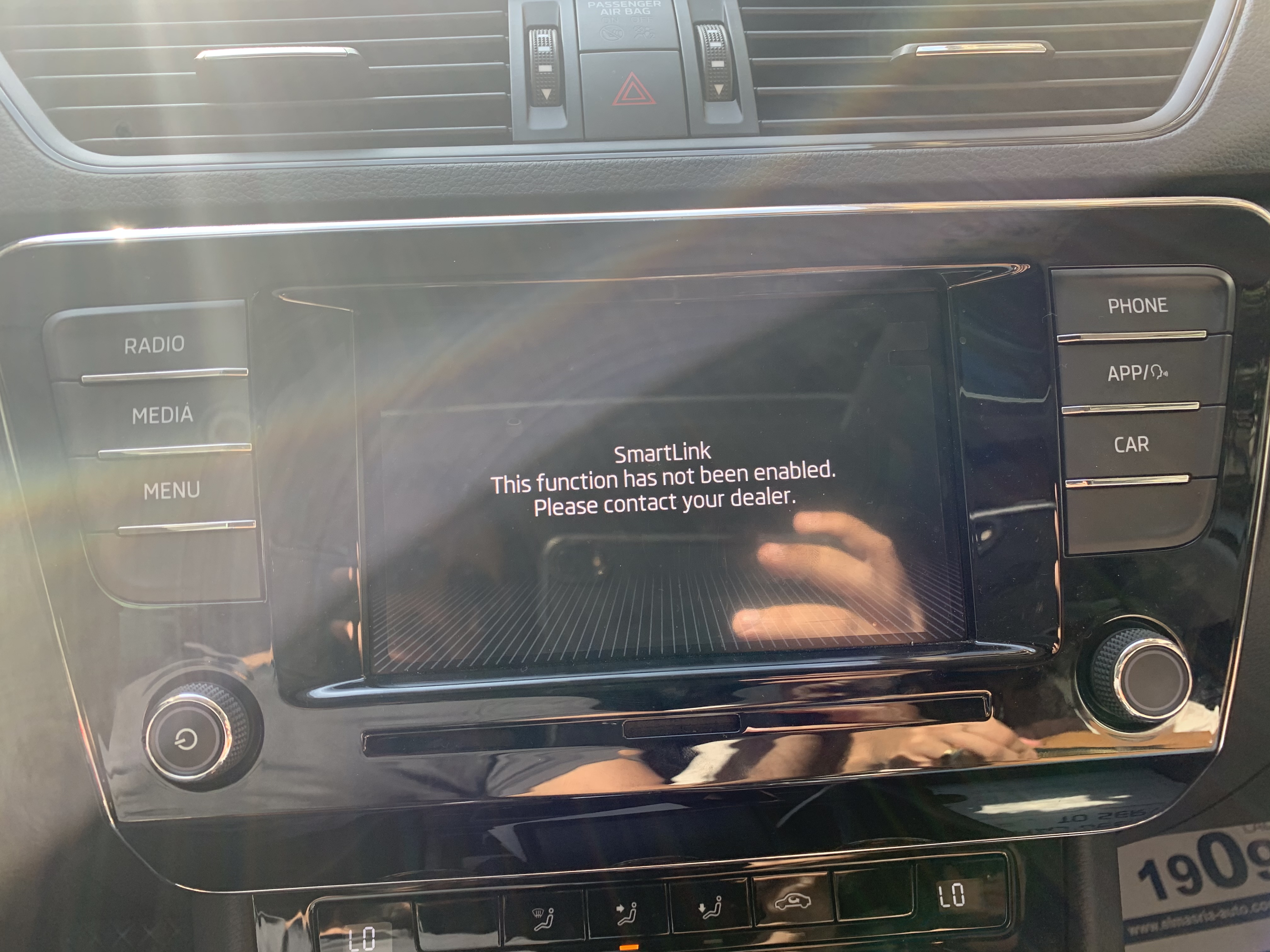

I had to get Smart link enabled by showing ID and proof of ownership at the dealer - although most of the staff had no idea, one guy was the expert and I had to see him - for me it's a waste of time. Never used it other than trying it, I certainly wouldn't pay a subscription. Car play or Android auto work, they provide enough options for most. I thought I might use remote locking but never did.

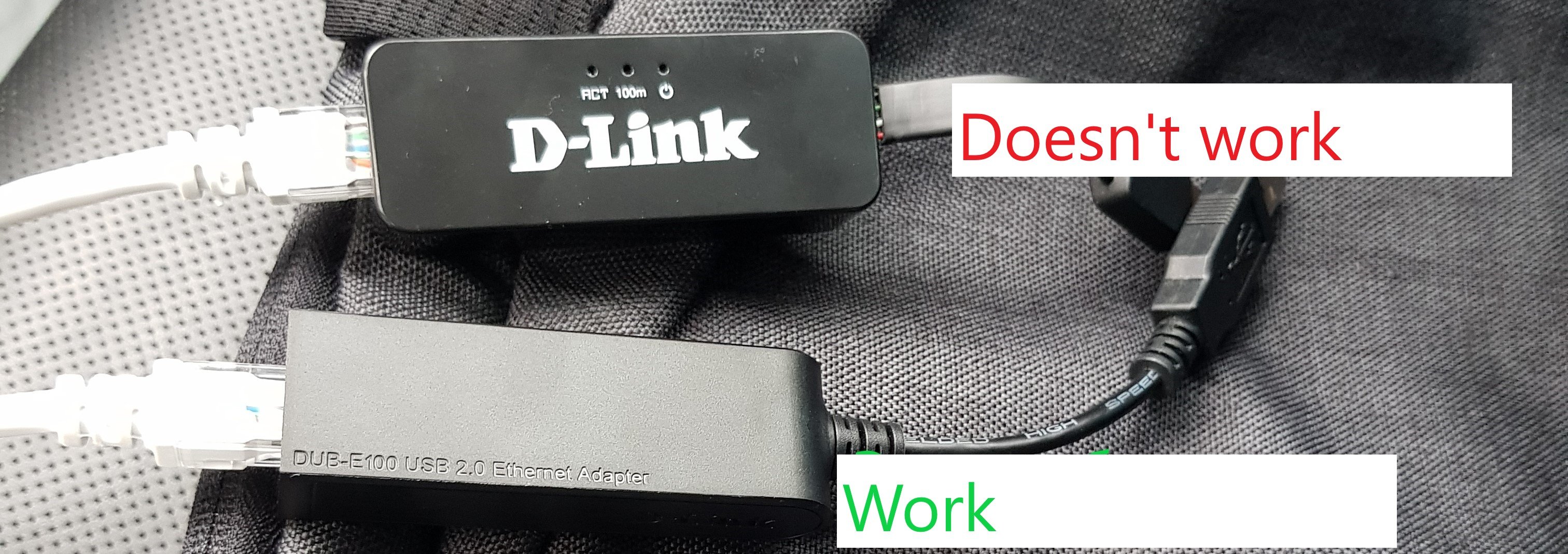

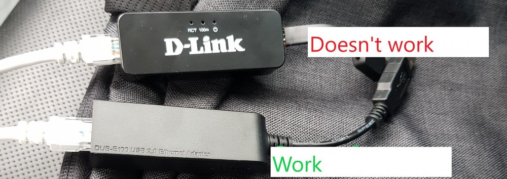

yesterday had to return without unpack :(
pictures in product description gave false hope
4 minutes ago, MartiniB said:
thanks for info!
Unfortunately for all sellers both of them are the same, and the could not understand why you need this particular one.... the good one has a paper box
