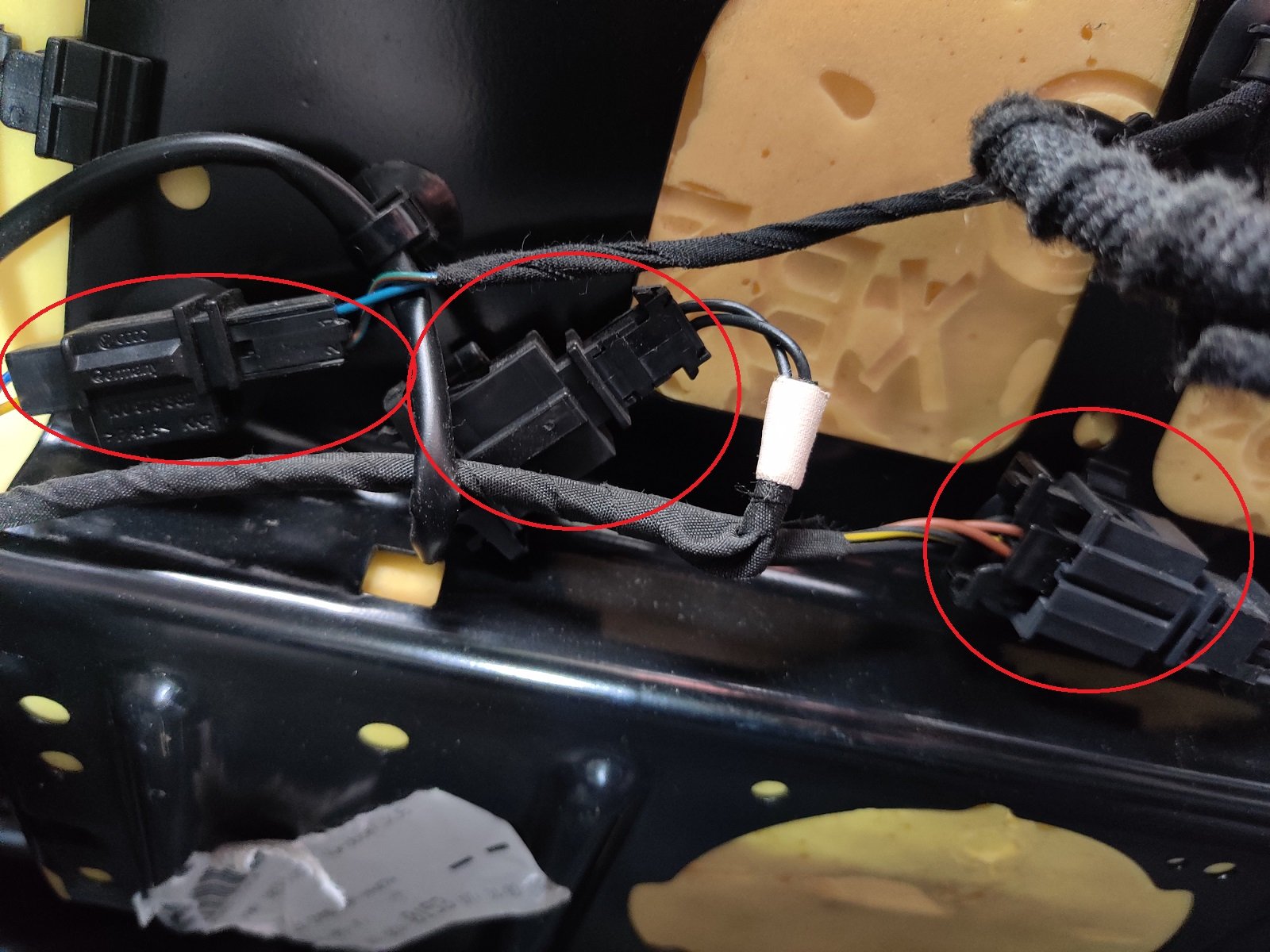

Seat tilted now, and I found no less than 3 connectors :)
Off to see if I can find a wiring diagram. The fault code specifically says "igniter". Perhaps one of the cable bundles is for that exact purpose.
I suggest you locate the leads coming from the airbag in the side of the seat and follow them down to the connector. I did this as a double check before cutting the wires.
There is only one cable bundle going to that part of the seat which is actually labelled "air bag" (facing the car's side/door). This cable comes from that yellow connector in front of the seat (the one I cut off and wago'ed), with no additional connector under the seat.
The cable bundles from the three connectors found under the seat (see photo above) are all going to the opposite side of the seat (towards the car's center).
I plugged out and back in again all connectors I could find (2 in front of the seat, 3 under the seat). The problem stays the same.

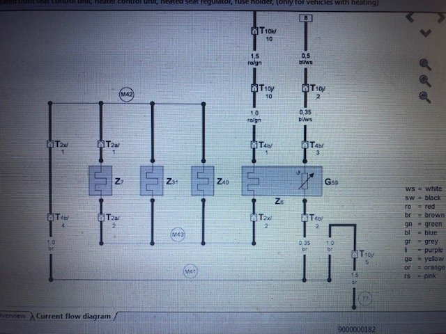

@MariusMo the three connectors in your earlier post are for the seat heating nothing to do with the airbag

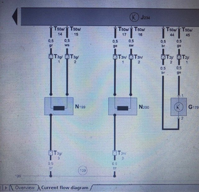

I am starting to suspect that this might be the real thing. I.e. the igniter is in fact dead, and has to be changed.
I measured the electrical resistance on the yellow plug (that I cut off): Not broken.
This is the Airbag wiring diagram
The seat heating and you'll see the two 2 pin & one 4 pin connectors
