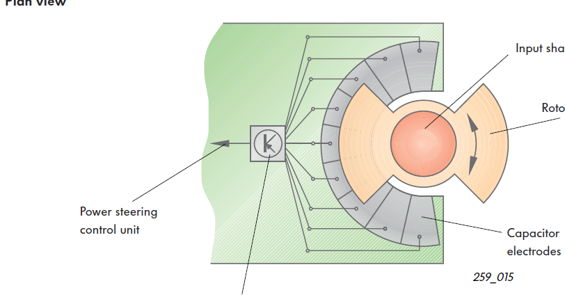

It says this:
The power steering sensor G250 is located at
the top in the steering gear and surrounds the
input shaft of the steering gear. It detects the
steering wheel angle and computes the
steering angle rate. It is not an absolute angle
sensor (steering wheel angle proportional to
steering wheel lock)!
Later it shows a diagram of the capacitive sensor:
I guess, looking at that it can tell angle by which of the 9 plates in the semi-circle on the left are covered by rotor, given an initial lock-to-lock calibration or something,
Was any such calibration done by you after installation?
TRW systems use the above capacitive sensing technology, Koyo systems use completely different hall effect technology.

I still don't know for sure what comes out of the G250 sensor, cos although it appears to be able to infer the steering wheel position/angle, I'm not sure why it would need to.  Possibly something lost/added in translation from the German.
I've not seen reference to PAS 'strength' being related to what angle the steering wheel is at, only to how fast it's being turned and vehicle speed.  The hydraulic mechanisms nearby automatically sort out the direction the fluid should be pumped to give assistance the right way.
Also, in VCDS you can see 'angular velocity'/turn rate in a measuring block, but I'm reasonably sure I've never seen 'steering wheel angle'.
So I think the output of the G250 sensor is probably a simple PWM signal of 'turn rate'.
