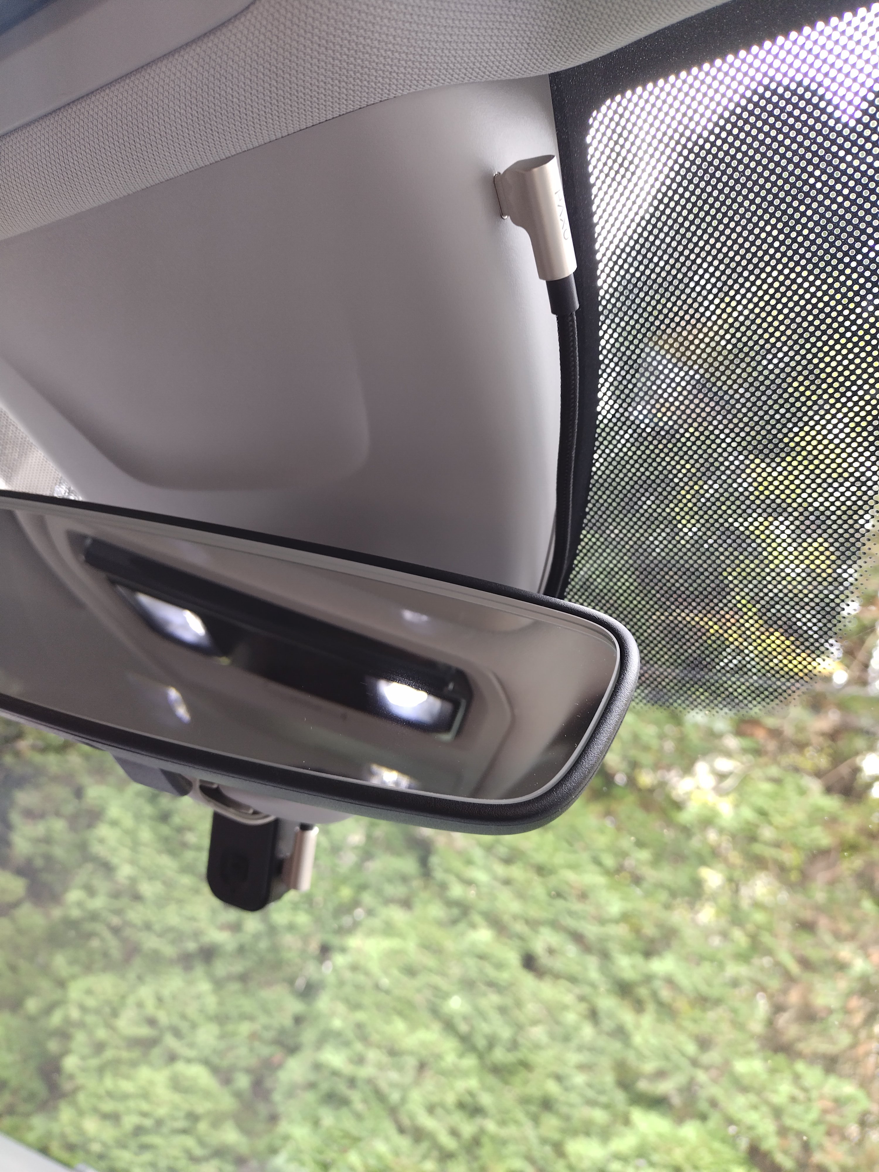

I bought a 90 degree ‘elbow’ to reduce how much it stuck out, routed toward the passenger / near side and just wrapped the excess cable a few times around the mirror stalk and cable tied. Probably a 60 -80cm cable?
Even with a short, 90degree cable I still thought it untidy so hard-wired the power in.

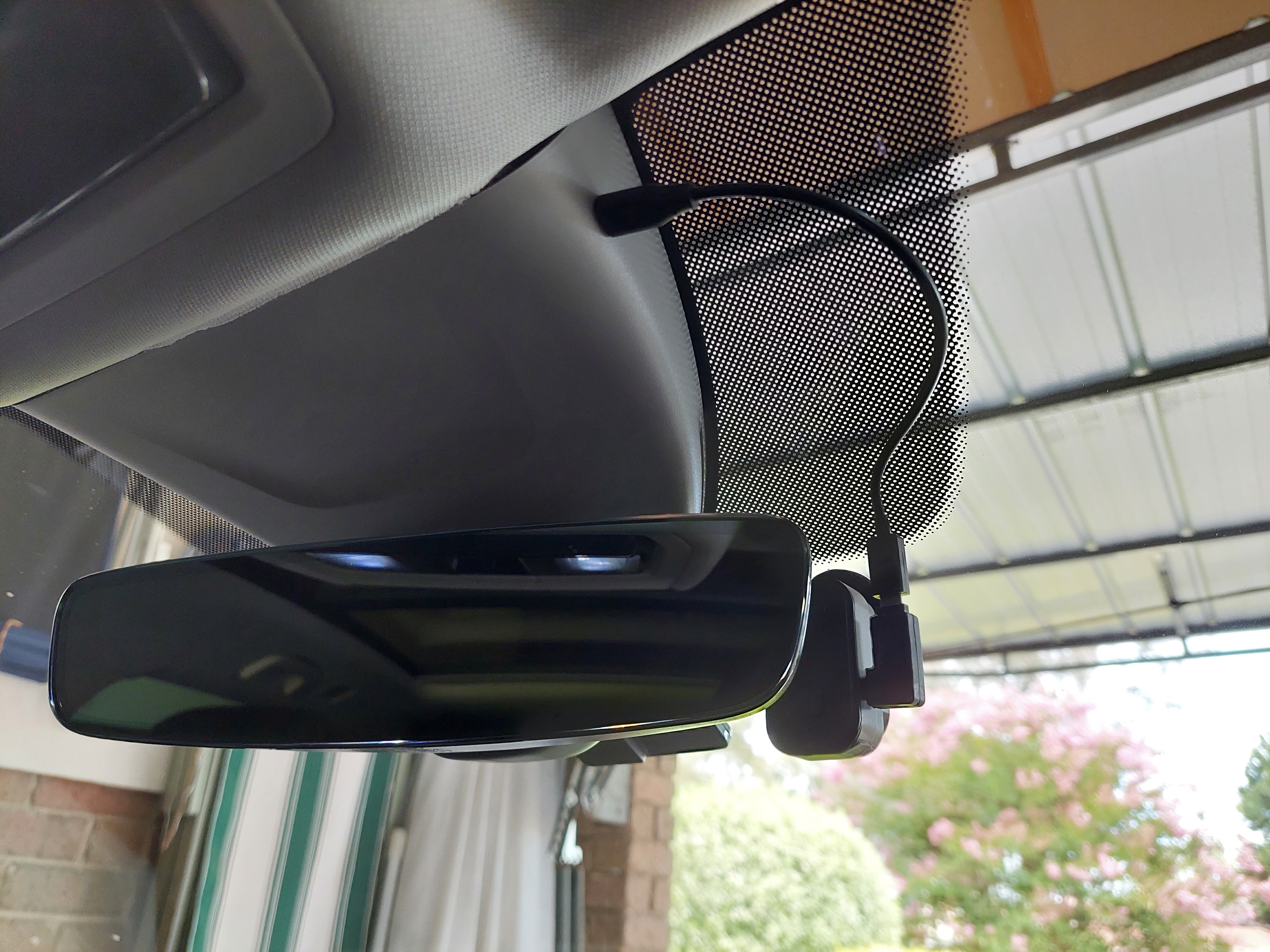

While the mirror C socket is designed for LHD, my Garmin Mini 2 is apparently designed for RHD (that is if it were to be mounted on the passenger side). Anyhow, it's tiny enough to fit neatly behind the mirror on the driving side, but needed an elbow at the device end.

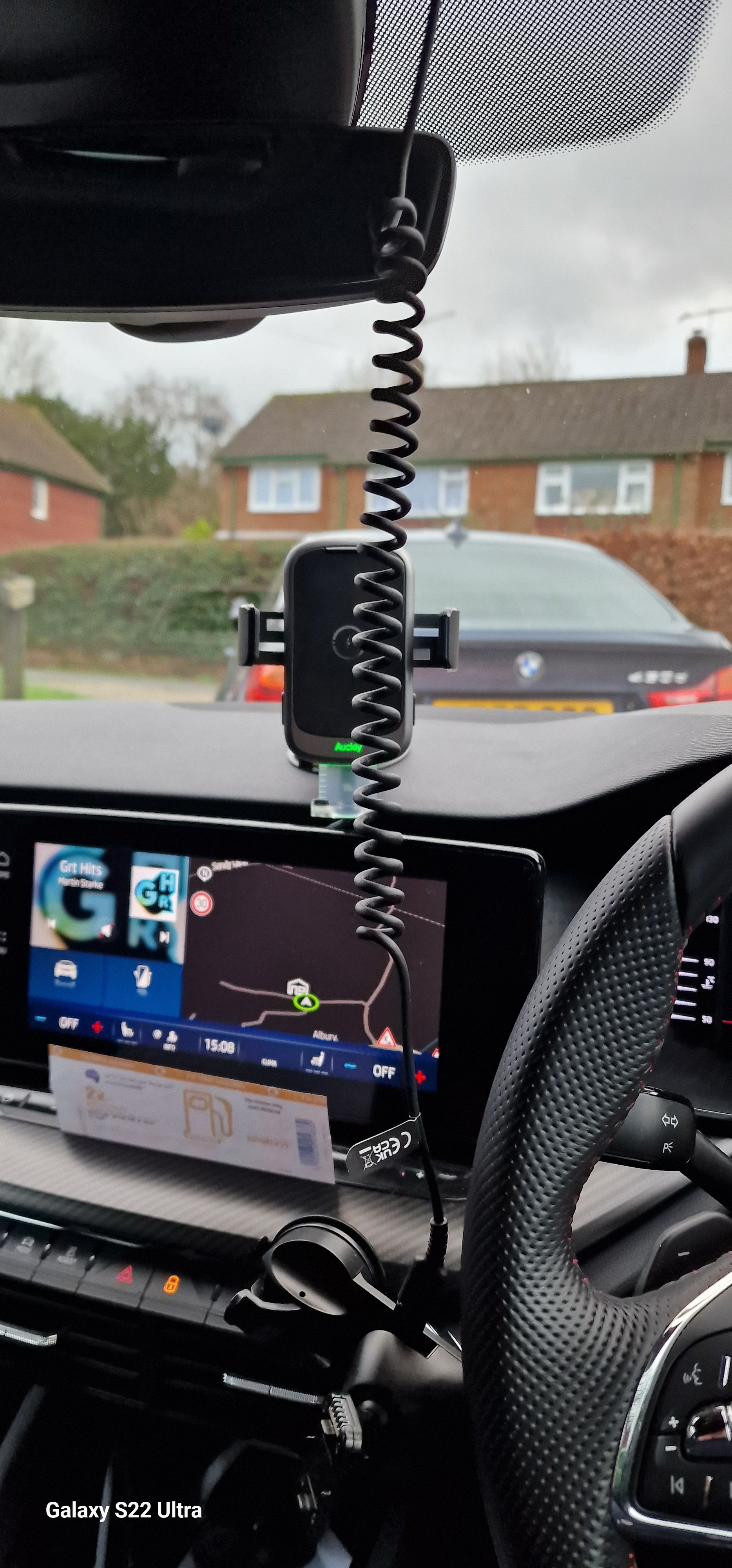

Like I said get coiled cable from AliExpress or Temu. You can find most things on those two. I have the same (GW622) dashcam.
Here's my wire, it cost about £6-7, from Temu.
A cheap coiled USB C to C cable and a £1,50-2 USB C to Mini USB adapter.
It's hanging down as I removed the dashcam to download it after a near miss with an a**ehole who decided to run a roundabout whilst holding his mobile phone texting! I suspect he's not going to be happy getting a NIP! 😈

I have a Garmin DC2 connected to the power socket with a 30cm USB C cable that has a 90 degree elbow.
The cable is tucked into the small gap between the windscreen and the mirror / camera housing so it is not visible.  The dashcam is then fitted on the passenger side and is hidden from the driver by the mirror.
