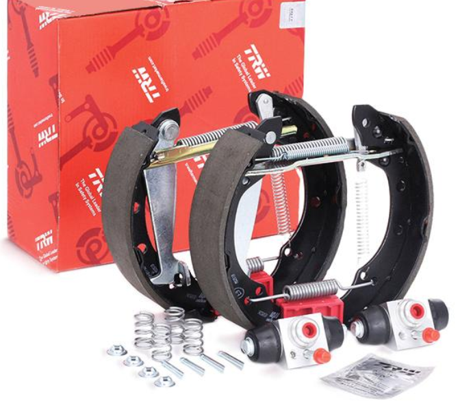

Afternoon - I'm after a favour and hope somebody can help. I have been reading through the threads for replacing brake shoes on the Fabia Mk1, and i just want to make sure that i am ordering the correct kit for our Fabia Mk1 1.2 HTP BME.
I've already ordered the plastic guides p/n 6N0609589, but not sure which pre-assembled kit to order. Can anybody point me to the correct kit? I only need to change the NSR.
I used TRW GSK1512
It comes with new wheel cylinders but if you don't want those they might do another kit without them.

Thanks! I only need to replace one pair of shoes on the NSR and i do need replace the cylinder, so i will contact them and check if they sell one side only.

On 06/11/2020 at 14:27, TMB said:
I used TRW GSK1512
Fitted the OSR brake shoes and cylinder this morning and so much easier to do the job after removing the hub - and yes i bought a new hub knut :-)
