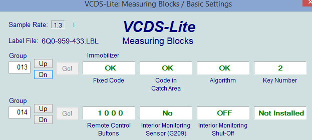

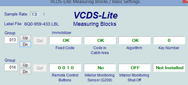

I have checked several things:
1º) If i check the 13 group and i press my old 2 button key it shows "ok ok ok 2" and if i do the same with my new key it shows "ok ok not ok 0".
     I do not know if this means something.
2º) If i check the 14 group with my old key(2 buttons) it shows a 1 for each button as long as i press the button.
     But if I check the same with the new key the 0 change into 1 only for a moment just for a moment no matter if i keep holding the button down and if I press the trunk button then the third zero change into a 1 but the same as the other 2 buttons, only for a little moment no matter if i keep holding.
I think you are right and my key is very cheap perhaps or maybe is not the right one, maybe someone could say me a good place to buy another one?

But my trunk button in group 13 shows "ok ok not ok 0" and yours "ok ok ok 0" so the algorithm is not okey  for me and i do not know what that means

Not sure what that means but this seems important in the context of the trunk button:
The module 46 isn't 'seeing' the sustained keypress for the trunk activation, so maybe the algorithm does not interpret that correctly as a result?  (Or interprets it as a non-sustained keypress, therefore not requiring action).
