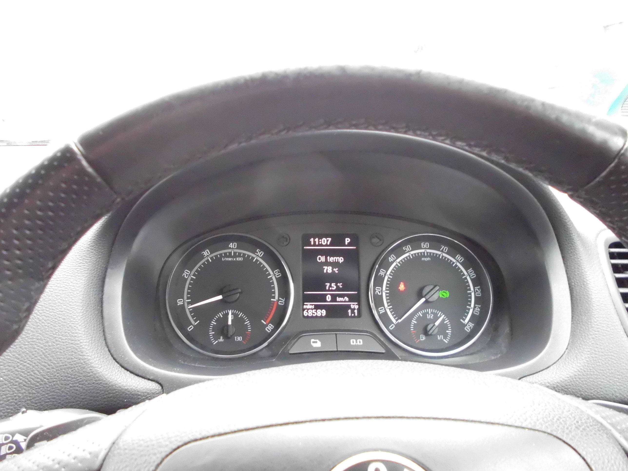

Hello,  my vRS coolant temperature is low, it barely reaches 60 degrees on a test run.  Both thermostats have been replaced but it is still the same.  The local mechanic wants to change the water pump next but wouldn't a failure of that mean running too hot ?  The coolant temp gauge seems accurate because the oil temp only reaches 60 degrees as well.  I am only driving the car at the moment for test drives after garage work.  I would be grateful for any advice, thanks.

Thanks for the answers, I'll try to add a few details.  The latest test drive was thirty miles in 8 degrees C, max water temp 62, put the heater on then it dropped to the stop, max oil temp 65.  I've had a mooch about,  perhaps the mechanic had changed the oil thermostat as well, I'll ask him tomorrow.  Would you be able to tell me what a CTS is ?

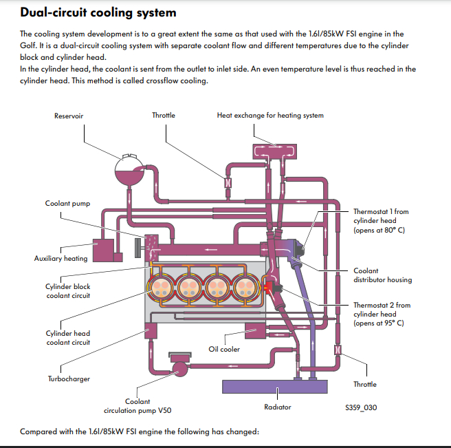

The SSP for the 132kW engine refers to a dual circuit cooling system on page 21 with two thermostats.
One circuit for the engine, one for the charge cooler, nothing to do with each other. We're talking about engine temperature here.
  • Sponsor
Two thermostats, so the mechanic wasn't making things up. May not have been barking up the right tree, but probably making honest attempts to fix.

The two circuits are said/shown to be for head and block. I'll post some snapshots tomorrow when on a big screen/keyboard.
