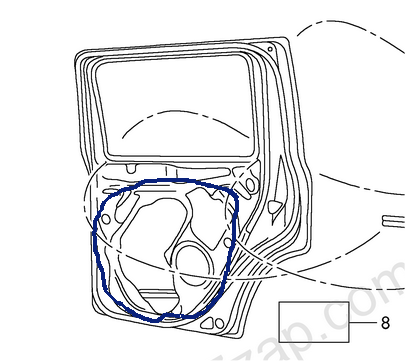

It is a plastic sheet that seals roughly the area in pic below inside the door card not the door outer seal.
Thanks, now I'm with you. I haven't had the door cards off to look inside - perhaps that will be next depending on the result of the newspaper test.
