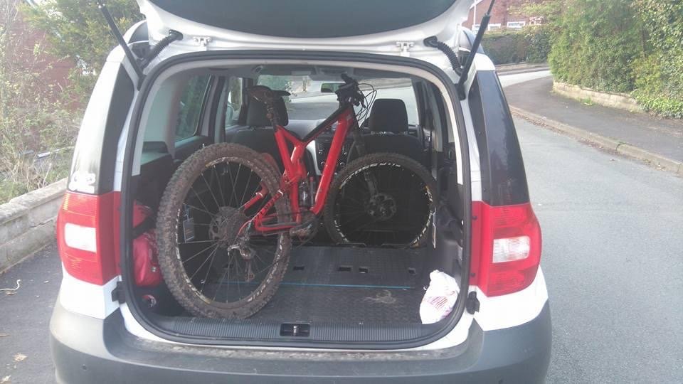

  3. Seats out I’ve had road bikes and mountain bikes in with wheels on. Front of n 1st drop the wheel turned into the foot well and rear to the opposite corner. My 29er enduro bike didn’t fit that way so I take the front wheel off and slide it back wheel 1st between the rear seats with the centre seat removed.
